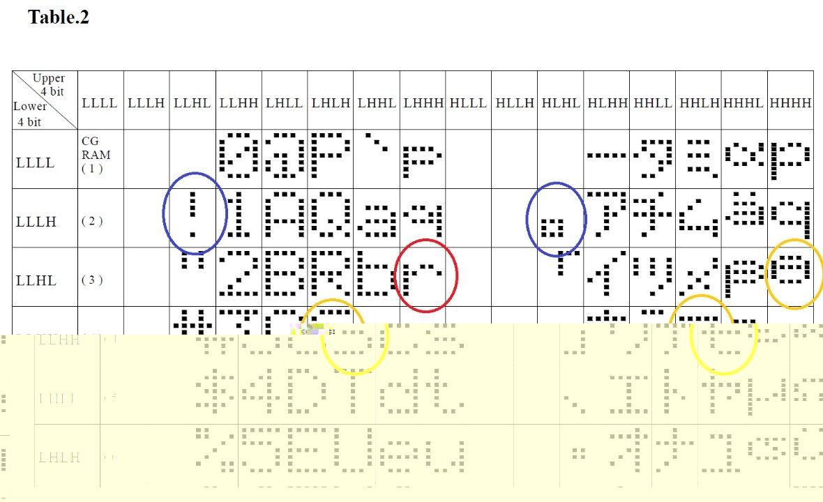

I have been using the WH0802A-YYH-JT display for a long while now without any issues (datasheet attached). But I have recently redesigned the PCB to make simpler use of the backlight. So in order to do this, I changed the display to the RC0802A1-LLR-JWVE (again attached), however, the characters are now displayed in Japanese...
The datasheets for both displays both say they incorporate English and Japanese characters. The ROM pattern for both displays ar the same (Table 2 on both datasheets).
When doing a comparison to the English and Japanese characters, it can be noted that the only difference I am seeing is that the first bit of the upper four bits seems to be displaying high rather than low. So the English characters corrolate perfectly with the Japanese ones
I have read another forum (https://www.newhavendisplay.com/NHD_for ... topic=65.0). I think the IC's used may be different using a slightly different speed. Question is how do I resolve this without using the 8bit data (as it means re-designing the PCB), and secondly, the code uses was using FC5. I have never had any luck being able to transfer the programs over from one version to another. So if possible a FC5 solution is preferable, if not I can look at redoing the program in FC8.

Re: LCD display showing Japanese Characters
Maybe the bit pattern is reversed on those displays is all I can come up with? Though this is a fairly serious error with the display if it is the case.
Have a go using this as your RawSend function. I've commented the line of code I changed. Note this will break normal working displays.
This is not something you can do in v8.
I'll be surprised if it works as that suggests there is something very off about the displays. Maybe they are known defects and being sold off on the cheap?
v5 and this will overwrite everything for you, print string, print ascii etc all use RawSend behind the scenes.Do you want me to change the F5 or the V8 RawSend .c file?
Then do I need to use the RawSend function on the LCD macro?
