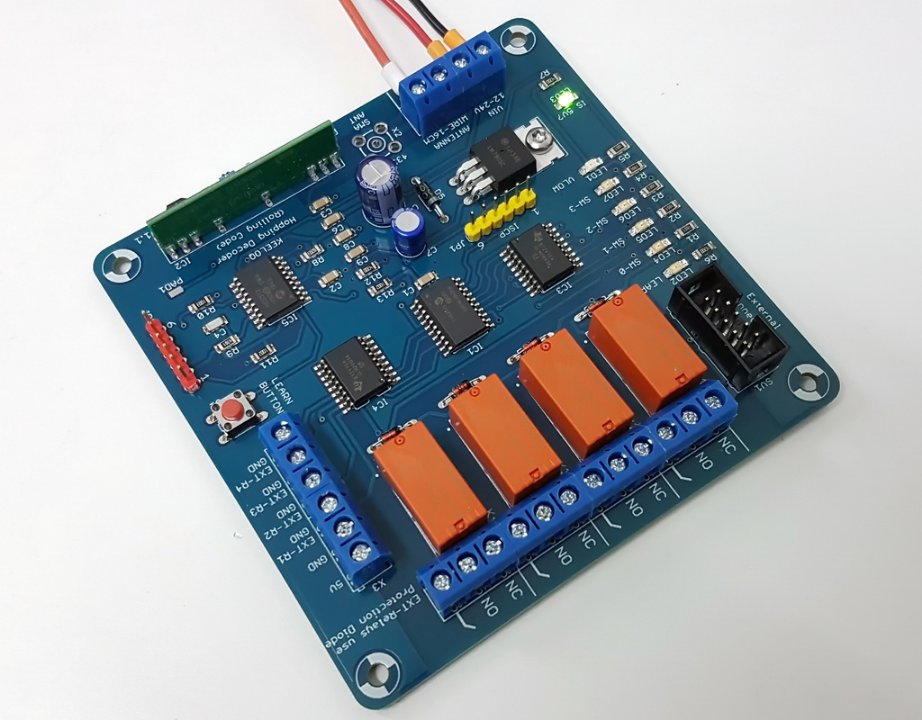

Attached a picture from the HCS512 Decoder PCB.

Hi frank,
Glad the Flowchart works ok.
Board looks good.
Out of curiosity, What PCB package did you use?

medelec35 wrote:Hi frank,
The PCB design software is Eagle 7.7. I’m not going higher because of the acquisition from CadSoft by Autodesk with their monthly abonnements. I hate this. For routing I use Electra Autorouter, very efficient and also no monthly abonnements. Greate tool to have.
