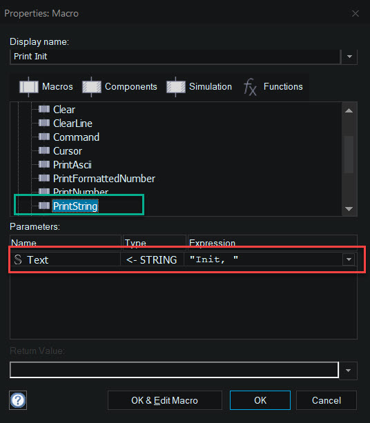

Re: Print Ascii for LCD Component Macro Hello World
Hi.
When using the printstring macro you need to enter the string and note it is a string of ASCII characters such as "12345" "ADGDE"
the macro expects a string and therefore what ever you enter in the macro as string example HELLO WORLD needs to be in double quotation marks to indicate it is a string so then you enter "HELLO WORLD"
in my example I have an string called Init so "Init" is entered in the parameter box
I hope h help you
