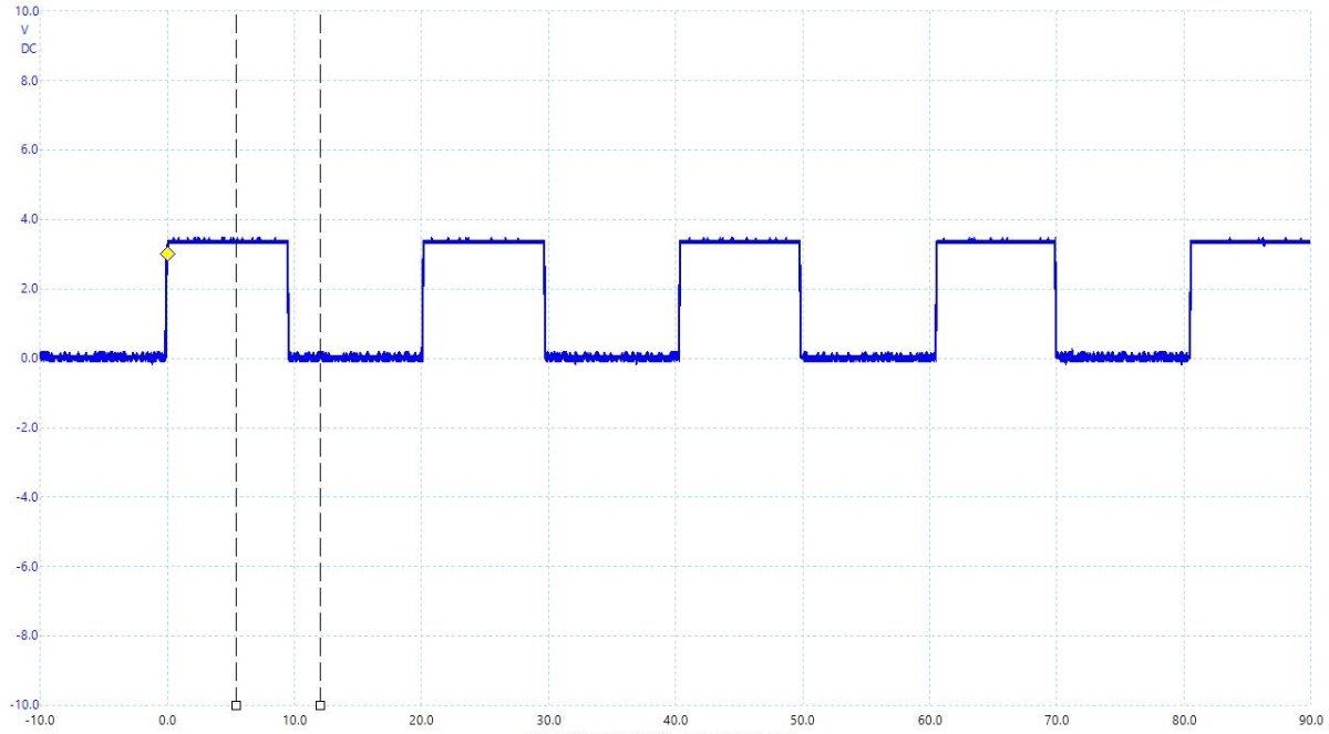

I have stripped the program back to bare basics, I now no longer even have the input pulse but still getting a strange output. FC program is attached and the output is below.

Re: IOC dilema
If you add a delay into the loop then does this change anything in terms of wierdness? Just looking at the CAL code for the ADC (pin C4 - ADC20) and it all seems to check out.
