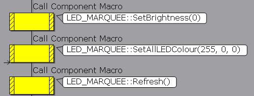

Many thanks for testing for me, glad the timing issue is now resolved. I might create a new PIC32 core timer component as this should be easy to do and quite useful.
Regarding the brightness, I've been using the new byte based brightness and this is working ok for me. When you say it's not working can you give an example. Note for the brightness to work you have to set the brightness level and then assign the colours to the LEDs and refresh. We do not scale any of the colour values already loaded in.
e.g. this would work.
SetBrightness(0.1)
SetAllColours(255,0,0)
Refresh
This would not work
SetBrightness(0.1)
Refresh
I've maybe spotted somethign with the floating point brightness function so I've hopefully solved this and pushed the new component to the update system.

Re: PIC32MZ + WS2812 Not Working
Hi Chad,
The SetBrightness does effect global brightness but you have to assign the colour values after setting the brightness.
I can't think of a better way around this without resorting to a secondary buffer which would be memory intensive or scaling values on the fly which would effect the strict timings required by the LEDs.

Hi Ben,
I understand now and thanks for clarifying this!
SetBrightness(0.1)
Refresh
This would not work
SetBrightness(0.1)
Refresh
Before moving to PIC32 and WS2811 we were on dsPIC33 and APA102 LEDs and always using the second way of doing this which was obiosuly wrong!
Cheers for this, much appreciated!

Only thing to note is that the following code doesn't seem to change the brightness of the LEDs on the output. Brigthness stays always at 1. Strange...
For now we are using a custom routine to change the brightness against the colour, easy to do.
Regards,
R
I've just had a look and it seems inverted.
0.0 = full brightness, 255 or 1.0 = Off.
I'll get this fixed ASAP.
Thanks for letting me know. The brightness issue should now be completely fixed in the latest component updates.
