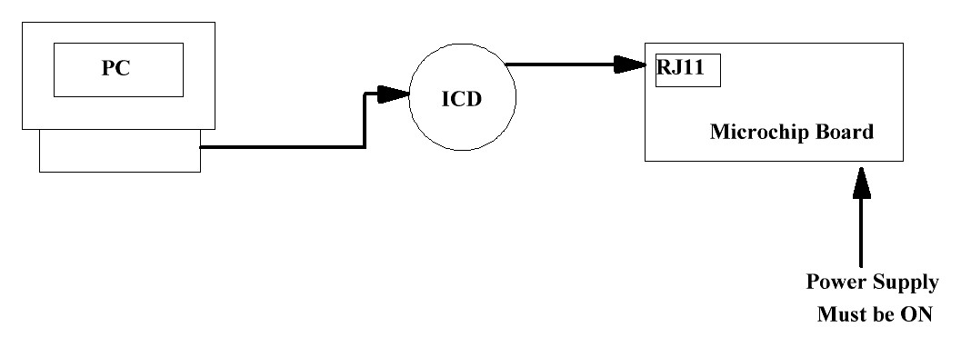

You can directly program from Flowcode
The following crude sketch show you the connections or the setup of your development system
ICD connect to RJ11 Connector on the Microchip board
The USB side of the ICD you must connect to your PC USB port and MPLABX must be installed as the drivers for the ICD is installed by MPLABX
The board must be powered by your Power supply either externally or over the USB

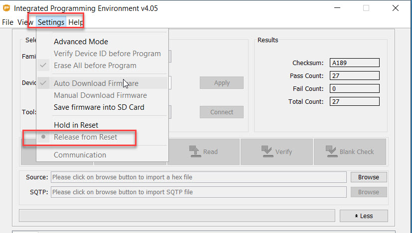

I have had moderate success with the MPLAB IPE but can't get the chip to respond despite the ICD4 connecting to the development board and down loading the hex to the chip
(1)I think your tool (ICD4) does not release the chip from reset after programming :D
In the IPE SW go to Settings and select release from Reset then do a program of the chip again and it will run

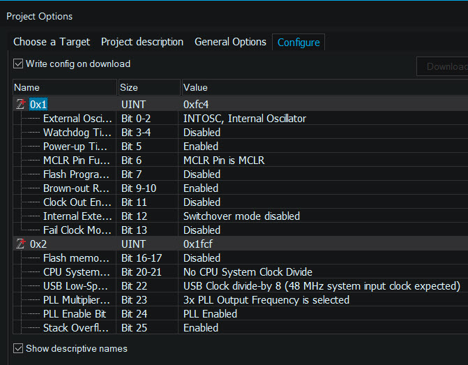

(2) Is your chip configuration set correctly this is done in build >>> project options >> configure

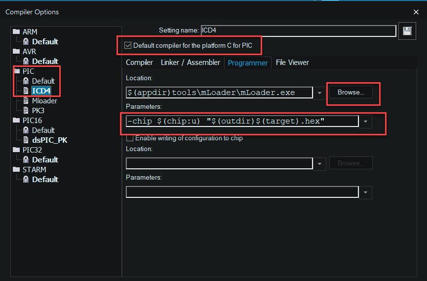

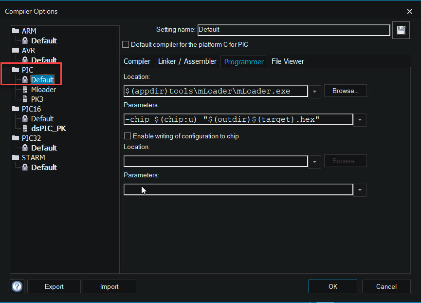

You then pointed me to the set up in Flowcode as being (Build ))Compiler Options ))Programmer ). On my version , on the LHS under Compiler Options I show: ARM
AVR
PIC
Default
PIC 8 Bit
PIC 16 Bit
and correspondingly the location becomes:
$ (appdir) tools\ mloader \mloader.exe
In other words there is no PK3 or indeed any other option.
Should I be overwriting what appears ie taking out PIC 8 Bit for PK3 or something else. This is what I mean about not knowing what it is I am doing when faced with 'Location' and a path or 'Parameters' and a string of characters which I don't appreciate the relevance of!
AVR
PIC
Default
PIC 8 Bit
PIC 16 Bit
You have to create a menu for your ICD4 and check the check box use as default and then set the paths but later we will use IPE directly for now

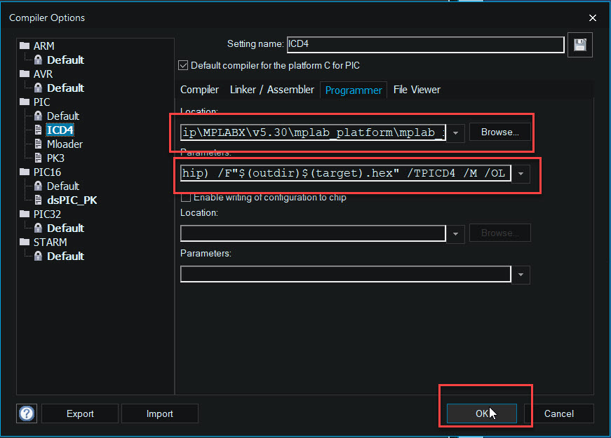

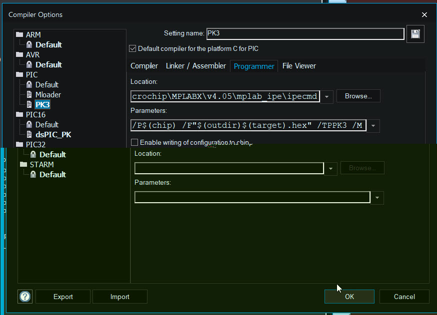

Just for your info the new MPLABX 5.30 has changed the location of the ipe it is now in a folder call MPLAB_Platforms and then IPE
the default path is
Location
C:\Program Files (x86)\Microchip\MPLABX\v5.30\mplab_platform\mplab_ipe\ipecmd.exe
Parameters:
/P$(chip) /F"$(outdir)$(target).hex" /TPICD4 /M /OL
This will be the settings for the programmer setup.
To set the paths do the following step by step as I show you here

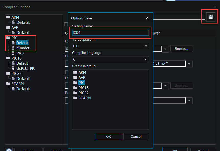

(1) go to build >> compiler options >> programmer ,On the LHS make sure you are set on PIC and default unchecked the use default check box
(2) Now select the disk menu icon on the RHS top next to default, a window will open enter ICD4 in the setting name and make sure the group box PIC is highlighted. Press the OK button at the bottom
(3)You should now see on the LHS PIC and your ICD4 ,Make sure to check the use as default check box.At this point in the location and parameter boxes are still the mloader shown,now go to browse next to location and Browse to the location for the ipecmd.exe as I showed above
next copy and paste the parameter strings as I showed above into the parameters
Your setup should look like this now press OK ,the window will close ,as a check just go to build >> compiler options >> programmer and the settings should be visible as before as the default ICD4 and you are ready to run program from FC8
Hope this helps

(2) it not running because the Oscillator is set incorrectly (if you upload the Flowchart and tell me the Chrystal value (Clock value)your board is using I will set it for you) ,again what MC board you are using then I can look at it myself for the info I need

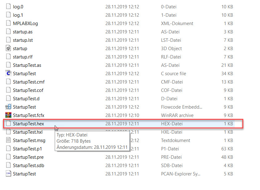

(1)Place this folder on your Hard disk and open the StartupTest.fc file from Flowcode by selecting open Project.
if you brows in this folder you will see the .hex file with the same project name.

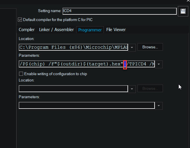

The delay in responding was as a result of having problems opening the RAR file - a new type of file to me!
Your program, ran from the IPE, executed correctly and the LEDS came on in sequence.
I then attempted to run your program using the compiler/programmer settings you advised me yesterday to set up (ICD4) after having created the space between .hex'' and /TPICD4. That program failed. I attach the screenshot showing the error.
But it is all progress!!

I am happy that the Chip runs with my basic setup file which you can use as a reference for your own FC charts.
The space you added in your paths is also progress as FC and the IPE find the hex file now no Hex file error report.

Brilliant! Just as you suggested, I hadn't closed the IPE ( I wasn't aware that it could be an issue) and that is what was giving rise to the problem.
I can really only say a big thank you for your perseverance and encouragement. I have been a bit slow but gradually things have been making more sense although there is a long way to go. The prime objective was to become familiar with PIC's and to avoid coding; that to be achieved through the use of Flowcode. Now that the access issue to the development board from Flowcode has been resolved I can get on and with the task in hand.
I have to say I wasn't expecting this degree of assistance nor in the friendly and understanding manner in which you have approached it. I do appreciate how much of your time I must have taken up with my problems and I can only say again very many thanks.
