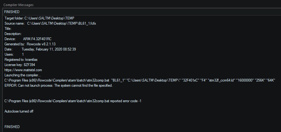

When trying to load a simple program to an E Blocks 2 BL0061-1 board the message attached appears each time.

Have you installed the STARM toolchain?

Yes the STARM toolchain has been installed

OK, and you can see installed files in the location listed in the screenshot? (C:\Program Files ....)
Next thought then is that it could be a Windows "short path" issue.
There have been a few forum postings on that topic, if you want to take a search? ... or I will try and pick some out
