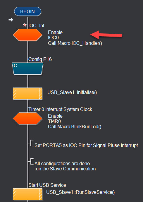

As you see here the normal configuration in FC.

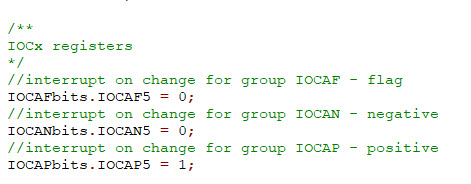

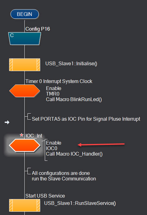

Then I moved the IOC interrupt to the top and do a C code setup just below it then the Interrupt fires correctrly ,I did not have time to check what FC use as configuration as the customer where standing with me in lab to take his fix with him
Example code

Hi Peter,
It looks like you have to read the PortA register after enabling the IOC and this should then arm the interrupt. I've experienced the very same problem on hardware here in the past couple of weeks.
I could potentially put this code into the interrupt enable icon code generation so that it simply just works. I'll make a note to investigate rolling this out but it's tricky to detect which pins are enabled and hence what code to generate. I could read all associated port registers as a hit it with a hammer type solution.
