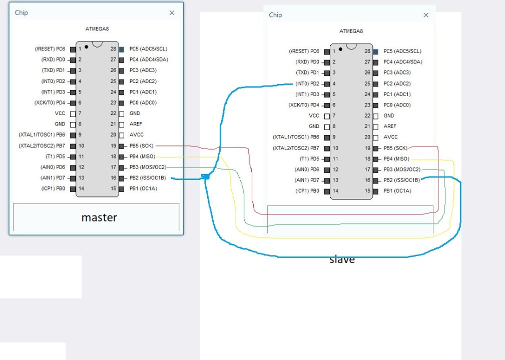

Can you provide a sketch of your connectivity?
Alternatively something like this
Master - Slave
Pin x (MOSI) - Pin x
Pin y (MISO) - Pin y
etc
etc
There may be an issue with connections as your previous traces did show as expected.
Master - Slave
etc
etc
gilanetugila
- Posts: 268
- Joined: Thu Jul 30, 2020 2:01 pm
- Has thanked: 7 times
- Been thanked: 1 time
Re: some problems with spi data transmission
Good evening! I'm not sure exactly, but it seems there was such a connection as in the attached picture. I just rewired the circuit a bit and tested other programs. If it is very necessary, I will test the programs that I sent you again, write to me.
- connection pin.jpg (82.9 KiB) Viewed 330635 times

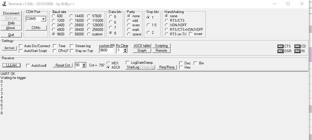

Good evening! one of my friends posted a video where he sends and receives data in the flowcode program, it didn't work from the beginning, then corrected some values and it worked. But it has no indicators. The orientation is that the program works only on waveforms .How data reception is determined-some number is sent there, and when it is received, +1 is added to it and sent by the "miso" output. Unfortunately, I couldn't redo it so that the number was displayed on the LCD screen.
- oscillograms.jpg (102.41 KiB) Viewed 330600 times

Good evening! and there is a program with positive clk impulses. The previous and this program have clk pulse back-edge synchronization.
- oscillograms.jpg (92.27 KiB) Viewed 330593 times

I have been reading up a bit. With regards to the Uno R3 which uses the 328p (which should be compatible with the 8') it has SS/CS on pin B2 and this cannot be remapped and is required by SPI to sync.
This pin however is part of Interrupt On Change (IOC) but is port based rather than pin. Also it can only be set to trigger on both edges.
So you could perhaps set up an IOC on Port B
In the ISR immediately have a decision testing $B.2
If B.2 doesn't = 0 then Exit
If $B.2 = 0 then in that branch perform your SPI Rx routine.
Now, if the CS/SS pin changes from high to low your SPI Rx routine will capture data. If it transitions from low to high, or any other Port B pin transistions, it will be ignored.
I have an Uno R3 somewhere so I'll test this when I get a chance.
PS
Of course you could create your own custom interrupt for B.2 as an alternative
PS

OK, the attached chart has been tested on an Uno R3 which uses a 328p chip and I believe that it is compatible with your Mega8. Note that due to issues using the GetChar and SendChar component Macros in FC v8, it is written in FC v10, and as mentioned earlier FC v10 is now totally free for hobby / non-commercial use and includes the Uno R3 and Mega328 as free chips.
The chart contains a SPI Slave component and also a UART which I use for testing. The UART is connected to my PC running a terminal program and I frequently use a UART during development, sending out debug info at key points.
The chart initialises, enables an interrupt then enters an endless loop toggling the output C3. Instead of toggling C3 in this loop you could have it do something more usefull.
Note that I used a PIC as the Master simply as it was in my programmer but you can use anything as long as the the SPI settings are correct. The master simply looped counting and transmitting a byte value.
Slave SPI connections are:-
MOSI = Port B3
MISO = Port B4
CLK = Port B5
CS/SS = Port B2 (note this idles High)
SPI settings for Master and slave are:-
Master SPI
Clock Phase = Leading Edge
Clock Polarity = Idle High
Sample Point = Middle
Slave SPI
Clock Phase = Trailing Edge
When the Master initiates communications it brings CS/SS Low, transmits the byte, then returns CS/SS to High.
The Slave has an IOC on Port B. This means any change on any pin on Port B will trigger an interrupt, so the first thing we do in the ISR is test to see if B2 (CS/SS pin) is Low. If not it exits.
When CS/SS is brought Low by the Master the Slave branches to the ISR and gets the incoming character. It then immediately sends out the incoming character on the UART befoe exiting. You could of course do anything you wish such as displaying the character or putting it into a Circular Buffer or Array. Choice is yours.
The screenshot below is from my PC connected to the Slave UART and you can see the incoming values being displayed.
MOSI = Port B3
MISO = Port B4
CLK = Port B5
Master SPI
Slave SPI
