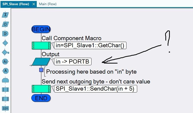

gilanetugila
- Posts: 268
- Joined: Thu Jul 30, 2020 2:01 pm
- Has thanked: 7 times
- Been thanked: 1 time
Re: some problems with spi data transmission
Thanks for the wiki link. But to be honest, nothing is clear! I never thought that the port value could take some byte number other than 0 and 1! And there, in the first example, a slave loop without anything (without any program code)-it is also unclear why this is done. The fact that I used an insert in the c language - I looked at it in the videos on SPI, I tried using standard program tools to do initialization and enable CS before and inside the subroutine. I can't tell if this spi module is working or not, an error just pops up. And when working in slave mode, no code is generated at all. You correctly noticed that you need to check, at least using virtual tools. I'll try it today, at least for master mode. Do you have the opportunity to explain how the highlighted icons work in the drawing of the program taken from the wiki. Or maybe it's somehow simpler and to make it clearer, you can do it?
- 2.JPG (45.14 KiB) Viewed 2543993 times
- 1.JPG (54.73 KiB) Viewed 2543993 times
- Posts: 786
- Has thanked: 187 times
- Been thanked: 205 times
Shopping is my least favourite activity, well unless it's for cars / geek toys / test equipment / beer etc
My phone isn't the best to reply with but I think there is some confusion. A single digital port (e.g. B0 / B1 / B2 etc) can only have the value of 1 or 0, however the entire port is 8-bits wide (assuming 8-bit micro and the port has 8-bits assigned) and can be referenced in it's entirety.
B7 B6 B5 B4 B3 B2 B1 B0
This equals in Binary
128 64 32 16 8 4 2 1
So an entire Port can input/output a range of values between 0 and 255 if 8-bits wide.
If you use the "Output" component you assign a value or a variable to either a single Bit, multiple bits using a Mask, or the entire Port.
So to set Port B7 to "1" I could do the following
Use the value "1" and set Single Bit (B7)
or use value "128" and set Port
Note though that setting 128 to entire Port will set B7 to "1" and set B6 to B0 as "0".
Similarly for Input. Assume Port B1 and B2 were high (a value of 1 on the pins) with the other pins low (0)
If I read single Bit B2, or single Bit B1 I would get the value of "1". However if I read the entire Port I would get the value 6.
I would first ensure I'm actually transmitting valid data before worrying about the receive, but in answer to your questions:
You have two charts within the program called Macros, Main and SPI_Slave. Main is generally where the bulk of the work is done with branches for specific tasks such as Interrupts etc.
The Initialise Macro's do all the hard work of configuring the chip to undertake whatever (SPI/RS232/Display/whatever) based on the component properties you entered.
The Interrupt on SSP configures the chip to react whenever an SPI transmission is received. It monitors the associated flag and branches to a predefined Macro if set. In this case SPI_Slave (note that not all chips have the ability to interrupt on SSP). Whenever an incoming message arrives it will automatically jump to the SPI_Slave to process then return to Main.
The Loop is an endless loop (in this case doing nothing) used to keep the chip circling doing something until an Interrupt occurs, in which case it then branches to the assigned Macro. You could have it do whatever you wanted instead. It could display a value, or read a sensor, anything really. Point being the Main macro is busy doing something else and only branches when the interrupt occurs.
When the Interrupt occurs we branch to the SPI_Slave Macro, because the interrupt is set for SSP it only branches upon receipt of a transmission so we know we have something to fetch.
We use the GetChar macro to get the value and we assign it to the variable "in"
Then we output the binary value of "in" as an 8-bit value to the entire Port B (e.g. 10010110 or 11001101 etc) with Port B7 being the MSB and B0 the LSB.
Next (for reasons not known but assume as a test) we transmit the value of "in"+5 back out on the SPI interface.
Hope this helps.

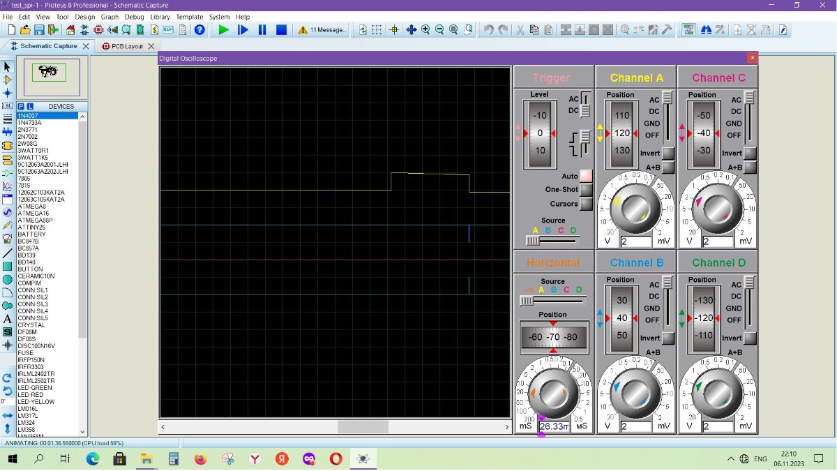

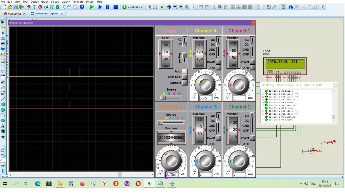

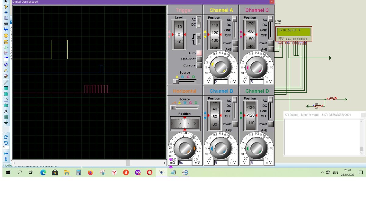

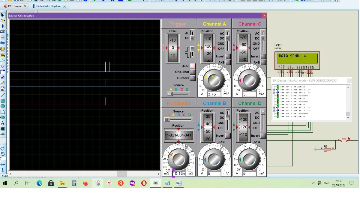

gilanetugila
- Posts: 268

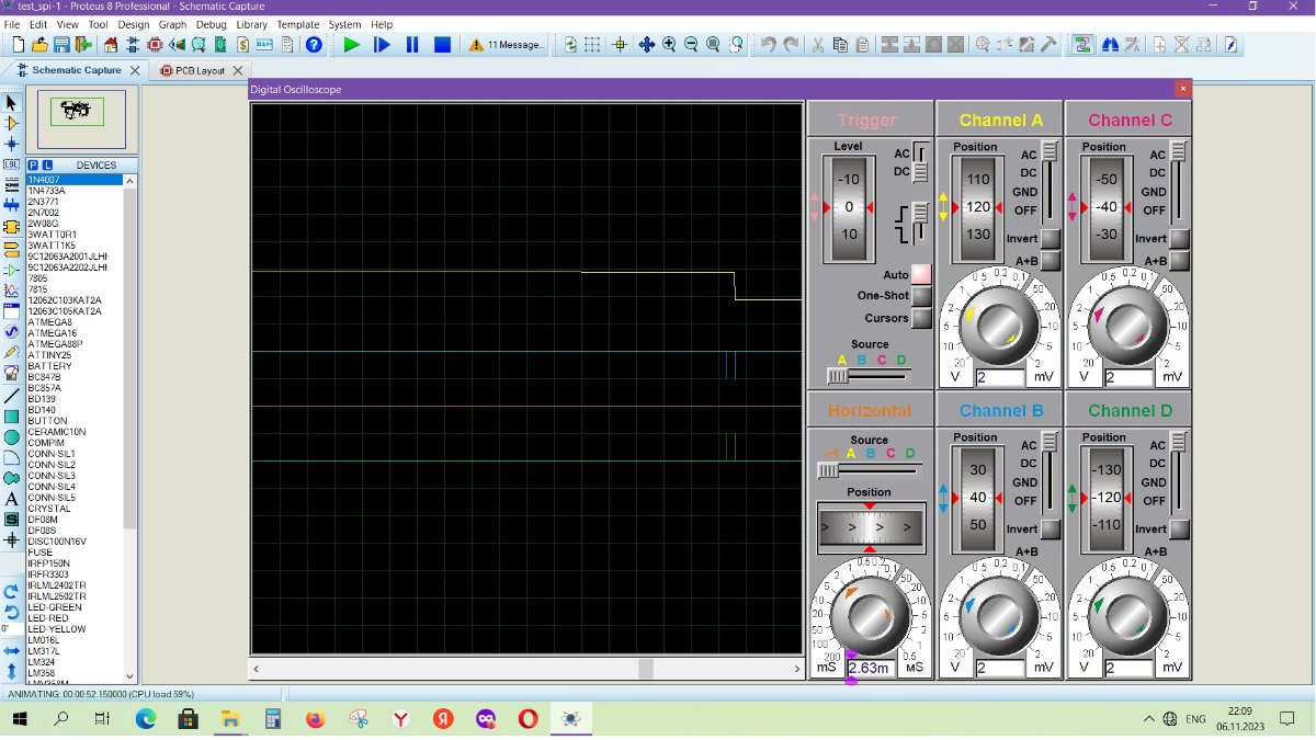

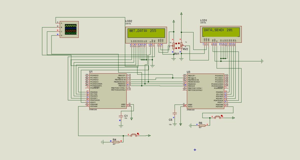

I get it, thanks. I just haven't come across such a representation before. There was once an idea to program a variable with binary code with small switches, but then I abandoned this idea, since there were too many variables, and there was not enough place to cram it all in. Therefore, I decided to try to do this using spi. So we managed to make an electronic simulation and look at it with a virtual oscilloscope. Unfortunately, the view differs from the theoretical one-there are shifts in the graphs, but this is most likely due to delays and restarting the SS bus. I tried to send the number 4 at a frequency of 8 MHz and 1 mhz and the number 201 at a frequency of 8 mhz. I was able to examine the graphs at a frequency of 8 mhz in more detail.It looks like spi is working! but for some reason, when sending the number 4, the polarity of the signal is positive, and when sending the number 201, the polarity of the signal is negative. I will be able to check the operation of spi in slave mode on Monday after 16 o'clock. I have to go to work tomorrow.
- 8MGr,yellou-SS,blue-MOSI,red-SCK,send_201.jpg (150.96 KiB) Viewed 2543984 times
- 8MGr,yellou-SS,blue-MOSI,red-SCK,send_4.jpg (121.54 KiB) Viewed 2543984 times
- 1MGr,yellou-SS,blue-MOSI,red-SCK,send_4.jpg (142.43 KiB) Viewed 2543984 times
gilanetugila
- Posts: 268

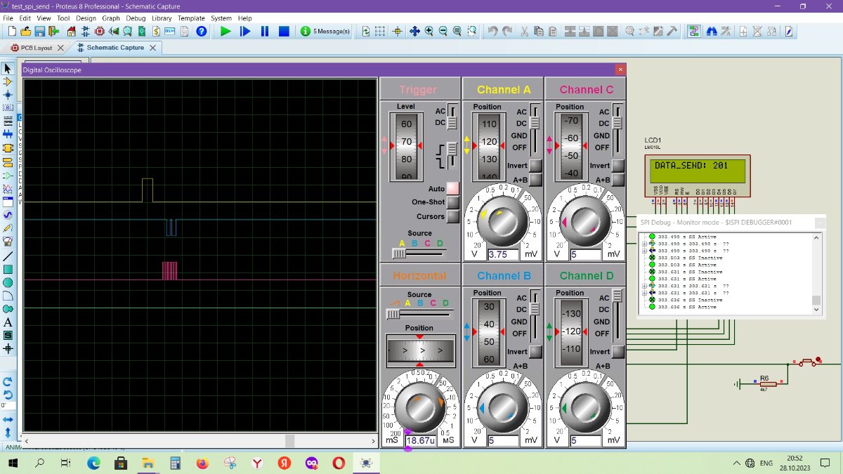

Slightly changed the program -added delays and restart of the CS bus (according to your recommendations) and added lcd1602 for clarity.
- test_send_SPI.fcfx
- (13.46 KiB) Downloaded 59110 times
- 8MGr,yellou-SS,blue-MOSI,red-SCK,send_201_2.jpg (156.51 KiB) Viewed 2543984 times
- Posts: 786
I see you seem to be simulating in Proteus. That's not something I'm over familiar with, but note that when simulating any microcontroller in any software you add in an extra level of "pain"
Many other factors now add their toll to what you hope to see, so just because something doesn't seem to work in your simulation, that doesn't always necessarily mean it doesn't work for real.

Good day! Yes, I regularly come across the fact that if something works in the proteus program does not mean that it will work in a real project and if the project works on a real board, it does not mean that it will work in the proteus program.

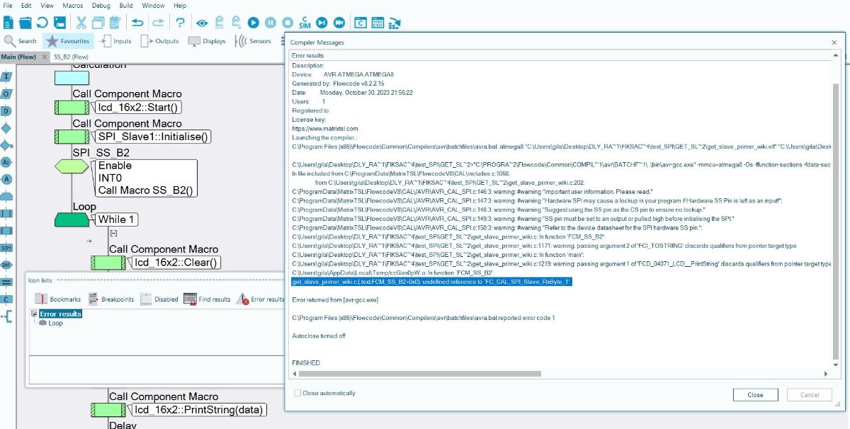

gilanetugila
- Posts: 268

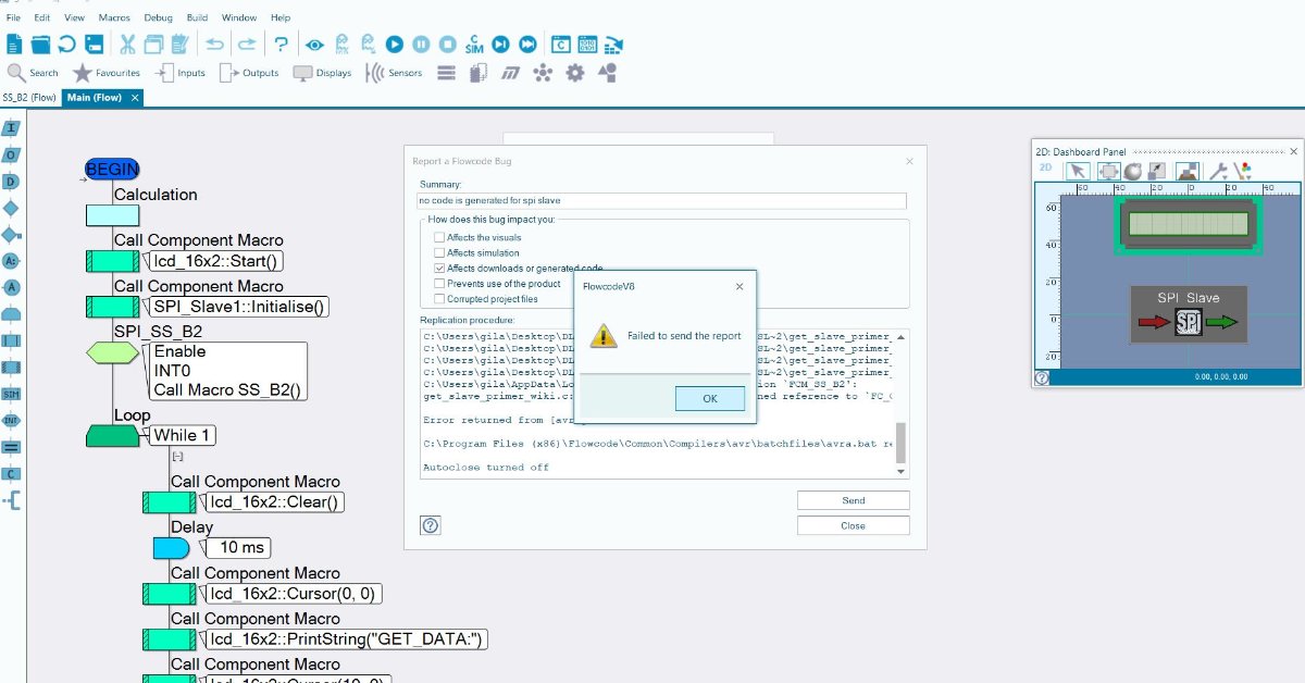

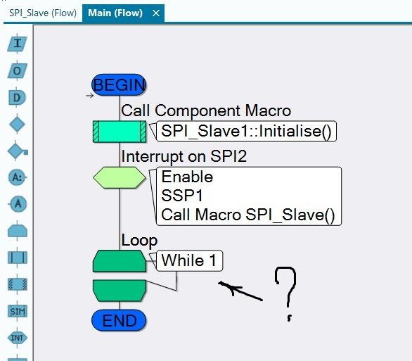

Good day! I tried to make a program for the slave spi mode in flowcode, as in the lesson on the wiki site, an error pops up when trying to broadcast the program. It seems that this module does not work in the program or it does not exist. And here it doesn't matter how I do the project on a real board or in a simulation program. In both cases, a program is needed there, and it does not compile. Can you take a look at what the problem is.? I tried to report the error through the "help" program menu, but it does not work for me and does not send messages.
- SPI_error_slave.JPG (140.8 KiB) Viewed 2543920 times
- get_slave_primer_wiki.msg.txt
- (3 KiB) Downloaded 59207 times
- get_slave_primer_wiki.fcfx
- (11.58 KiB) Downloaded 59150 times
- Posts: 786
Busy over the next couple of days so my replies may be limited.
I'm not very familiar with your chip, however I downloaded your chart and it seems that it should work providing the interrupt is called at the correct time. Without knowing what it is connected to and how that relates to an incoming SPI transmission I can't really comment regarding that.
Your chart did compile without errors for me though. Have you updated all components?

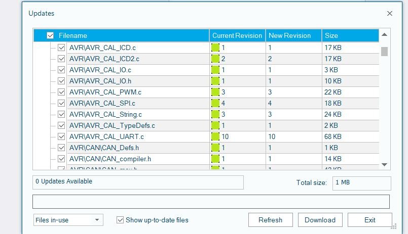

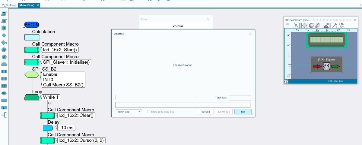

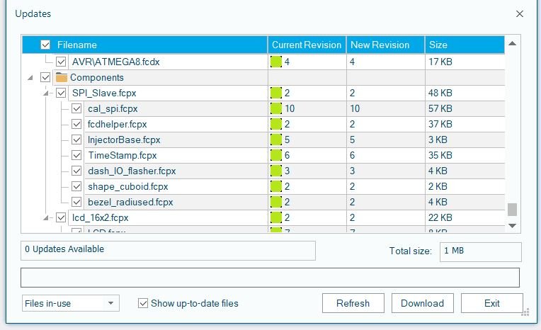

Thank you for paying a little attention to me and my program! Yes, I have been updated recently, maybe 1-2 weeks, a lot of updates have come. But I haven't seen any updates for the spi interface. After the update, for some reason, the connection disappeared-I can't ask for help or try to download more updates.
- connection error.JPG (68.76 KiB) Viewed 2543911 times
- failed to send the report.JPG (109.84 KiB) Viewed 2543911 times

Guessing you are using an "educational" license? I am not familiar with that version of Flowcode so can't help regarding the messages you are seeing. It looks like it has features different to the other versions.
Whilst I have FC v5 - v10 on my machine, I only have a license for your chip in v9 onwards, and as mentioned it does compile OK for me using v10, so the code itself is valid (albeit not doing as you wish). One thing to note though is that your are using INT0 to call your macro, but you don't document what is connected to the INT0 pin or what will trigger the interrupt telling the chip to look for an incoming signal.
The CS pin is normally used as Chip Select, used to inform the unique slave device that the transmission is for it. The Master device CS would connect to the Slave CS. Having only used SPI as Master, I don't yet know if the FC Slave Component monitors the pin automatically or if you need to include further code to detect.The WiKi examples all use a SSP interrupt which not all chips have....

Good morning! I have a professional license for the flowcode program. Today I edited the antivirus settings, the flowcode program website page appeared on the primary page. I understand that the connection with the site has been restored. I tried to update again, but nothing else came. I created a new program for spi slave using the example from the wiki site, but the example came out somewhat clumsy. As you correctly noticed, the ss pin is used there for interrupting. For atmega 8, I did not find such an option and decided to use one of the pins for an external interrupt INT0 or INT1. Thanks to your letter, I realized that I did not correctly write a program in which an interrupt should be used. There was another option to create an interrupt yourself, but you need to write code. What I can't do. For this reason, I would like to know about the possibility of using an interrupt in the case of spi slave based on the capabilities of the flowcode program, without inserts in the C language, if possible.And even if the flowcode program is made incorrectly, it is still obliged to write the code in C, just the device will not work. And in my case, she doesn't write in C. Maybe you can compare the code of your atmega8 spi slave element with my element from the program I sent you. Or did you not rewrite it, but immediately downloaded and started the broadcast in the c code.?Maybe you have a connection with the technical support of the flowcode program and they can give you some useful advice.

Just heading out.
AV.... many posts regarding issues with such, although not so many now. It can really screw things up. Glad to hear you have it resolved.
I didn't rewrite, I just downloaded your code which compiled to both C and Hex without any issue. When you update, remember to check "full database" instead of just "files in use" to ensure everything is up to date.
I'm not a programmer, I'm a Flowcoder so my "C" isn't too great and if I did write code I'd strongly advise it be checked before use
The datasheet for the chip is quite helpful though, explaining which flags get set etc.
I'll try and have a play with SPI Slave, but it probably won't be until later in the week.
Just heading out.
gilanetugila
- Posts: 268
Good afternoon! I recently looked at the updates that I downloaded earlier, there were updates for the spi bus and for the spi slave. But something went wrong probably. Does the spi slave module necessarily need an interrupt to work? Or if there is no interruption, suppose the slave module instead of some values of the variable a (in my example) will receive a =0 and it will overwrite the previously downloaded values a>0 in the buffer? I will wait well, maybe you will get something by receiving and transmitting data from atmega 8 over the spi bus.
- обновление spi1.JPG (62.51 KiB) Viewed 2543890 times
- обновление spi.JPG (68.83 KiB) Viewed 2543890 times

gilanetugila
- Posts: 268
Good evening! And that it allows you to see what is happening on each pin or decrypts the signal, let's say you sent the number 5 and it recognizes it, or will it be graphs in the form of alternating logical zeros and ones? In the attached files I send an example of which I wrote earlier.
- test_send_SPI_3.hex
- (4.2 KiB) Downloaded 59061 times
- get_spi_master.fcfx
- (12.09 KiB) Downloaded 59135 times
- test_send_SPI_3.fcfx
- (12.82 KiB) Downloaded 59176 times
gilanetugila
- Posts: 268
- 91.jpg (151.5 KiB) Viewed 2543728 times
- 912.JPG (69.54 KiB) Viewed 2543728 times
- get_spi_master.hex
- (4.17 KiB) Downloaded 59121 times
gilanetugila
- Posts: 268
- 9.jpg (150.47 KiB) Viewed 2543728 times
- Posts: 786
Whilst it is good you are getting traces I still think you have issues with CS/SS pin. I would expect it to idle high only going low for the duration of transmission, and as I mentioned earlier certain Slaves won't actually do anything with the incoming data until the pin returns to high.
Yes, even the cheapo logic analysers will decode the signals and will display whatever value(s) it sees. They will typically include UART / SPI / i2c 1-wire etc capabilities and if working with hardware they are invaluable.
I hope to check on hardware later in the week.
