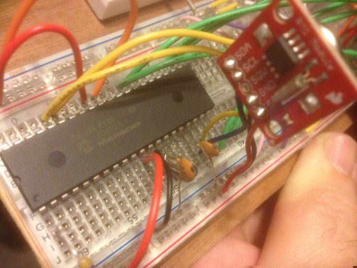

Hi Enamul,
I can't see anything wrong with the rtc connection , I have just put the pull up resistors in but still the same.
I am uploading some pics
thanks

Hi stuart,
Can you just test your slave module like the one you have posted before..
(88.05 KiB) Downloaded 4166 times

Ok,
I will put the rtc module back on that breadboard and try it
thanks

Re: RTC for Miac(Part One)
Post by acestu »
Success at last RTC module 1 wire in wrong pin....

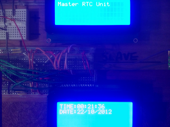

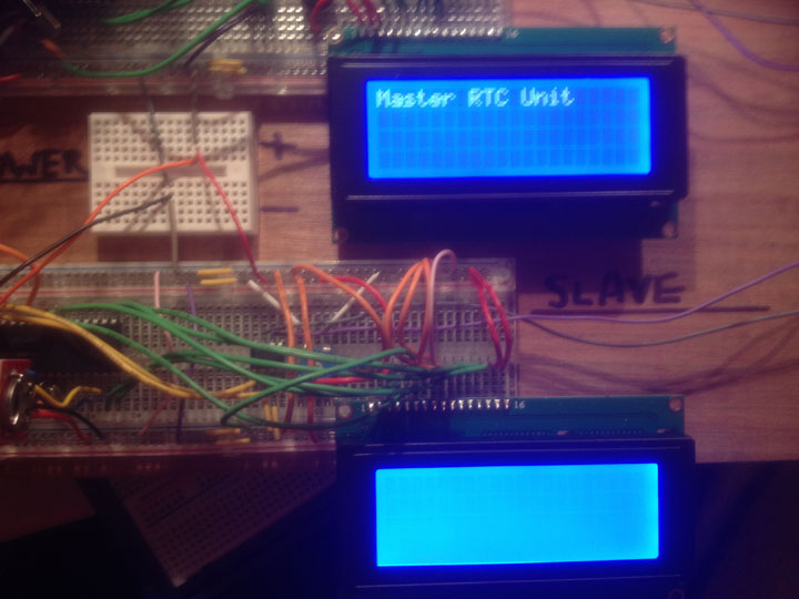

Post by acestu »
The Canbus is all connected up but the Master still says "Master RTC Unit"
Do the unused terminals on the MCP2551 need to be grounded ?
Also I have 100 ohm resisters on the Canbus thats what I used on the other unit

Post by Enamul »
You have tested CAN transmission earlier between Master and slave using LM35Dz as far I can remember..connection of CAN bus should be same as that..only addition is RTC module in slave which is working fine now.
OK, I have checked all my connections and found both mcp chips pins 5 to 8 back to front, I changed them and now it is sending info and returning info
Last time you did so..can you please check now MCP 2551 wiring and way it positioned.

Post by acestu »
As far as I can see Enamul, I have the Can bus set up the same as last time, I am enclosing a pic
thanks

Post by acestu »
Should the Tx and Rx of the mcp chip be connected to the 4580 via 220 ohm resisters ?

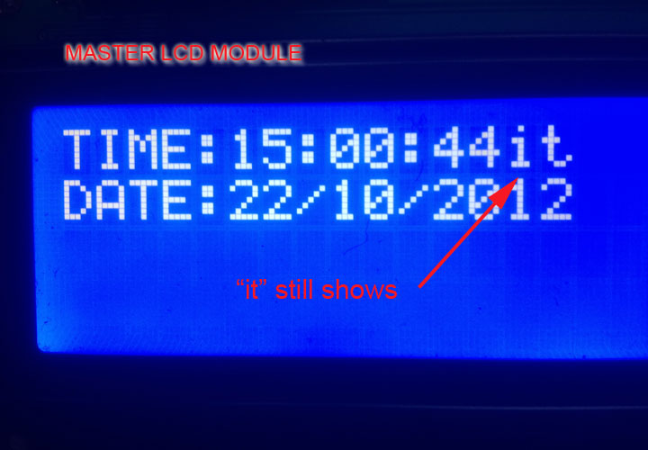

Post by acestu »
OK Enamul, I grounded pin 8 on both mcp chips and now I have date / time on both units, however I still see the "it" where "Master RTC Unit" was
thanks

Post by Enamul »
Sorry I was feeling so sleepy that went to bed..
That doesn't make too much difference.
It should be in the diagram I have posted earlier. PIN 8 must be grounded. That's great that you can see time in both unit.
I don't realize what you mean here.

Post by acestu »
Hi Enamul,
Yes I think all it is, the words "Master RTC Unit" that are on the master unit are not cleared when the date and time start so that the last letters ie "it" are still visible on the screen, that's all I meant. I think if I shorten it to "Master RTC" in the code you should no longer see it.

Post by Enamul »
Don't worry..It's pretty easy problem. I will correct code when I will back home. Great work. Well done :)
Now we are ready for MIAC

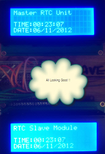

Has thanked: 783 times
Been thanked: 223 times
Post by acestu »
Hi Enamul, that has done the job
Acestu
