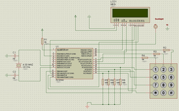

Hi Martin,
Here is the circuit diagram, It's not very big because the upload size is only 256k...

Picture is too small to check circuit is ok.
Posts: 9521
Has thanked: 2585 times
Been thanked: 3815 times
Re: Please Help with Codelock
From what I can make out of your circuit, the connections to LCD look wrong.
The microcontroller has to be connected from D4 to D7 of LCD.
R/W should be grounded.
Also what about a pot connected for contrast adjustment?
If I was you I would look a the data sheet for your LCD, and make sure it's connected in 4bit mode.
If contrast is ok and power is 1st connected and no data is present at the data pins, then you should see a row of black squares.

As stated in previous post, you will need to connect contrast circuit up (usually a pot connected between +5V and 0V. centre wiper connected to contrast of LCD)
Also are your data lines connected between D4 and D7 of LCD + R/W of LCD connected to ground?
It looks like its floating on the circuit you posted.
So my guess is you have a hardware issue.

I am a bit confused now, the LCD connections in flowcode are Data 1 to Data 4 also Enable and RS, but you say that the LCD should be connected to Data 4 to Data 7 , is this right ?

acestu wrote:Hi Martin,
Stuart
Yes that's correct. I know its confusing, but in 4bit mode the 4 upper bits are used on the LCD which is D4 to D7.
In Flowcode its just the four data lines. so labelled Data1 to Data4
Take a look at the data sheet of LCD that @MM sell:
http://www.matrixmultimedia.com/datashe ... 5-30-3.pdf
That should show you the correct connections.

What I would do is connect common (pin9)of ULM2003a to the +ve supply e.g. +12V. Pin 8 connects to 0V
Since these are open collectors, they will be sinking the load, so one end of each relay coil is connected to same + supply as common also.
The other end of the relay coils are connected to the outputs of of ULM2003a (pins 10 to 16).
E.g. ch1 output of ULM2003a is pin 16, and ch2 o/p is pin 15, so you can connect one end of relay1 to pin16 and the other to pin15
The i/p to ULM2003a (ch1 is pin1,ch2 is pin2 can connect directly to the o/p of microcontroller.
Briefly when the i/p to ch1 is high, the o/p goes low so the relay is pulled on.
Hope this is helpful.
Martin .
dazz
Posts: 1314
Joined: Sun Jan 15, 2012 3:15 pm
Has thanked: 474 times
Been thanked: 458 times
Post by dazz »
just to add to martins post, what i would do as you want it on a board, is tie all the unused inputs to the ULM to unused pins on your pic and bring then to a connector on your pcb, as it wont cost anything and it also give ready made spare expansion if you want to add to your project in future
hth
