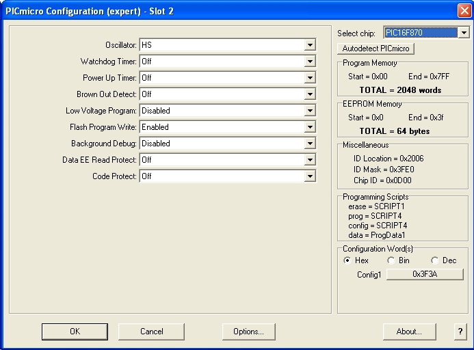

I have a Pic16F870 that I am going to use, also I am posting a screen grab of my chip properties to see if you think they are right if you don't mind..
Stuart

looks correct, but It depends on the oscillator frequency you are going to use. If below 4MHz then select XT instead of HS
I don't believe 16F870 has an internal oscillator, so you will need a resonator (probably best way to go) or a crystal with the two matching caps.
If you want a chip that has same number of pins but a precision internal oscillator and two PWM channels then 18F883 is a good choice.

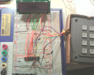

I have just built the circuit on a breadboard and guess what ?, yes the LCD backlight works, unfortunately that's all.
I don't know whats gone wrong but it should keep me busy, I think there is something that I am missing on all my pic circuits because none of them have worked yet...
Cheers
Stuart
Cheers
Stuart

If you post the flowchart you used, since you would have changed it for your new target device.
Also if you could post a full circuit diagram I can take a look at it for you.
I am assuming even with back light on you get no characters displaying on LCD?
How long does back light stay on for after pressing a Key?

If you are using a 4MHz crystal, then you need to change target speed from 19660800Hz to 4000000Hz
You don't really need to have Flash program write enabled either, since you are not using using software to write to flash, only using a programmer.
Good thing about 16F883 is the internal oscillator is precise enough to drive LCD at 4 or 8MHz.
