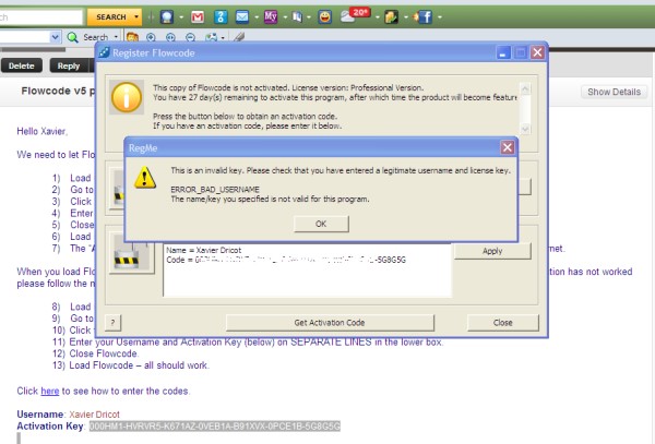

I see your issue now, you have the student version and have purchased an upgrade to professional, yes you can use the same installation, i will email you instructions on how to upgrade your install.

Hi DavidA
You got it that's what's been going on all this time but no one has yet given me the right info for this up grade. Sure hope that you will be able to give it to me so that I can get rid of this very irritating little box saying you have 27 day's left to register :lol:

Hello Xavier,
Please try entering you code without the 'Name=' and 'Code=' parts
so in the box it looks like this :
Xavier D..
XXXXX-XXXXX-XXXXX-XXXXX...
instead of
Name= Xavier D..
Code= XXXXX-XXXXX-XXXXX-XXXXX...

Hi DavidA
:cry: Well this is still a no go.

Post by Xavier »
:D Thank you so much DavidA you have solved my activation problem.
