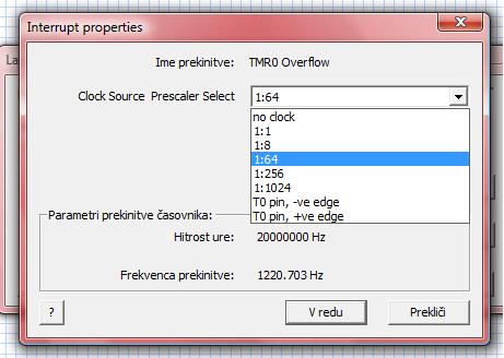

Thanks for the information. I write code for AVR ATMEGA32.
I have a problem with sharing frequency. I can not share the frequency 20MHz clock with 1:4.
The figure below
What should I do?
The figure below
What should I do?

Ok..I see the TMR0 issue. I can sort that if you post the FCv4 AVR code when it is finished. I have to tune TMR0 initial value to make it working.
It is same as last c code I posted only RH_Byte2 is in place of RH_Byte1.One more question.My mistake, picture number 12 and 13 is OK.I have a question for Figure 10, calculation box. Missing C code.

I can explain you how I have calculated that for 20MHz. You can find your own.
For AVR, I think the instruction cycle 0.05 us. so the delay I am looking for using TMR0 is 204.8 us. so clock is defining pre-scaler..like 1:64 for me at 20MHz.
204.8/(0.05 * 64)=64..so 64 increment should cause overflow of TMR0. We know TMR0 overflows at 256..so 256-64=192 should be initial value at TMR0 register(TCNT0 in AVR). That's it. so you can choose your clock and right pre-scaler and right initial value.
