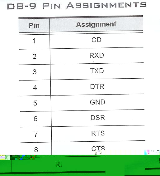

Re: URGENT help on PIC16F1827
is this what I need.
It looks as if the USB is just selecting leads to the PIC I guess.
On the product I purchased here is the DB9 break down ?
Can I not just use a female adapter and pick off the leads we need ?
John
John

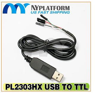

The LIGHT just went on...... There is a chip inside the USB ???
http://www.elecfreaks.com/store/pl2303h ... apl9andi70
Is this what we need ??
John
John
- Posts: 9521
- Has thanked: 2585 times
- Been thanked: 3815 times
Correct There is a chip with the USB Plug that converts the +5 and 0V to USB.JLeith wrote:The LIGHT just went on...... There is a chip inside the USB ???
Yes, That's exactly what you need.

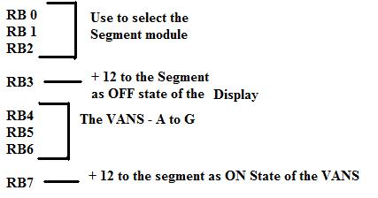

Won't we need the live PIC function to see the messages when the Scoreboard is running ?
Martin will I have an error when we go to do this that I'm using the RB6 & RB7 as controls for the scoreboard and RB 6 is the CLK and RB 7 is the DATA ?
I guess we can't use the RA pins for collecting the errors ?
Here is the snap shot of the RB pins
Will we be able to see what is happening with the PIC is the RB is doing double duty ?
John
Option 2 is one that I use to program the PIC.
I use the PICKIT 2 and flowcode to program the PIC.
PIN 1 - VPP (MCLR)
PIN 2 - VDD ( +5 )
PIN 3 - VSS (GRD )
PIN 4 - DAT ( RB13 )
PIN 5 - CLK ( PIN 12 )
For the programming I tried to use a RJ11 mounted on my PIC PCB but that failed.
I worked with Microchip support and when all was done I had to use a breadboard to connect the PICKIT 2 and program the PIC.
It had something to do with lead length for the PICKIT 2 and the PIC when it was connected thru the RJ11.
Martin I will add a 4 PIN (100mil pins) to my PIC PCB so I can connect the USB TTL device.
John
- RB state.jpg (15.08 KiB) Viewed 24957 times
- Posts: 9521
If your already using programming pins to control relays etc. then best to connect to a pin thats not in use.
Yes you can use any of the RA pins so long as they work as an output and nor open collector (unless have a pull-up resistor connected).
For example. All you need is an additional header pin connected to RA0
Then your TTL to USB will connect between GND and RA0.

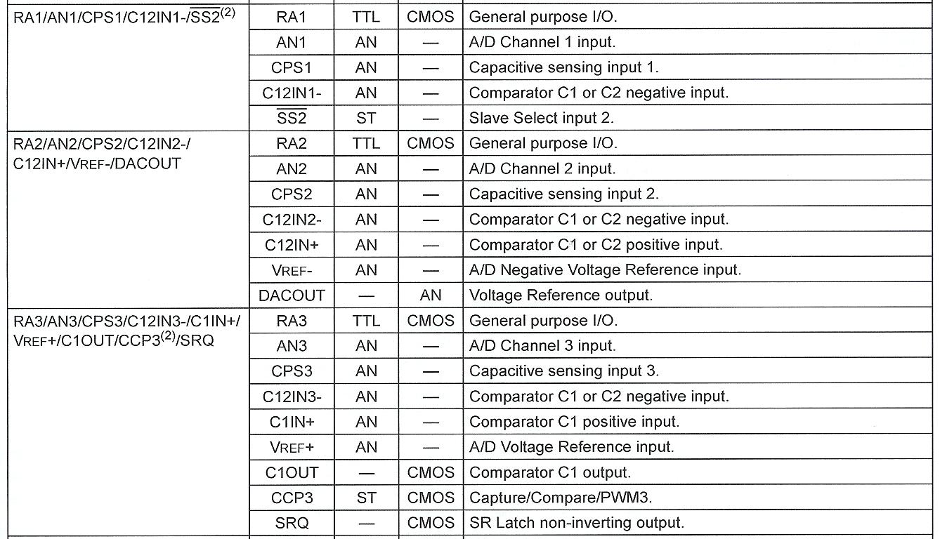

Hello Martin,
Martin I must say I'm so happy that you are helping me with this project. I was so close in giving up on the PIC and my investment because I was completely out of option.
Your vision is wonderful.
Then I can use the RA 1 pin as the TX for the TTL and GRD I see the RA1 is a bidirectional pin.
RA0 is used as a timer and RA 4 is a RC timer input that is sent to RA 0.
I have copied the info on the PINS.
Martin I don't know the solid ins and outs of the PIC but with your help maybe I will get a stronger support for the PIC. I'm from the age of input gets you a output. Simple AND and OR.
Martin is you can Identify the RA pin that will work I will make the Header.
John
John

As for Port A, since RS232 will be bit banged, any pin which states 'General purpose I/O.' So long as it mentions TTL.
So you can take your pick as it looks like RA0 to RA7 are suitable.
If it was me, I would just go for RA0, since others are used for osc or VPP (definitely not connect to VPP so RA5 is out of the question)

Martin I cant use RA0 it is being used as a TIMER from RA4 to select the Segment on time to 250 msec so as not to burn out the coils in the flip segments.
Martin can I use ( RA1 ) it looks to be the same as (RA0) ?
I don't know the difference in SPI data out put on RA0 to Sale Select input 2 for RA1
I will check my account and work to generate the $150 pounds ASAP.
I would like to see if your hex file will work in my Scoreboard and give me a little glimmer to upgrade .

Sure RA1, RA2 RA3 etc will all work fine.JLeith wrote:Martin can I use ( RA1 ) it looks to be the same as (RA0) ?
You're not using SPI (Serial Peripheral Interface) function. You will be just using port as input/output.
RS232 will just make i/o port high and low at the correct times.
Thats you I suggested just to look for General purpose I/O. All the other functions can be ignored (except VPP)
