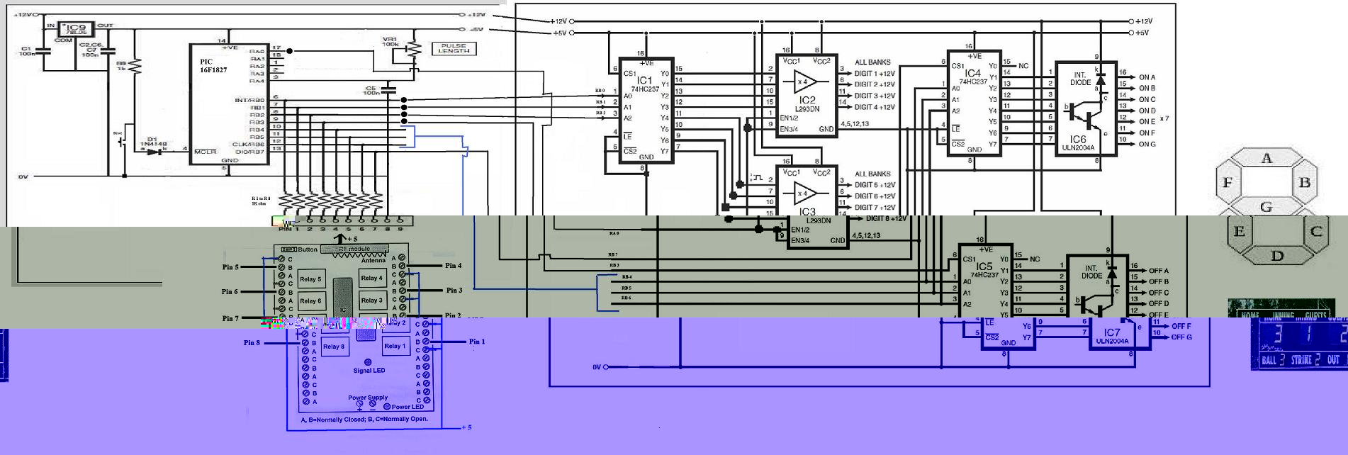

Hi Brendan
I hope I was able to put together a schematic that will help explain the flow. When I built the control I made a PIC PCB board and a separate Driver PCB just encase I need to rebuild say the PIC board I would have to buy new chips for the driver.
The Flow code works 100% what I would like to see in the real chip function but it doesn't do it.
I have been able to see the bank Selection so it must be seeing the RB 0 - 7 input and send out RB 0,1,3. I have a relay board sending the + 12 from the L293DN and the ULN2004 the current draw from the FLIP digits pops the ULN2004. The Flip coils are 480 OHM and activate on +12 as a common. The Flip Digits have 2 coils 1 to Flip the Display to ON and one for OFF.
What I don't see happening is the A-G segments ON or OFF ?
I really hope you have a idea what is happening ?
I did mechanical testing by manually sending RB 0 - 1, 2 to the 3 / 8 decoder and get the expected outputs and the same with the 74HC237 for ( A-G) all followed the expected results.
I just don't see why the PIC is not sending the info out.
I think the code is set to Send when needed and Receive when Needed.
I add the A6 in Flowcode to track events in Flowcode.
Time is ticking and I really would appreciate your input.
John

Hello John.
Apologies for the delayed reply - Too many projects and too few hours in the working week.
I notice from your circuit that diode D1 will scupper things. When you hit the button it will pull down bias from the 1k pull-up but the diode will block pull-low logic at the MCLR pin - effectively rendering the input floating logic at that time. I would advise simply replacing the diode with a 47k resistor which should sufficiently avoid interference to VPP if programming in-circuit. Keep the 1k pull-up to the switch as this will ensure sufficient wetting current for reliable regular operation.
Please let me know your results once the above is resolved.

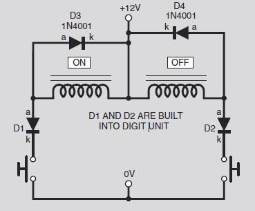

I uploaed on how the Flip Display works.
- Flip Segment flow
- Scoreboard Flip Control.jpg (14.67 KiB) Viewed 33560 times

Hi John.
The trouble with your circuit is the multiplexing of port B as inputs and outputs, as you've already identified.
I believe this can simply be resolved by commoning all Latch Enable pins together (pin 4) of IC1, IC4 and IC5 and returning them to an available port A pin (let's say... RA1). Leave pins 5 and 6 of the latches tied low/high as they are to sustain decoded output logic.
Your flow should then first set the output data on port B and then drive RA1 momentarily low (for at-least a few μs) to clock the latch data into these decoders, returning RA1 high immediately afterwards to prevent switch logic (from the module) from affecting the condition of the latched data when port B I/Os are returned to inputs. R1 to R8 should ensure that any possible status of the switches cannot corrupt data from Port B while outputting logic to the latches.
Your diagram doesn't show sufficient detail of the module circuit or whether you have pull-ups or pull-downs on the module (representing inactive switch logic), but this would be necessary to avoiding floating logic when port B I/Os are returned to inputs. If necessary, you could conveniently apply fairly weak pulls directly to port B, ensuring that they don't significantly divide down the switch logic via R1 thru R8.
I hope this makes sense.

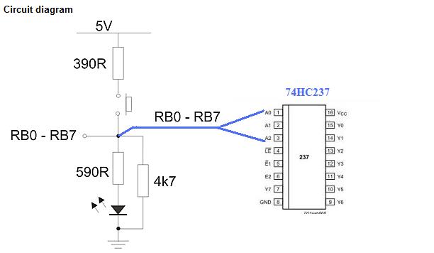

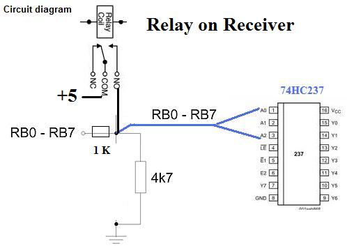

Hi Brendan,
Thank you for the suggestions on the IC 1 - 5
I did have to add a 4R7 K to the RB 1nputs to stable the RB transfer.
Here is a mock up.
Any thoughts on how I could use 7 Segment displays to simulate the Flip controls ?
John
Here is a mock up.
John
- RB0 -7 Input.jpg (18.97 KiB) Viewed 33552 times

Your circuit shows only A1 thru A4 connected to anything, but your code also writes '0' to A6 at the end of macro 'Ball_Display'. Is this an error?
Also, my suggestion was that A1 were commoned to pin 4 of latches IC1, IC4 and IC5, but the flow in "Ball_Display" writes '1' to A2 and A3 in 'Display 2' and 'Display 3' which are also disconnected in your published circuit. Is this an error or are you enabling the latches independently instead? Nothing wrong with that, but I need to be on the same page to consider the process required.
In summary (assuming IC1, IC4, IC5 pin 4 connected together and coupled to port pin A1, as per my suggestion), the sequence for writing to the latches would be as follows.
NOTE: A1 always starts off at '1' before the write operation (always left that way after the previous write operation).
1. Set latch data on Port B (data for all latches)
2. Drive A1 low for at-least 3us (I'd suggest at-least 10us to be absolutely sure of a solid write)
3. Drive A1 high again to disable writes to all latches.
4. Continue reading the switch inputs and repeat from 1 when another latch update is required.
Don't forget that the Flowcode development environment is a logical environment - not a hardware simulator. Never assume that just because it works in Flowcode simulations it will also work on the hardware.
All the best,
Brendan
I think I'm running a little blind...

Brendan wrote:Hi John.
Don't forget that the Flowcode development environment is a logical environment - not a hardware simulator. Never assume that just because it works in Flowcode simulations it should automatically work on the hardware.
All the best,
Brendan

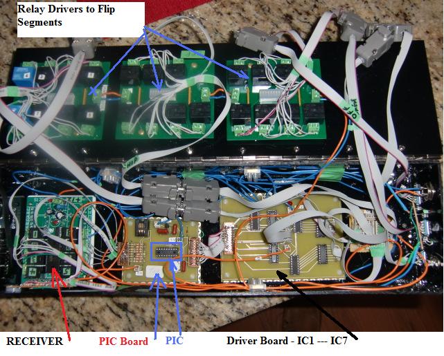

- World of Scoreboard.jpg (83.58 KiB) Viewed 33499 times

Hi John.
Before we go any further, and considering stated anomalies, can I ask if your PIC is situated adjacent to the 5V regulator and output decoupling capacitor?
I ask this as I see lots of thin wires in your image, but can't tell where your PIC is located in relation to the regulator and decoupling cap. In any case there should be similar supply decoupling local to the PIC (as close as possible to the supply pins) as any supply wire inductance to the PIC can easily destabilise operation from even sub-microsecond transients created by the PIC itself. For example, could it be that actions following RB0 activation (Ball switch) are causing following actions to induce momentary supply transients that are corrupting registers and normal PIC operation - even causing a brown-out reset? As there's only a single decoupling capacitor in the entire circuit, this possibility should be eliminated. The PIC should ideally have it's own dedicated supply and ground connections to the regulator (i.e. nothing else supplied from them), preventing other circuit current from creating supply drop-out at the device.
Please ensure adequate PIC supply decoupling with a 100nF to 1uF ceramic cap directly across the PIC supply pins, and check the 5V rail at the PIC holds up without dips after activating the Ball button.
All the best,
Brendan
All the best,
Brendan
LinkedIn Profile...
http://www.linkedin.com/in/brendantownsend

Hi Brendan
No I had to abandon the on board 5 volt it was not working as I hoped I have had to add in a external 5 volt feed.
I have scoped the 5 Volts supply and I don't see any fluctuation that could cause a brown out. I will place a cap across the supply to the PIC.
In the picture the Blue wires are 5 volt to the Receiver to send to the PIC input and 5 volts for the PIC and 5 volts to the Driver IC1 - IC 7
So I should have a separate 5 volt feed to the PIC and a separate 5 for the IC1 - IC7 and the receiver ?
If I was seeing the brown out why would I see the Ball 1 come out and not the Ball 2 - 4 ?
I will do a study on the PIC power in the morning.
John

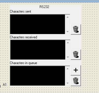

Thank you Martin,
I'm off to the Electronic store to see what I can find.
My version is a Student Version and I can see the RS232 panel So how can I see if it works or do I have to spend more money ?
John
- Posts: 9521
- Has thanked: 2585 times
- Been thanked: 3815 times
Re: URGENT help on PIC16F1827
I'm sorry even though you can see the RS232 panel, you won't be able to compile with itJLeith wrote: My version is a Student Version and I can see the RS232 panel
But that won't stop us from trying.
If you would still like to purchase 5V uart to usb converter, I can add RS232 to your Flowchart and compile it for you.
once you have the hex, you can programm target.
Then you can test with RS232, and decide if you would like the professional version of Flowcode.
At least you won't' be out of pocket by purchasing student version as you only pay the difference.
So the cash you will have to pay out, it will just as though you only bought professional to start with.
