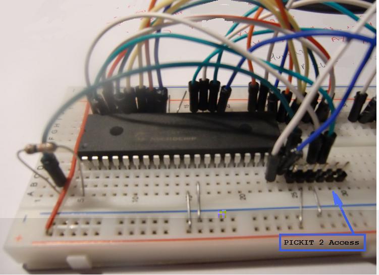

The PiC 16F1937 has just arrived.
I will start building the breadboard later this afternoon
I will add in the PICKit 2 interface and I hope it will work.
This is what I have found on the net
- PIC Programming.jpg (28.1 KiB) Viewed 19395 times

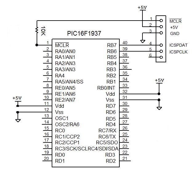

Re: Like to read Port B then send to Port D
That diagram you posted looks wrong to me, unless it's not meant to be in order. The PICkit interface should run like this.I will add in the PICKit 2 interface and I hope it will work.
Hi John, don't forget the 10K resistor (not shown on the diagram) between VPP of programmer and VPP of 16F1937.
Without current limiting, 16F1937 could get damaged.

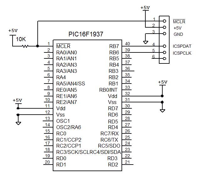

I think I have it this time
I was surfing the net an found the 10K.
Is this correct ?
John
Is this correct ?
John
- PIC Programming with PICKIT.jpg (51.5 KiB) Viewed 19379 times
If it's for a device like 16F887,16F88,12F675 etc, programming VPP is is specified as between 10 and 12V.
This is what the vpp will be on pickit2, so the circuit above will apply if you have external MCLR which is not necessary if say a reset switch is not required then 10K from VPP to +5V is not required.
If using 16F1937, 16F1827, 12F1840 for example which are the newer type of devices, Microchip has dropped the VPP programming voltage from 10 - 12V to 8 - 9V
So if using pickit2 which does not alter VPP voltage to suit, then it can cause damage to the newer devices.
So I place a 10K resistor between VPP of programmer and VPP of microcontroller when using a pickit2 to limit the programming current to a safe level for the target device.
So if MCLR is set as internal no resistor is required from VPP to +5V
If you wish to enable MCLR and connect a reset switch from MCLR to GND, since MCLR and VPP are shared, you will need an additional 10K resistor going from MCLR/VPP to +5V as well. Or you can use a diode of course.
Hope that helps to clear things up.
When designing the PCB make sure get ICSP connections in the correct order (Just like Ben has pointed out)
The last circuit diagram is the correct order for pickit2.

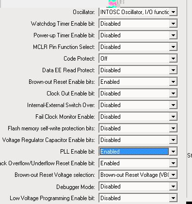

No you don't place any code to change MCLR from default external to internalJLeith wrote:Were do I place the code for MCLR to be internal ( Main Page ?)
You need to enter configuration options ('Build', 'Project Options') then select 'Configure Chip'
You will need to change MCLR pin function select to Disabled.

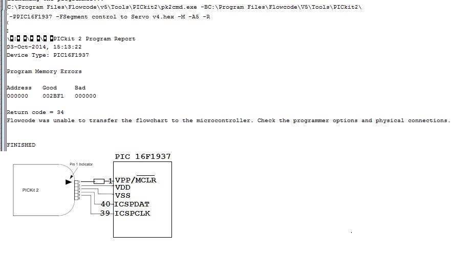

Ran into a brick wall
I was trying to load the PIC 16F1937 with Rev 4.
I tried it two ways
1. No +5 from power supply ---- No luck
2. Applied + 5 to rails ---- No Luck.
Here is the error message form Flowcode
Here is the Breadboard
Only thing I can think of is the ICSPDAT and ICSPCLK are connected via Jumpers and maybe getting interference ??
I did check the connects with a meter just to ensure they were correct
John
I tried it two ways
John
- PIC Unable to Transfer.jpg (35.52 KiB) Viewed 19325 times
- PICKIT 2 Access.jpg (49.42 KiB) Viewed 19325 times
- Posts: 9521
- Has thanked: 2585 times
- Been thanked: 3815 times
Hi John,
I have just placed a 16F1937 on a plug-in Prototype board.
Connected last two pins of header directly to pins 39 and 40.
connected a 10k resistor between VPP of programmer and VPP of 16F1937.
With no power connected, Programmed board and got: With power connected I got the same error as you which is:
So you could try removing power as that allows successful programming every single time.
I will see if I can investigate.
Address Good Bad
000000 002BF1 000000
Return code = 34
Hi Martin,
I tried it without Power because this is how I did the 16F1827. I was never successful on the "In Circuit" programming with the 16F1827.
I will remove all the PortB and Port D wiring and see if this what is causing the error. I was hoping to do the in circuit so I could load code without having to remove it from the PCB to a breadboard.
I see other blogs that they make it possible.
I will see what happens and add 1 lead at a time to Port B and Port D and see what happens
Glad at this point I haven't send in the PCB to be made.
Off to investigate also
John
John
- JLeith
- Posts: 537
- Joined: Wed Nov 14, 2012 7:49 pm
- Location: British Columbia Canada
- Has thanked: 146 times
- Been thanked: 26 times
Martin your wizard hat was on this morning and you got it to work with no power.
I stripped of all the leads and only had the programming.
I will add 1 lead at a time and see maybe I had one of the Port pins wrong.
More later.

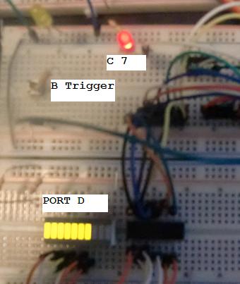

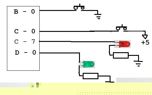

Had the RED led on the wrong port
Corrected
Still won't trigger C7 or D0.
Set the chip timing to 1000 to slow it down maybe I was missing the Port D.
No action at 1000
Corrected
No action at 1000
- PIC test.jpg (13.65 KiB) Viewed 19299 times
Hi John,
Here is what you will need to do to get things running on hardware.
1) It will probably be best to set internal osc at 32MHz (currently the osc is set to external).
To change osc to internal and run at 32MHz you will need to go into the configuration settings and change Oscillator to INTOSC Oscillator, IO function on RA7 etc
Then change PLL enable Bit to Enabled.
Enabling PLL is a x4 multiplier on this chip (Phase locked Loop) so instead of running at 8MHz osc is running at 8 x 4 = 32MHz
2) Change clock speed in the general options tab to 32000000.
The clock speed in general options is just for timing of delays or components that relay on delays. E.g LCD, software I2C, Rs232 etc

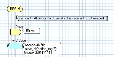

3) At the very top of main (before start of any loops) add a c code block with
The osccon=0x70; sets internal osc of hardware to 8MHz
4) Change MCLR pin function in configuration settings from Enabled to Disabled.
5) You will require to enable weak pullups on port B.
You cant leave an input floating (nothing connected when switch is open circuit)
Luckily port A and port B both have internal weak pull-ups.
So to set weak pull-ups you first need to enable weak pull-ups by adding to the c code block
Now each individual portB pin can have a weak pull-up enable or disable by
to enable pull-up x=1
to disable pull-up x=0
So if you use wpub=0b00011111;
Weak pull-ups are only enabled on port B0 to B4
If all of portB weak pull-ups are required then you can use:
or
or
So now your c code block should have:
osccon=0x70;4) Change MCLR pin function in configuration settings from Enabled to Disabled.
clear_bit(option_reg,7);Code: Select all
wpub=0bxxxxxxxx;to enable pull-up x=1
wpub=0b11111111;Code: Select all
wpub=255;Code: Select all
wpub=0xFF;Code: Select all
osccon=0x70;
wpub=0b11111111;Martin

Wonderful work Martin
I would never would of know these options.
I have made the changes.
1. Chip
2. C Code settings
3. Port D Trigger all when only 1 B - 0 selected
Martin if I set Port B to weak pick up don't I require say a 10K battery supply so Port B doesn't get noise and trigger ?
4. Port B with pull up. --- Only allowed 3 images post on next message

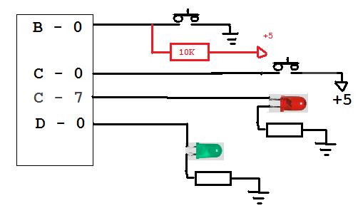

Would this image help stop the other Port B to also trigger
1. Pull up in RED
I have also added the Flowcode version 4.
1. Pull up in RED
