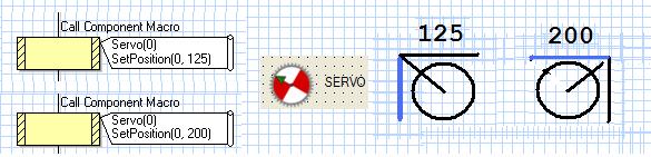

I was able to make the Servo activate after a couple of hours searching for Flow code examples.
Martin in Flowcode why is the Servo action not really showing the ( 0 ) and ( 255 ) rotation. I had to find that the centre is 125 and the flipping to the left from 125 is 0 and to the right 255.
I thought the rotation image servo would show this. it looks like 0 is at 45 degree and 255 is at 60 degree.

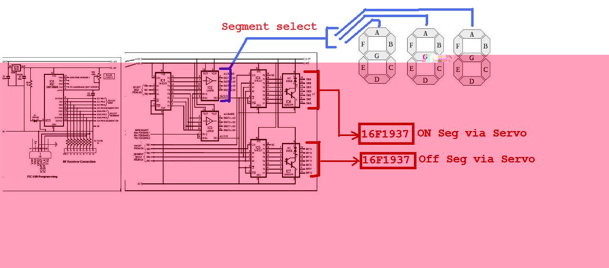

I have tried to capture the new design in a simple image attached.
I have attached the Flowcode with the servo action.
Why does Flowcode 5 only allow 1 servo image when it allows several push buttons and leds ?

- Servo rotation.jpg (26.93 KiB) Viewed 27414 times
- (77.83 KiB) Downloaded 7323 times

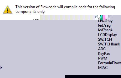

Now here is a big problem for you to think about.
The servo component is classed as advance.
Therefore you must have the professional version to allow compiling to hex or target device.
If you have got the home/student/free version you will be unable to compile.
Well that is the case with V6, im sure its the same with all other versions as well?
So before you go to far down the line you will need to check you can compile to hex ok?
If unable to compile and can't afford to purchase professional version then you will need to bit bang.

Hi Martin,
Well this is a sad day and the sunshine is happening.
So my Ver5 Student is not powerful to simulate Servo's
Martin what Version of 6 are you running ?
I like the 3D display. I really would like Version 6 with a analog version and when I compile the Hex I can see it work on the Servo.

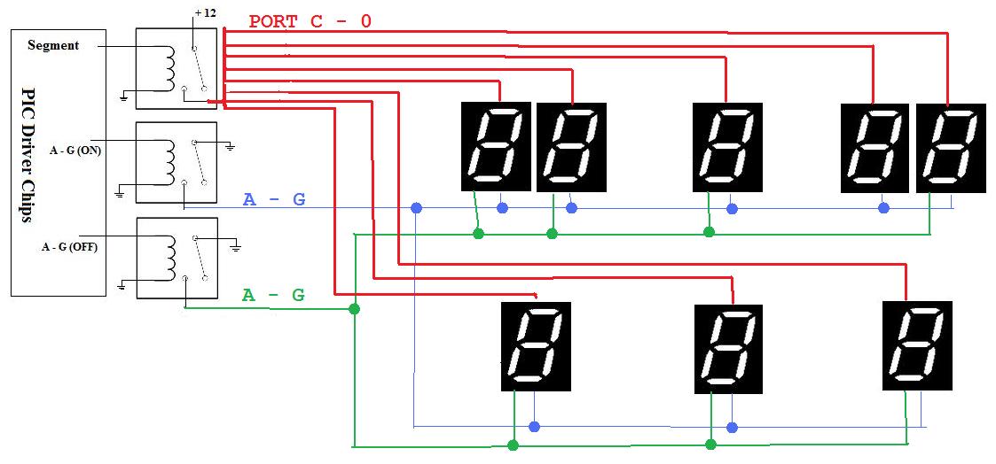

I have attached the flow for Port B and the Control. The Port B is shared to all the 8 displays and only the Displays that can flip is the one with the PORT C bit active.One question, will there ever be a case when port B could change more than once before port C0 sw is pressed?
If so what do you want to happen?
Use the latest portb or disable portb until sw is pressed?
Now on the Port C bit should I change it from a +12 to + 5 or is a Ground trigger better ?
The A - G bits are sent 1 at a time . Eg for Digit 1 Port B ( B -----250ms------C-------250 Port C shuts off )

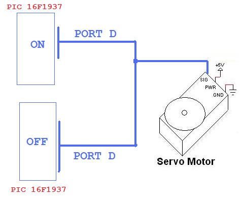

Martin you were saying that I should not connect the LED to the PORT D directly ? Can use a 1.2K connected to the Port D and then the LED ?
When the day comes to put in the Servo can I connect the signal lead directly to the Port D ?

Yes it's true, you don't connect LED directly to any pin of microcontroller as too much current will flow though both LED and microcontroller causing damage.
What you do is see what the LED forward voltage and current is. E.g 2.2V @ 10mA
You know that output pins are about 5V when high.
So to calculate limiting resistor value:
(5 - 2.2) / 0.010
= 280
I would round to the nearest prepared value of say E12 series = 270 ohms
In practice you can increase the resistance value which will cause less current to flow so LED will be dimmer.
So long as LED is bright enough as an indicator the higher value resistor the better.
So connect one end of the resistor to the output pin the the other end of resistor to the anode of LED, then the cathode of LED connect to 0V
What I was saying in the previous post is don't connect the LCD pins to port B or D since they are already used.
Servos signal line draw very little current so yes they can be directly connected to the microcontroller pins.
No relay required.
Although you don't have to disable signal to servo at all since a pulse width represents a fixed position.
We will be using 3 different pulse widths just in case the pulse width is stretched during portb interrupt detection (although it maybe too quick to affect the width?).

So you confirm that I will need two PIC 1 for On and 1 for Off. They have separate Port B signals so I can program 1 chip as 450us and the other chip with 245.
