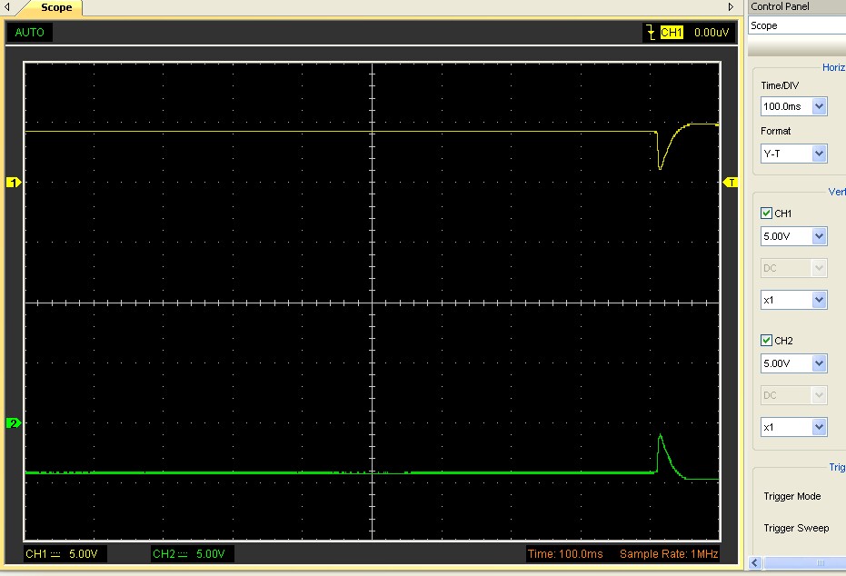

Here are the results of morning tests. Push button pushed once and given pulse into the sensor. From scope you can see the curve but nothing in LCD. In case waiting some 3 sec and then given new pulse result can be seen in LCD and of course in scope.
jjw
Posts: 9521
Has thanked: 2585 times
Been thanked: 3815 times
Re: Help needed!
Hi jjw,
Without more details can't determine what's going on.
First I'm assuming that the switch in question is connected between portB6 and +5V.
There is a pulldown resistor from portB6 to GND.
So B6 is normally low when switch is not pressed?
So we are looking at the green waveform (PortB6 & GND)?
jjw wrote:Push button pushed once and given pulse into the sensor.
There must be a time delay before sensor is triggered after pushing button (I'm assuming top waveform)
At least 1.2 seconds for 300km/h
jjw wrote:From scope you can see the curve but nothing in LCD. In case waiting some 3 sec
Is the LCD displaying Start or Lap0?
Assuming Start?
Can you give as much details as possible please as it saves assumptions.
Port B6 and +5V.
Yes and there is 390 R resistor between +5V and switch.
There is a pull down resistor from port B6 to GND.
Yes there is 4.7 k resistor.
Yes it’s low normally.
No we are looking yellow waveform since the green one is invert.
Assuming Start?
When switch is pushed it is displaying Lap0. When the switch is not pushed waiting for start it is showing Lap0 and Start

jjw wrote:When switch is pushed it is displaying Lap0
That part is normal.
jjw wrote:When the switch is not pushed waiting for start it is showing Lap0 and Start
I think know why that is.
The switch is being detected as pulled high again 100ms or greater after the initial switch.
Can you set the scope for a longer time period and monitor between B6 and ground.
If that is the case then that is one serious bounce problem.
Monitoring is the only way to find out.
Also I have modified flowchart to display switch count.
So if switch is detected more than once, you should see that on the LCD:

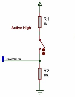

Just to check that I got it right the resistors are connected as they are in a picture. Is it OK like that?
jjw
Active high.jpg (6.38 KiB) Viewed 23741 times
Posts: 9521
Re: Help needed!
Hi jjw,
Yes that's fine.
V across R2 will be R2/(R1+R2)*V supply=
=10/11*5
=4.5V (when switch is pressed)
