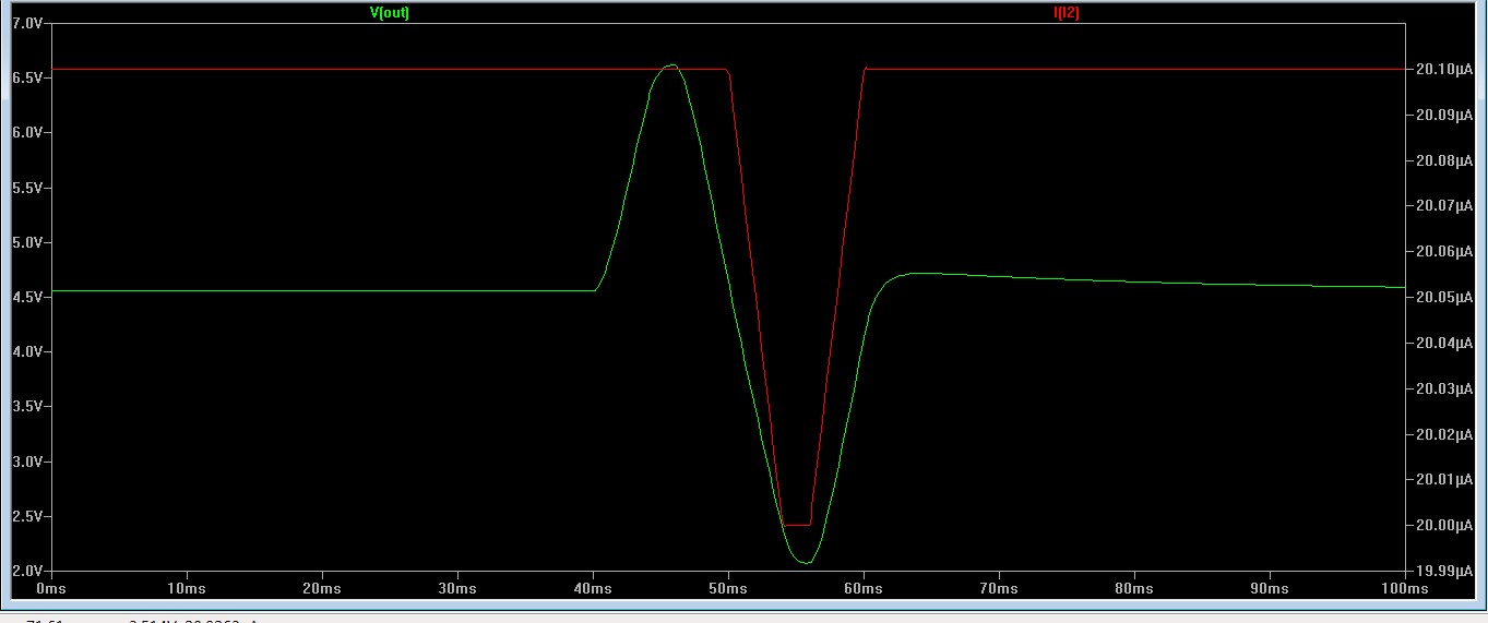

Hi folks, I would be grateful if someone could suggest the way how to detect my sensors curve in my flowchart. These curves are recorded in a field from my sensor with two photo diodes.
Every time the plane (some 60 cm long) passes the sensor with two detectors the flowchart should only recognize the shape of the pulse coming from sensor nothing else. Circumstantial factors for this time keeping system are quite challenging since in the field can be bright sunshine cloudy and everything between that….

Posts: 9521
Has thanked: 2585 times
Been thanked: 3815 times
Re: Help needed!
Hi Jukka,
Probably the easiest way would be to change port interrupt from positive edge triggering to negative edge triggering
You will probably have to add a potential divider to the output so voltage of pulse drops below triggering threshold voltage.
Can you give the untested flowchart a try and see if it works.
Someone else will probably have a better idea, but the above is the way I would probably tackle it.
Timing systemv4.1.fcf
(21.74 KiB) Downloaded 1059 times
jjw
Posts: 78
Joined: Sat Aug 25, 2012 5:35 am
Has thanked: 71 times
Been thanked: 9 times
Re: Help needed!
Post by jjw »
Thanks Martin I will test the flowchart early next week when getting into my lab.
I tested the flowchart in a Real Pic Simulator and it works just fine.
Wbr,
jjw
Posts: 9521
Re: Help needed!
np.
Let's work out what you will need to do hardware wise.
Looking at specifications on page 365 of the datasheet input low for TTL input (RB7) is maximum of 0.8V.
For good reliability We must make sure that input drops lower than this say 0.4V
Also look at the datasheet, we also need to make sure that in normal sate i/p voltage stay above 2.0V
So at least 2.2V (the higher up to 5V the better).
According to your scope the highest voltage is say 6.7V and the normal voltage is just over 4.5V.
unfortunately doing the maths any potential divider will take the voltage out of either high or low range.
So the band of 2.0V and normal 4.5V will require widening or triggering may not get detected
If not, the only other way maybe to tightly poll ADC.
I'm sure that could work :?:

jjw wrote:Correct if I’m wrong but I remember that in early days the chart was recognising the pulse of the rising edge. Now it seems that the chart should recognised of the falling edge. In case I’m right any change that you could advise me how to do it.
Jukka
Since you wanted to start timing when voltage falls bellow a certain voltage then we call it a falling edge anyway.
So your hardware will work on falling edge.
I can't tell by the scope waveform what value for
(adc < 204) || (allow_tmr = 0)
is required since there is no scale of divisions for voltage.
E.g 500mV per division.
You can work out correct value.
When you know what the trigger voltage is going to be e.g. you want trigger to be 2V or less then
adc value = 255/5 * trigger voltage
= 51 * 2
= 102
Therefore correct code will be:
](adc < 102) || (allow_tmr = 0)
I can't tell by the scope waveform what value for.
The sensor works just fine the shown and used voltage is 4V. Stronger pulse than previous sensor design. ....
