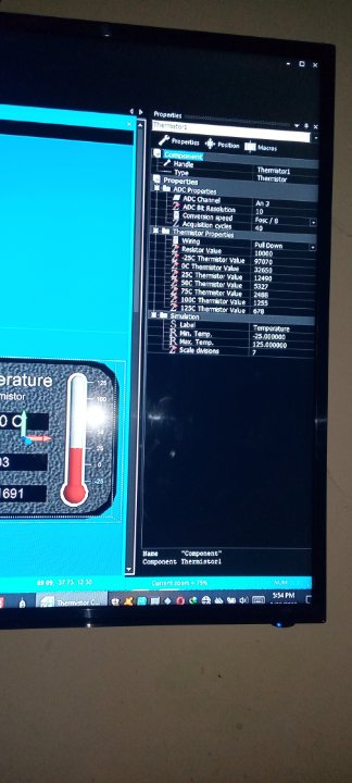

Ok, i dont know how the thermistor component works but i really need to know how it works coz imagine i don't have the beta coefficient value and the only option is to use the thermistor component, i have tried it and am not getting good results.Temp value not changing with changing temp stuck on -20°C on real board but in my flowchat it does change, Reason is am not doing things the right way with the thermistor component.
Thermistor Component.fcfx
(16.59 KiB) Downloaded 370 times

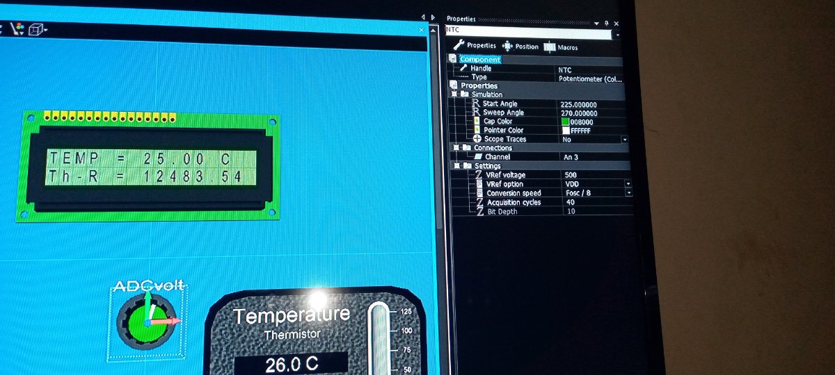

Posts: 9521
Has thanked: 2585 times
Been thanked: 3815 times
Re: NTC thermistor Temp sensor

Sat Aug 29, 2020 12:59 pm
Just tried your flowchart and hardware is working ok with thermistor component.
Did not need to modify to get it to work.
Does the resistance value change and what is it showing for room temperature?

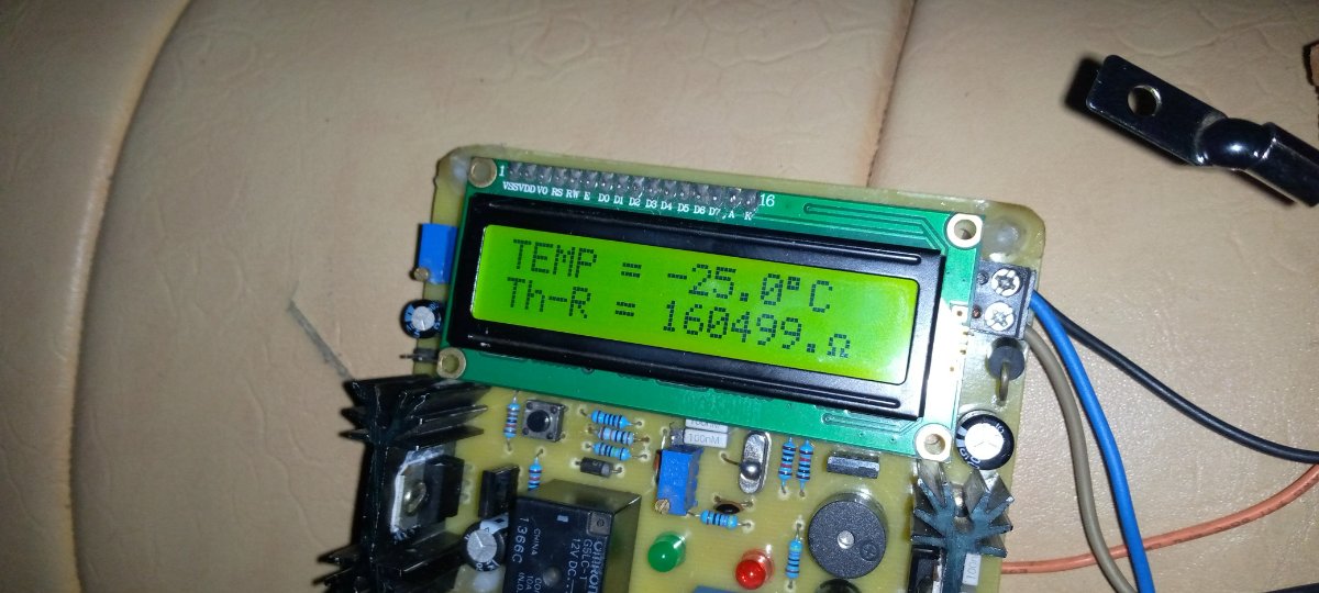

On my board room temp it shows 16k and resistance value is changing ( reduces when i press my fingers) but not the temperature (stuck on -25°C)

Posts: 9521
Derrihj wrote: ↑
It's because you have the wrong ADC channel selected within thermistor component properties.
It does not match the POT ADC pin connection.
You need to ensure both match.
Posts: 9521
Derrihj wrote: ↑
Sat Aug 29, 2020 3:14 pm
That's not 16k that's 160k which will be wrong.
Looks like an hardware issue.
On my hardware using your code, the resistance is showing approximately 9k and temperature of approximately 36C
It's out to my room temperature as you have entered 12490 for 25C which should represent the actual thermistor resistance.
Mine is 10k
Have you measured the voltage on pin AN3 with respect to GND?
If so what is it?
Derrihj
Posts: 348
Joined: Mon Jul 09, 2018 12:43 pm
Has thanked: 67 times
Been thanked: 33 times
Post by Derrihj »
I can see 4 volts there
Posts: 9521
Derrihj wrote: ↑
Sat Aug 29, 2020 4:19 pm
What temperature are you expecting?
That does not make sence.
If VDD is around 5V and you have about 4V on the ADC pin then you should be seeing around 2C and 28k
If seeing -25 then does not look like correct pin with the 4V on it is being read.
Also if not expecting 2C then hardware is wrong as the voltage is not correct.
Derrihj
Posts: 348
Post by Derrihj »

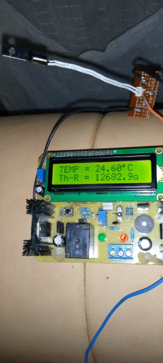

Ok 4 volts at the adc didn't make sensor to me even when i removed the NTC so i looked closely to the PCB since this PCB was not not for a temp project i just made loops on it some how one root got into contact with the 12v supply messing up all readings fixed that and everything seems ok now thanks Medelec35 for you being really patient with my mistakes.
Posts: 9521
It's Ok Derrihj,
The main thing is we got to the bottom of the situation and it was resolved.
So you have a 12K thermistor?
If supposed to be 10k, I would take more samples of Temperature V resistance.
As said previously, the resistance at 25C is the actual themitor resistance.
So if 10k thermistor used, at 25C the resistance will be 10k.
Reason: Added more information

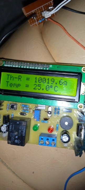

Got another 10k Thermister and works really nice "right on the money" with your Beta version Medelec35.
