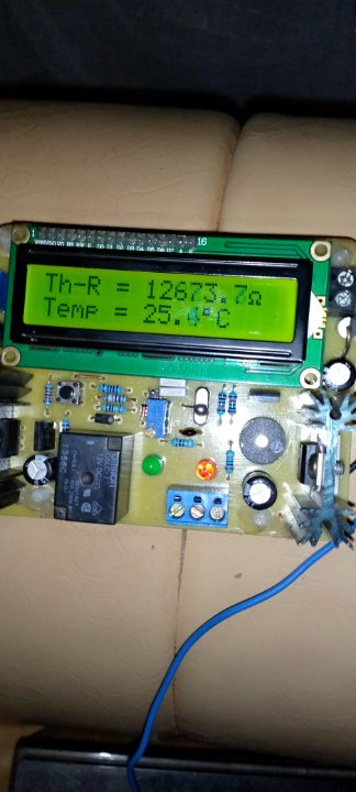

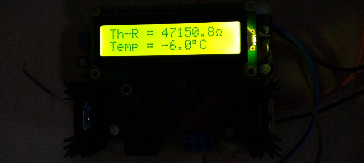

Ok now this is where it becomes interesting "learning time" i changed the code to work with my hardware running @ 8mhz external crystal with the PIC16F886 but to my supplies when i heat up the thermistor with a soldering gun interested of the temperature going up,it goes down to negatives but the resistance increases so it's the opposite of what it should do when i increase the heat may be am doing something wrong.And when i replace the NTC with a 10k res 1% it gives me -20C

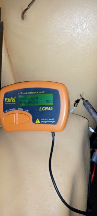

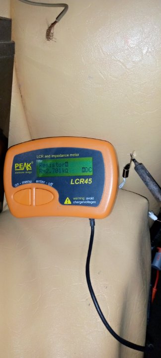

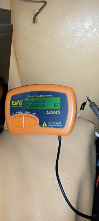

No it's an NTC coz before i hook it up on the board i first heat it up with a soldering gun and it does what NTC does best as temp goes up resistance goes down see pics below.

Can you let me know the thermistor value at 25C and have you got the themistor connected to i/p pin and GND?
What value pull-up resistor have you got between i/p and +ve?
LCD is saying it thinks the current value of thermistor is 47K which does not sound correct as if 10K thermistor, it will be really cold.
You will need to look at all the Constant variables and make sure all values are correctly entered.
The issue might be to have connected themistor between ADC i/p and + supply?

Thanks Medelec35 issue was themistor between ADC i/p and + supply? Since i had already done the PCB before your flowchat so i changed to pull-up to +ve 5v and thermistor to GND and it obeyed like a humble dog now i have a task and that is to get to understand the code.
