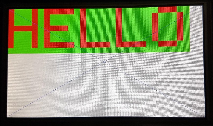

Re: SSD1963 hardware not working properly
Running on an ECIO40P16 I have the following.
Aiming for this.
I get this.
so we are close. There seems to be an area after the initial half that's corrupted but then it's good again by the end. I'll investigate. That video you sent me looks like it's on the same track so hopefully will help a lot. Rewatching it now.

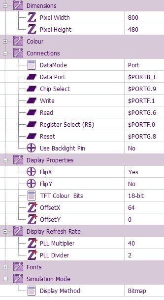

These are my component properties atm.
Yes the video showed me the way and I've now got the display fully working.
I've got the following connections to the display.
