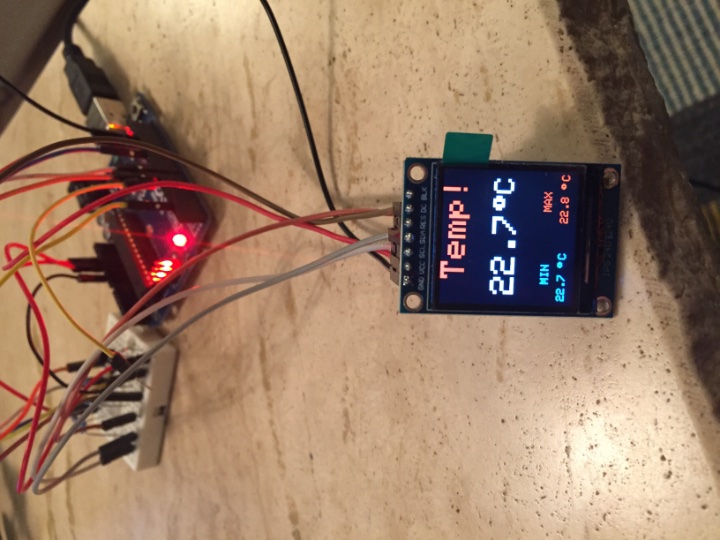

Hi Martin
Strange. Sometime the First work sometime not?
The last you send not work at all.
Here is a picture from a IDe projekt.
I have used the same config all the time.
And when I use your sometime I see abcdefgh next time
I upload not working?
