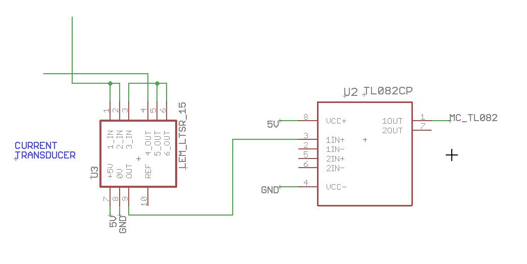

If I get this to work then there is a another problem. The original PCB is from 2005 ? and there is a TL082CP between the output from the LTSR-15 and the PIC. Original there was a PIC16F876A ?? on board. The text on this PIC is almost gone
I have redrawn this damaged PCB as it was. So, also with all the components. It works great but the last thing is the LTSR-15 for safe use.
Attached there is a part of the schematic as it is. MC_TL082 is a connection to the PIC.
Frank607

I have taken your code from the LTRS 15 into my code. Now the total code is running very slow on hardware. I have disabled the decision “ResultFloat > 7.49” and it makes no difference.
So, the slow running comes from the Component Macro “ResultFloat… “ and the Calculation icon “CurrentString…”
Is there something I can chance to let it run is faster ?
Btw, I have removed the TL082CP and put there a solder wire between the two pins.
Frank
