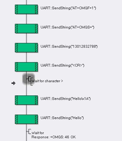

Findings using SIM800L and Flowcode Generic GSM component (based on AT Commands).
The component macro "Initialise" states Returns 0 for OK, 255 for no reply and 254 for command fail.
Monitoring the Tx/Rx ports of my chip I see AT+CMGF=1 being sent when Initialise macro is reached (sets SMS messaging to Text Mode), and the reply of
AT+CMGF=1
OK
That would suggest that the module accepted the command however FC returns 255.
Moving on I thought it a good idea to check the network status before doing anything fun. FC allows such with the CheckNetworkStatus which states for Return 0=Not Connected 1=Connected 255=No Reply from GSM
I see AT+CREG? being transmitted and depending on status I get a reply from the module of
+CREG: 0,x
OK
where x = status 0=Not Registered 1=Registered Home 2=Not Registered but Seeking 3= Denied 4=Unknown 5=Roaming
Depending on what is happening I can see values for x of 0,1,2 and 3 however Flowcode always return 255
When I'm lucky enough to be connected (module LED flashes once every few seconds rather than every second) I get brave and text using the SendTextMessage macro which states a Return of 0=Success 255=Failure
I see the commands and message being sent. Depending on Network status this does actually send the message OK or it fails with ERROR being sent back from the module. However FC always returns 255.
It would appear that FC isn't reading or is perhaps misinterpreting the module responses. It would be nice if this is resolved as the component macros simplify a lot of work.

Hi guys
Attached is a Flowchart that will update ThingSpeak with sensor data using the SIM800L GSM module (and most likely any similar module by using AT commands), based on the steps documented in a previous post.
It uses the "Combo" board for display and inputs, but of course you can tailor to your own needs.
Briefly, it waits until a button is pressed, samples a sensor and then posts the result to ThingSpeak. Before running you will need to assign unique details to certain variables such as access point name, host and api key.
Once a command is issued, it waits for the appropriate response from the module by polling the Circular Buffer before moving on to the next command. The display shows the command being processed.
The purpose of the chart is to show each step in turn, and can of course drastically reduced to be more compact by omitting unnecessary components once you have it working with your credentials. For example you don't really need to display each step in turn and you could use the "wait for" command in the CB. Instead of "switching" to the next step you might just create a more linear chart or you may wish to omit checking for certain responses entirely by adding a delay between commands. You could even just directly assign certain strings instead of "building them". Typically I like to see what is happening where and when to aid debugging before stripping away all the padding
Flowcode does have a Generic GSM component which would greatly simplify things but as mentioned earlier in the thread it appears to have some bugs, constantly returning incorrect values.
If I were creating a gadget, I'd first test that everything works and updates correctly, then create a very basic no frills chart to update, perhaps calling it as a User Macro.
Another useful thing is a USB to Serial convertor monitoring what the module is sending to the microcontroller. This greatly aids debugging (especially if sent commands are echo'd).
Operators count both Tx and Rx data in determining how much data you have consumed each month, and from messing around with this, a reasonable guesstimate to update a server would be around 250 bytes (depending on what you are sending etc). If you were updating once every minute that would total around 11MB per month and is easily accommodated by even the most miserly of PAYG plans. However, as per earlier in the thread you would possibly be better off getting an IOT SIM.
I might create a more compact chart later in the week, if I have time.

Sending and receiving SMS messages is very easy and both modules seem to be more or less using the same commands.
The manual(s) will explain commands in detail but it's easier to work with the unit in "Text" mode, and this is done by issuing a command:-
AT+CMGF=1
OK
This is the most basic setup and you can send / receive from this point on.
To send:-
AT+CMGS="123456789"
> Text-To-Send (Ctrl+Z)
Where 123456789 is the target number to send to, Text-To-Send is your message and terminated by Ctrl+Z (ascii SUB / Hex 1A)
That's it, your message should be sent.
When a message is received, the module will forward the following:-
+CMTI:"SM",x
This indicates unread message(s) where "x" is the message number.
To read unread messages issue the following:-
AT+CMGL="REC UNREAD",0
The module will respond (for each unread message):-
+CMGL: x,"REC UNREAD","+yy123456789","","date,time+zz"
The-Message
Where x = Message Number / yy = country code / 123456789 = Sending Number / +zz = GMT Offset
The-Message = the actual SMS message received
The above is all that is required, but as mentioned it's a very basic setup and you may wish to configure differently, perhaps including a test to see if first connected to the Network, or perhaps prohibiting incoming indications being forwarded whilst "on-line". You might even wish to just allow messages to pass straight through to your microcontroller directly, storing the incoming stream directly in a Circular Buffer for processing.
Issuing
AT+CNMI=1,2,0,0,0
OK
Will do that.
I suspect you will probably only have a limited number of predefined texts to send to indicate status and the same for incoming texts. If you parse the received message for your telephone number AND one of your predefined messages then you can be pretty certain it will only respond to valid commands issued by yourself.
AT+CMGF=1
OK
To send:-
AT+CMGS="123456789"
+CMTI:"SM",x
The-Message
Issuing
AT+CNMI=1,2,0,0,0
OK
Will do that.
I might get a chance to create a simple chart illustrating the above if EE stops messing around with a barber's shop up Snowden and fixes service in my area........
The Flowcode component can do most of what you want, but as mentioned in a previous post the return values are incorrect.
EDIT...
Just discovered that FC doesn't appear to be sending much to the module so best not to use the GSM component until it is fixed. I use the UART to send and receive.

Thank you Chipfryer for a good info.
Please explain a bit more about Ctrl+Z.
Does it mean I have to send in ascii
SUB / Hex 1A ?
OR
\x1A

Re: Send Data on email using GPRS
You're correct, just add \x1A to the end of your "message" string to terminate.
It's a pity that the component isn't working as it has the capability to extract both number and message from the incoming stream, which would simplify your application. However if you store the incoming stream in the Circular Buffer you could look for the presence of your telephone number and your specific message on a case by case basis.
Looks like I have to send as:
- uart_tx_sms_1.jpg (42.68 KiB) Viewed 49722 times
