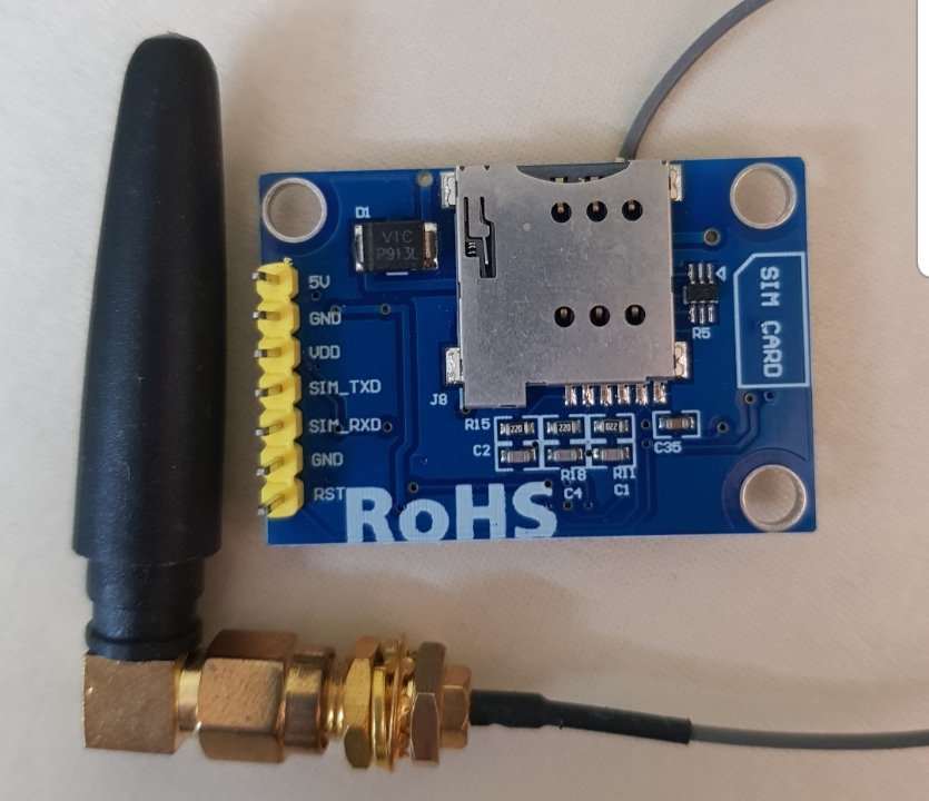

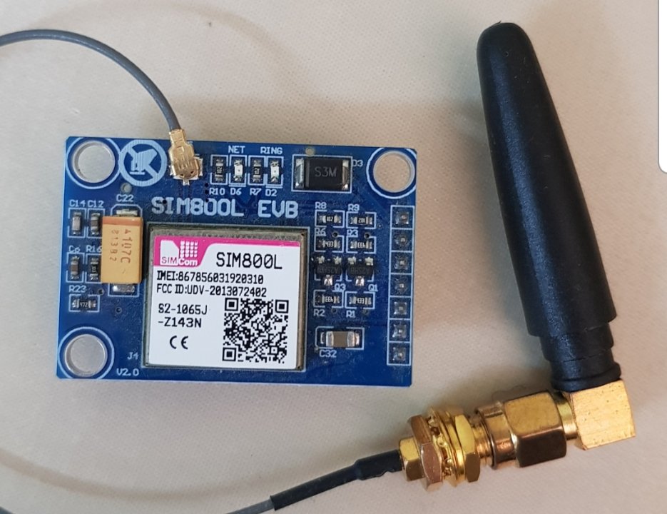

I have 2 modules, one is SIM800A and another one is SIM800L EVB, mentioned as V2, to be honest I am not aware why mentioned as V2 for this module, probably some more functions are available.
When I purchased this modules in the past I thought of making a project to send and receive SMS, but unfortunately I did not worked on that too.
I hope the modules which I have for the moment will be useful, the one which you mentioned is Industrial grade, if I am not wrong and so expensive too.
Thank you again, hope to hear you soon.
Abhi
Good afternoon
Many thanks for your reply.
Abhi

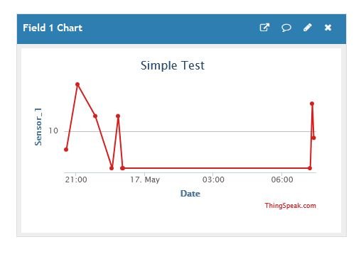

I'd forgotten about ThingSpeak, MathWorks and MatLab.
Took me about ten minutes to create an account and successfully post data
Actually creating the account was the most trouble.
Free for certain limited uses.
You need to first create a MathWorks account and verify etc. Once done you can use the same credentials to login to ThingSpeak.
Once in ThingSpeak go to My Channels and Create a New Channel
Call this whatever you wish and Add Fields
I added a single field and called the field Sensor_1
Once you have decided what you want, scroll down and Save
You are pretty much there now.
When you Saved you will be taken to your Channel "dashboard" and from there you will see a row of TABs.
Click API and you will see your Write and Read API Keys (and examples of how to Read and Write).
To send a value of "7" to your Field you need to make the following request
https://api.thingspeak.com/update?api_key=xyz&field1=7 (where xyz is your API write key)
That's it. You will see a chart with a single value of 7 along with date and time.
In Flowcode you can make the above requests quite easily and instead of a fixed value of "7" you can have a variable (e.g. sensor value).
With it being MathWorks / MatLab you can imagine what you can do with the collected data. I'm sure though that a lot of the good stuff will be in the paid for versions but the free version will at least let you see what can be done.
The above whilst simple to implement isn't secure as everything is contained in the URL you create, however it will give you a starting point to explore further.
If I get time later in the week I'll try and post a Flowcode example of posting sensor data (or whatever) to ThingSpeak.
Edit....
This is how ThingSpeak displays your data, per field. You can export your data as CSV too.

In Abhi's scenario it would be a good option to send his sensor values using data to ThingSpeak (or similar) for historical reference etc as his information is one-way. Perhaps his microcontroller will also decide locally an alarm event and using the same methodology send a trigger to PushingBox or the like that will then notify him by Push / email /whatever. The data requirements for this are very modest indeed.
However you need two-way interaction and by far the simplest and possibly most reliable way would be by using SMS as all you have to do is send messages from your phone. The modules are capable of MMS so you might be able to send the images using that feature. Although with all that data available, it's a shame to waste it. If you had a 4G router (providing WiFi) you could incorporate any number of sensors/gadgets to control/monitor your house and also CCTV.

I dug out my SIM800 module. I need to attach the pins to it and then it will be ready to test with. I'm also intending to dig out my ESP8266's and revisit using them to send data to PushingBox / ThingSpeak as since Abhi started this thread it's piqued my interest in what ThingSpeak / PushingBox / IFTTT can do.
My plan is to first connect the modules to a PC running a terminal program such as PuTTY or the like. This way I can send in AT commands and see the responses. Once I figure out what to send etc I can then make a uC do it using Flowcode and I'll know exactly what the uC should expect to see too.

Thankfully I have an "evil lab" at my disposal as despite the dishwasher being a compact "worktop" version you need an area at least four times it's footprint to dismantle it, to say nothing of how wet you will get.... A lot of bother to discover a dodgy motor capacitor. Appliance spares people want a whopping £36 just for a 3uF capacitor..... Major component vendors will do it for a pound or two, but unless you are adding it to a bigger order, handling and such still brings it to "too expensive".... Amazon can get me two by tomorrow for under a tenner so hopefully only one more night with the dreaded marrigold's..
I grabbed a SIM card when out. Cheapest I could find was with EE and for a fiver I get a few hundred texts, a few hours of voice and 250MB of data. This is more than enough for me to play with.
