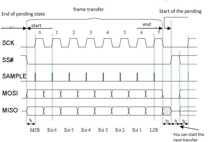

Good afternoon! I looked at the description of the logic analyzer "cheapo", a device useful in the household, but it only allows you to see logical zeros and ones and their bundles or combinations, but does not decrypt this "logical fence", especially it would be useful to make sure that the information that we need is transmitted. Therefore, the name "logical visualizer" is more suitable for this device, so that users do not confuse "warm" and "mellow".
The SS or CS signal, the slave controller selection signal, looks wrong everywhere on my charts. It should be of negative polarity, but I get a positive one. And the CKL sync signal is not visible .But this is in the simulation program.

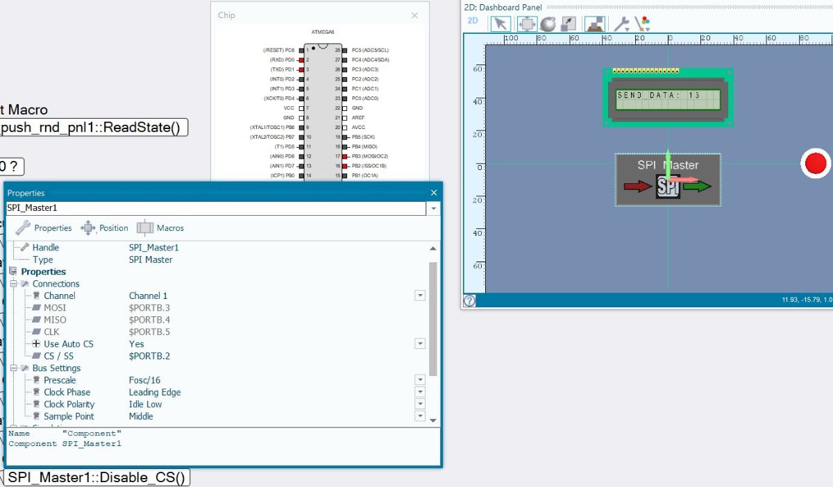

Good evening! Well, the situation is somewhat more complicated, but the fact that I soldered it works-the display and the button, but problems begin with the SPI bus. First, I made a program where the button was pressed and while it was pressed, the count took place and this data had to be sent to lcd1602 and sent by the spi master module.Everything worked in the flowcode program, but in reality it began to hang somewhere after 1-2 counts of the variable. I thought I had done something wrong and redid it and ran this program without sending data over the spi bus-everything worked out correctly. So the problem is in the spi module. I redid the program several times, but it still started to hang in reality.
- test_send_spi_push_latching.fcfx

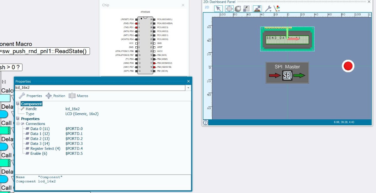

Next, I made a program without a button, there was a looped process of sending data over the spi bus once per second. On the oscilloscope, we could only see the signal from the SS output-it turned out to be what it should be-of negative polarity. But for some reason I didn't see the rest of the signals. Now I will try to see the signals when the data will be sent from a short-term button press.

To simulate in FC I changed to CS pin from B2 to C2 and could then use the datalogger to see what was happening on the pins. For some reason it wouldn't let me use B2.
It ran fine in simulation.

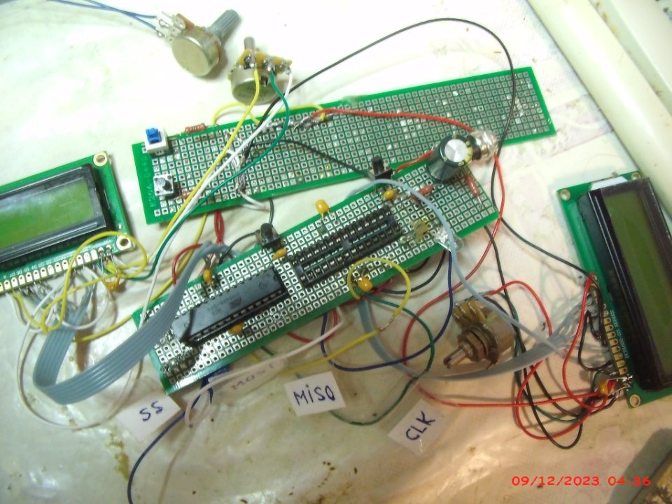

Good evening! yes, you're right, I also noticed that by default in the flowcode program, the ss output is used in the c2 output. But I didn't try to connect it that way, I tried when ss uses pin b2. In addition, some sources say that when transferring data from the master to the slave, if only one slave, then the ss output can not be connected at all. As for how I measure, I connect the ground of the probe to the minus of the circuit, and connect the signal pin alternately to the pins of the spi bus.I have two pdip28 connectors on my breadboard, the spi bus terminals of one controller are connected to the spi buses of another controller by short wires. The wires are marked and the insulation is removed from them in the center. I connect the signal output of the oscilloscope probe to this part. Now I have checked the operation of the program where one number is transmitted to lcd1602 and over the spi bus. Everything worked in the flowcode program.(I didn't watch the program in the oscilloscope only).I started it on a real board-there is no image on the display when the button is pressed, but there is only a signal from the ss pins, I have it from the b2 pin. There were no signals on the other pins of the spi bus: the waveform is a straight line. I will be able to continue working on the spi bus on Monday after 14-15 hours. I would like to ask you if you have the opportunity to repeat my programs but in an earlier version and a later version of the flowcode program and send hex files? So that you can find out if what is not working is a defect in my spi module or something else. And I'll try out these programs on a mockup.
- connection lcd1602.JPG (87.88 KiB) Viewed 2396556 times
- connection spi master.JPG (99.8 KiB) Viewed 2396556 times

The addition is where the button and the photo of the board for the spi bus are connected.
- GEDC2919.JPG (146.69 KiB) Viewed 2396555 times
- connection button.JPG (86.12 KiB) Viewed 2396555 times

I don't have that chip so cannot test with it, but I think it unlikely that there is an SPI issue as it has been around for a long time and if there was an issue it would have been flagged before now (I would hope).
How long does your scope run for once triggered? It may only be able to capture one burst or so.
The displays will work if connected correctly, of that I'm sure, so I would concentrate on looking at your SPI. I would connect your CS as some slaves won't actually "action" an instruction until CS returns to high.
Anyway, for testing you don't need any device connected. Ideally have a scope on cs / clock / mosi pins, triggering when cs goes low. Have your chart loop outputting anything you wish. You should be able to capture activity each time you "run" the scope.

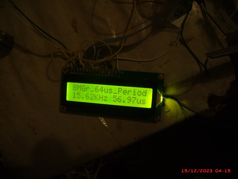

Good evening! I checked the operation of the oscilloscope using the example of a program with a PWM signal. Everything shows that there are some errors in what pulse length values are in the program and in real life, but overall a satisfactory result in the sense that when I tried to see the spi signal, but it was not visible, it means that it is, and not a measurement error. I will continue to solve the problem with the spi bus. When something appears, I will write.
