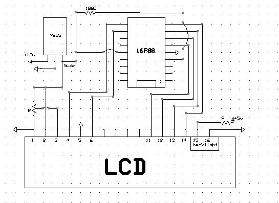

Here is a schematic...is this at least correct?
- 16f88 schematic
- schematic.JPG (34.68 KiB) Viewed 15481 times

Re: 1st project issue/LED-LCD
Sorry, but I don't know if that is wired correctly because I know nothing about the LCD module you are using.
If you just give me a list which says which pins of the '88 are connected to which pins of the LCD (e.g. A0 <-> RS), I'll write a quick sample porgram that should work for your hardware.
