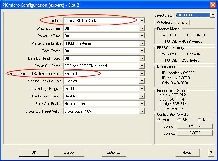

Thats how I got the 16f88 to work...tried the same thing with the 16f883 but no dice...why dont I have the "internal I/O" option under oscillators in the expert config with the 883? Im having to choose "internal rc" because thats the only internal option...im thinking thats the problem.

Re: 1st project issue/LED-LCD
Post by Steve »
See options below...
config 883.jpg (75.46 KiB) Viewed 18821 times
