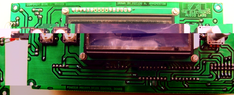

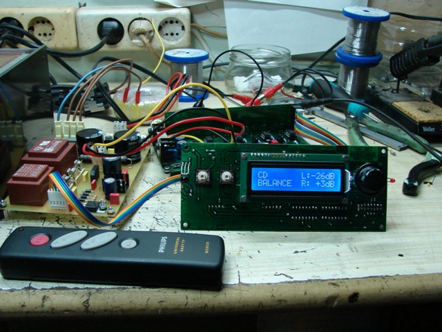

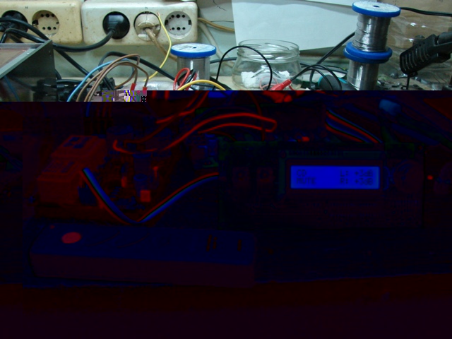

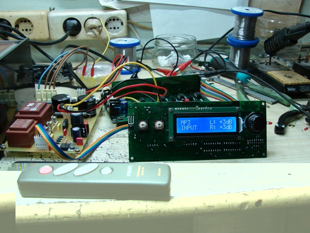

Hi to all of you, my good friends
After a long interval - we have big troubles here due to the famous Greek economic crisis - i came back. I completed the 2 main pcbs of preamplifier, it remains just one for the mounting of power supplies, i hope this week will be finished. Then i will have to modify a little the code and to do some audition tests and measurements of the final project. Pcbs are home made, i attach some pics. If you need advices of how you can make diy pcbs at home, please don't hesitate to ask me.
Thank you for your kindness and for your comprehension. I have not words to express my gratitude in all of you. I ask your forgiveness for my absence so long.
Fotis
Fotis
- PGA2310_pre4a.jpg (200.72 KiB) Viewed 24121 times
- PGA2310_pre3a.jpg (173.36 KiB) Viewed 24121 times
- PGA2310_pre2a.jpg (226.55 KiB) Viewed 24121 times

The project is finished and is working!
A summary of its properties:
1) This device is a complete high quality preamplifier managed either locally thru 2 push switches and a rotary encoder, or remotely by the use of a universal remote control handset compatible with the Philips RC5 protocol. It offers 5 Inputs, 1 Main Output and 1 Record (pre-Gain stage routed) Output. The functions included are the 7 basic: a)Power On/Stand By b) Mute c)Volume increment d)Volume decrement e)Balance f)Input selection in forward sequence and g)Input selection in backward sequence. All these functions are also supported by the remote control except the Balance.
2) The analog signal process is obtained thru a PGA2310 programmable volume control IC. Voltage gain can be adjusted from -95 up to +6dB in steps of 1dB (0.5dB step is supported by PGA2310 and will offered as an option later). The volume control IC is buffered from input and output devices (CD players, Power amplifiers etc.) thru four LME49710 operational amplifiers configured as voltage followers (i.e. their Voltage Gain = 1). That is because PGA2310 demands source impedance of less than 600Ω, unless its performance could be degraded. Additionally, the two output buffers protect PGA2310 outputs from - possible - overloading. High quality passive components are used in every stage. All resistors are Vishay Sfernice MRS25, while electrolytic capacitors are Panasonic Audio grade (ECA series). Foil capacitors are polypropylene WIMA MKP, while at the feedback loop of each LME49710 a Silver Mica compensation capacitor (not so much for its precision of +/-1% but for its nice "Sound Coloration") is used.
3) A separate power supply is used for the analog section. The operating voltage level is +/-15Vdc and is obtained thru two LM317 - LM337 adjustable voltage regulators that offer some better PSRR from the ordinary 7815 - 7915 fixed regulators.
4) Input selection and Output Mute functions are obtained with the use of high quality Latching relays. The Stand By function (i.e. enable – disable the analog power supply transformer) is also obtained with the use of a powerful SPNO / 10A Latching relay. Latching type relays combine both power saving and noise immunity on audio signal as their coils are inactive for most time. A momentary voltage pulse of 15ms is enough to change the location of their contacts.
5) The whole device is managed by a PIC16F887 microcontroller. The appropriate program code has been obtained with the use of the powerful Visual Programming Software FlowCode v5 of Matrix Multimedia.
Here some pictures showing its functionality

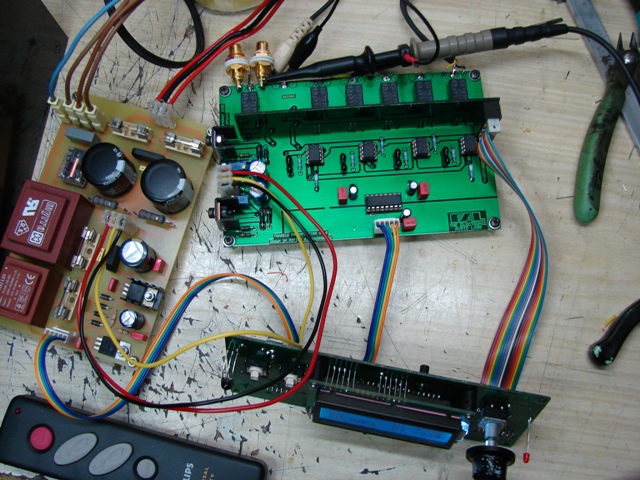

Here is a general view picture, and another one that shows the substance of this project:
You can see in the scope picture that the rise time is JUST 200nsec!
That means a frequency response of: BW=0.34/Tr = 0.34/200nsec = 1.7MHz! The overshoot is negligible, i can smooth it completelly by changing the 47pF compensation capacitors with 100pF, in the cost of a reduced GBW at 1MHz. Not so bad...
- PGA2310_5.jpg (98.92 KiB) Viewed 23396 times
- PGA2310_4.jpg (173.16 KiB) Viewed 23396 times
