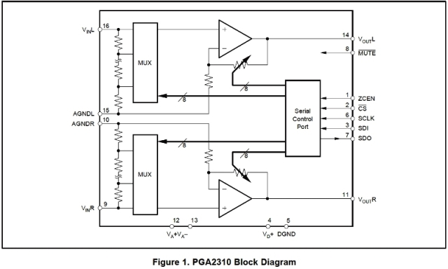

Let’s take a look on PGA2310 digital section (Figure 1). A lot of control and data ports are available making it very flexible. In the current project I make use of just 3 ports: a) SCLK (clock to synchronize PGA2310 with the host controller during data transmission), b) SDI (serial data input) and c) MUTE (active Low). The required serial data format is very simple: 16bit long, 8bits for each channel, b0 - b7 = L0 - L7 and b8 – b15 = R0 – R7 where L0 – L7 represents the Gain of Left channel and R0 – R7 the Gain of Right channel. There is no special demand for the serial clock (Figure 2); it can has a frequency from… 0 up to 6.25MHz and 80nsec minimum width for both Low and High semi periods; given this Hi and Low states of clock is not necessary to be equal. Serial data are transferred into PGA2310 registers during the rising edge of clock. Thanks to this simplicity there is no need of using any of the timer outputs of PIC; we simply have to set an output – that represents the synchronization clock - in Hi and Low state and to MASK sequentially one by one the 16 bits of two registers that hold a word of Gain data. Gain of each channel is set by an 8-bit code in straight binary format. The formula that gives the gain setting is: Gain (dB) = 31.5 – [ 0.5 X ( 255 – N) ] where N is the decimal equivalent of the existing 8-bit code. When N = 0 the internal logic circuit of PGA2310 recognizes a MUTE condition and connects its input multiplexer to analog GND. When N = 1 – 255 Gain takes a value within a range from -95.5dB up to +31.5dB. Inside the program only integer numbers are calculated while numbers with fractional part are rejected. Thus we have a numerical sequence of: -95, -94, -93… +30, +31dB. This simplifies the Gain calculation and printing on LCD display.
Looking at Flow Code control panel, we can see a 2 X 16 LCD display connected at port C.0 – C.5, two momentary switches PWRON/STBY and MUTE connected at port B.4and B.5 respectively. Flow Code does not offer rotary encoder unit, so it is simulated – I have seen enough members on the forum that use the same trick – with one momentary and one toggle switch. The toggle defines the direction (CW or CCW) and the momentary reproduces steps like an encoder. There are two square Led of which the green represents the relay that activates the analog power supply (in audio devices is mandatory the use of separate power supply for the analog section unless the noise of MCU oscillator could be pass into the audio signal path) and the red that simply indicates the MUTE state of PGA2310 (active LOW) so when Led is off means that MUTE is activated. There are another 3 round Led: The red is lit when device is in Stand-By mode. In digitally controlled audio devices stand-by means that the analog power supply is deactivated, while the digital supply remains active to keep the microcontroller running continuously. The green Led shows the serial clock Hi and Low state, and the blue one shows the serial data transmitted i.e. is lit when a transmitted bit is “1”. In the current project I have adopted the use of common type relays (non Latching) so the use of EEPROM is redundant. Let’s look at the Flow Code:

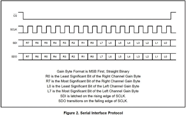

Inside the macro “SERIAL_OUT” the 8-bit code that holds the variable “counter” and which is the binary equivalent of the Gain setting, is transmitted in serial format thru Port RD.4 of micro which is directly connected to SDI of PGA2310. That is obtained by Masking one by one the 8 bits of “counter” in sequence, starting from the LSB. The result of each Mask operation is stored into variable “Serial”. Take a look on the Flow Chart of “SERIAL_OUT”: After the beginning, in the first Calculation “Serial = counter AND 0x01” the LSB of variable “counter” is checked and the result is stored into variable “Serial”. In the following Output icon the clock output RD.3 that is connected directly to SCLK of PGA2310 is set to Hi state. Then the PGA2310 input register is ready to receive the first transmitted bit. Next from this, the content of variable “Serial” is extracted to the serial output RD.4 for transmission. The following Delay of 10μsec keeps the clock output in Hi state for a while, so that reception of LSB from PGA2310 to be sure. In the next step, the clock Output is cleared (“Output 0D.3) and remains in Low state for 10μsec. After this, the second bit of “counter” is tested (“Serial = counter AND 0x02”) and the previously described steps are repeated until the extraction of the last bit of “counter” which is the MSB. Before the end of macro “SERIAL_OUT” the flag of variable “Counter_update” is cleared (=0) and the program Flow returns in the Main macro, at the Yes branch of Decision “If Counter_update?” and the Port interrupt is enabled again. Then, the Main Loop is reactivated and runs continuously waiting for the next interrupt request. At this point, a whole cycle of program, starting from an interrupt request, has been completed.
It should be noted that the given max clock frequency of PGA2310 is 6.25MHz resulting in a minimum period of 0.16μsec. In the current program, the two Delays of 10μsec placed after the Hi and Low states of serial clock combined with the time needed from MCU to complete the transmission of each one bit results in a sum of 22μsec as much or F = 45.4545KHz which is sufficiently fast for the current project and within the clock range of PGA2310. Another one issue is that in the PGA2310 datasheet is not expressly referred which bit is received first. From the timing figures, I can suppose that the reception sequence is bit0 first - bit16 last. Having this in my mind I did the development of macro “SERIAL_OUT” in which the LSB of “counter” is first transmitted. This can be confirmed only by testing the program on the actual project; unfortunately I haven’t in my hands a PGA2310, I hope that I will have money left over next month (that is the true Greek economic crisis) to buy a PGA2310, a rotary encoder and two LM4562 or four LME49710 to build a complete preamplifier.
By observing the blue Led, you can see the serial transmitted byte. Do the following: Select from “Project Options” menu a simulation speed of 20 and place on Variable window the variables: counter, GAIN_dB, Serial and Clock. Run the simulator. Press first the PWRON/STBY switch to enable the project. After the initial process the program returns in the Main Loop, while on the display is printed -95dB. While running the program, double click on the variable “counter” inside the Variables window. In the box that opens, you can change the “counter” value; print e.g. 180 and click OK. That is equal to -6dB of Gain. Press the STEP switch – for a while to take effect the interrupt because the speed of program is slow – and the “counter” will increment to 182. If you press again the STEP switch, the expected number of “counter” will be 184. Before this, make your calculation: N = 184 Gain (dB) = 192 – 184 / 2 = -4dB that will printed on display. With the help of windows calculator, make the following conversion: Print on calculator the decimal 184 and then select Binary; the result will be “10111000”. That means that the blue LED should be lit when the program Flow pass over the Calculation icons “Serial = counter AND 0x08” “Serial = counter AND 0x10”, “Serial = counter AND 0x20”, and “Serial = counter AND 0x80”. Press the STEP switch, and keep your eyes - big care needed – on the Flow Code red frame running over program icons. When it passes into the macro “COUNT”, press the PAUSE button of simulator. Now, by pressing the “Step Into” button (or F8 function key on your keyboard) once at a time, you will navigate step by step thru the Flow Code simulator in the current program sequence. Press again and again the “Step Into” and some time the program will enter in the macro “SERIAL_OUT”. Then, you have to observe if the blue Led lit on the correct Calculation icons described above. At the same time, you can observe and the green Led that simulates the clock output. Try it and with other values of “counter”, is wonderful to watch live a serial code transmission.
Of course, the macro “SERIAL_OUT” should be repeated and for the other channel. I will do this in the next part of article combined with Balance operation, Input select and remote control function. In this first part, we have built the main frame of project.

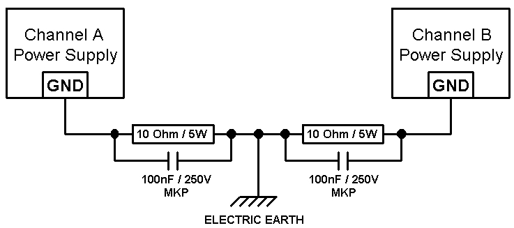

Galvanic isolation has to make with another very important thing. Ground loops and "hum noise". That is applicable mainly in devices with large voltage gain like power amplifiers (e.g. your amplifier of 300W has a voltage gain Av = 35 approx.) and phono preamplifiers (Av = 2000). Big power amplifiers are supplied from big transformers (300W per channel needs a 300VA mains x-former) and metal cases must be electrically earthed, so GND nodes of both channels should be connected to chassis. Signal GND should also be connected to chassis for good screening, but NOT at the same point with power supply GND. For this reason, the shield of input signal socket is soldered on PCB at the "clean GND" point, in some distance from the power supply "dirty GND" point.
There is no reason you do unnecessary expenses. You can use without fear a single metal enclosure for both channels in "dual - mono" configuration. There is a trick to separate the GND nodes of channels between them, using a R-C filter. I always use it, the same all DIYers and all serious constructors of Hi-End equipment. It is very effective. I attach a picture that shows the connections, the capacitor could be MKT (polyester) but a MKP (polypropylene) presents smoother absorption in current spikes and so it is strongly suggested. Please don't spend money for luxury axial MKP caps, economic MKP radial caps can do the job just fine.
Fotis

I see what your trying to do with the earthing arrangements for the amplifier, I think i've seen this done inside an external power supply for a Soundcraft mixing desk a while a go. Apparently it is bad practice to connect the PSU GND directly to the electrical earth because it can introduce noise in the audio circuit, dunno if that's true but I can understand what your doing to try and help isolate both amplifiers from each other.
Anyway i'm going to give that a try when i install both amps in the enclosure.
