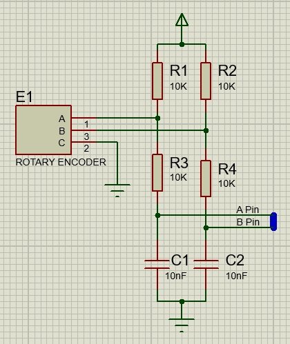

Assuming it's a quadrature encoder there is a component to help you with this.
This wiki page has examples you can refer to.
https://www.flowcode.co.uk/wiki/index.ph ... :_General)
Here is a basic schematic for wiring the encoder to the micro to provide a bit of filtering.
Edit, sorry I got the circuit a bit wrong so now showing the corrected version which I've also put onto the wiki page.

I have used the examples given in the WiKi and they work fine for almost all generic rotary encoders I tried. I can't remember off hand, but there were three examples and all three worked, but one I needed to "jigger" with, but I'm putting that down to me.
You can easily test these components by using a simple multimeter to check for make/break connections as you rotate. If you bought "Cheaply from China" then it's a good idea to verify they actually work before you try to decode them.
As Ben mentions above, you can see a lot of noise as they transition so take that into account before deciding the component is broken or doesn't work. I used the "CfC" ones just to prove a concept then discarded them from project due to build quality.
You mentioned in a previous post you had access to a scope. You might want to scope the outputs as you rotate with and without Ben's circuit. I find that if I can "see" what's happening physically I can understand the code needed better.
