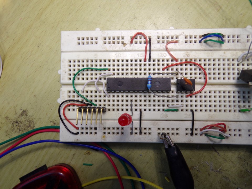

Re: MCP41010 Digital Pot
Hello folks... well -it's now 2022... and in November.. so I have not been on the forums for ages.. I decided the other day .. to revisit the MCP41XXX component.. hoping that it would now be working.. I have FLOWCODE 8 (8.2.2.15) ..
I have tried all sorts of processors.. I have even tried different MCP41100 chips ,, lest one be faulty.. BUT to my dismay.. It seems that the MCP / PIC chip combination I have.. does not want to function at all.. presently I have a PIC16F1936 with a MCP41100 microchip digital pot.. I have the default pin connections.. as suggested in both FLOWCODE and by the manufacturer data sheet.. I have tried all the little test programs... BUT I cannot get anything to function correctly.!!??
CAn anyone - please enlighten me... as to what I maybe doing incorrectly... or which magic wand do I have to wave... to get this to function..
I am initializing the MCP.. I then have a loop with a 1 second delay ... in which I write to the MCP with .. setwiper(0.TAPS.0) - wherein TAPS is incremented by say 10 per loop. I would then expect the outputs on pins 5,6,7 to start to vary... BUT alas.. they stay at ... 50 K... each leg..
SO... can anyone please help.??
I then also have a QUAD encoder .. with two wires - so called A .. and B.. which I have connected to the processor with default pins.. namely B0 and B1.. and then also I was hoping to see my variable change with pulses... BUT ... also alas... NOT WORKING..??
So it's 2022 - November - and I was expecting to see a working system...
I also have loaded FLOWCODE 9 - and tried unsuccessfully with FLOWCODE 9.. to try the same hardware..?? BUT FLOWCODE 9 does not work either...
PLEASE..?? can someone help me to get these little things to work...
I take it - that ... my PICKIT 3 ... programmer is working correctly... maybe that is faulty... can anyone suggest a way to definitely test my PICKIT 3..?? so that I can definitely not include that as a problem.!!!
Thanks be to anyone... who can tell me what is wrong.. what to do.. I await any help or comments....
Hello there - okay I will ... just also found out that I can hopefully use my PICKIT3... programmer as a logic analyzer..
I gonna try that then also to see what pulses are going around...
Then.. I also wanted to say that.. I got.. the MCP chip right next to the 1936 chip.. and the wires to the MCP chip are very very short... with a 100 nfd cap right over the MCP chip..!!
the flowcode program is very basic.. do not worry about the other macros... they would be for other "stuff" once the MCP loop works..!!
Thanks very much..!!

Your loop that increments the wiper simulates OK for me, suggesting a possible config / hardware issue.
I notice that despite your C-Block stating you are running at 32MHz in reality you are only running at 1MHz, which is rather low. I would speed up the chip to something more realistic and create a one-second flasher to check speeds are correct.
I'd perhaps try running at 8MHz as a start
C-Code = OSCCON = 0x70;
and remember to set Clock speed to 8MHz in Project Options as this defines all delay related timings.
I modified your file to run at 8MHz.
- PIC16F1936-MCP41100-test-software-MK3-Flowcode-V8.2.2.15_8MHz.fcfx
- (22.72 KiB) Downloaded 899 times
Hello there... so yeah - i have tried all sorts of things to get this to work... It also works in my simulation mode... It's just a pity that it do not work in real life...!!!
So it is also amazing that NONE of MatrixTsl staffers have voluteered a solution...????
You know it's 2022... and one would expect that if a system like FLOWCODE was written... and a component like the MCP41100 or MCP41010 was written... that it would ACTUALLY work..????.. before it was launched off.!!! to the public...
I also have a QUAD ENCODER ... gadget that I would like to get to work...!!! AND IT ALSO does not work...!!! as it should...!!
I have tried various other gadgets... and some of them work... and some of them do not.!!
I wonder if this whole thing is really OS dependent... like ... that maybe microsoft... in their wisdom.. have written flowcode out the system..???
Can you not build the little circuit... maybe you can get a MCP41010 chippy.. and actually build the circuit on a breadboard... and see that it does not work either...??? then there are at least two of us .. that can say / report that the MCP component does not work.!!!
FLOWCODE is a marvelous idea... cause it was written with the complete amateur in mind... the complete WHIZZ-KID ... who has not got the time to waste to study C-coding.. BUT WANTS to make this "thing" he thought about.... so he uses FLOWCODE so that he/she does not have to waste time in thinking about the software.. BUT rather spend that time in thoughts about what's going to happen next in his project.!!!.. so FLOWCODE is a MAGIC system... IF IT WORKS.!!! GEE... I wish someone at MatrixTsl would own up and demand time to FIX all the badly written components..!!! It would make such a difference to the monthly BOTTOM LINE... and popularity would SOAR.!!!..
BTW - I am trying out FLOWCODE 9... OH what a disastrous front end...!!!!.. I really think that something went wrong... there... FLOWCODE 8 human interface is SO MUCH BETTER.!!!!.. hmmm ...
LET us see is Pete Smart will help me... all the way from Aus...??? PLEASE HELP... PETE..???

Did you try making the changes I suggested including trying the one-second flasher? That would rule out timing issues and confirm you are downloading correctly. Always a good start.
Do you have access to a scope or a logic analyser? Connecting to the ports would enable you to see exactly what is happening to aid diagnostics. The uC alone should show pin activity even with just your wiper loop and no physical connection to the Pot. Are you getting activity? If so what happens when you connect the Pot? Scope / Analyser traces on pins would be very helpful.
It's bit unfair to heavily criticise the Matrix team as your post is only three days old..... Support is free and obviously dependent on their available time. However the forums usually are quite helpful with members offering support where they can.
I don't have the Pot and see no real need to spend on one to assist, as you can buy a cheapo analyser for less than it would cost me to buy a chip and it would serve you better. Farnell / RS etc have the chip in stock but by the time handling and postage is applied it's around £13 to £15. Happy for you to send me one though
An analyser for hobby use is under a tenner here https://hobbycomponents.com/testing/243 ... c-analyser
If you are not getting sensible activity on the Ports then it may well be a FC component issue. These things happen and are usually resolved quickly when brought to the teams attention.
Edit
PS I do have rotary encoders and have used them successfully in v9. The examples worked for me.

Hello Steve.. okay so I spent the Saturday morning.. rebuilding only the MCP41100 chippy onto a breadboard.. and attempting to use the MCP41XXX component...
I retried both in Flowcode 8 and then on Flowcode 9... (also I downloaded the new version of Flowcode 9 - and it installed itself. I also did the needed updates..).
So I have a picture of the build .. and then of course the FCFX file as well... the file is for Flowcode 9... per se..
I think that the pic of the breadboard is pretty easy to see.. how I have wired the processor chip - PIC18F26K22 ... and then the 8 pin MCP41100 I have into the circuit..
I used a scope to look see what signals are coming out the chip / going into the chip.. and there is NOTHING / NADER / NIKS ... waveforms..
I really am at a loss here... maybe all the binaries I have ... have been "doctored" / fixed... so that my flowcodes .. both 8 and 9 are all messed up... so that nothing will work..????
If you get stuff to work... PLEASE..?? can you RAR your flowcode install files - and somehow we can try to access them them from you...
I HAVE NO - email address that is NOT HACKED to DEATH...by this AF ..INDIVIDUAL here in south africa... thanks... but can call Alfie Dobson...and we could try arrange something.. that can get the files... without "THE WORLD" hacking into the files and destroying them before I get them.!!!
I am quite worried that I cannot get ANYTHING to work... I have a lot of other components - that do not work either...!!!
thanks Steve - and others.. I will be watching this space...
PLEASE TELL ME - I MADE a STUPID MISTAKE.... I wish that all it is.!!!!
the breadboard is powered from a 5V supply which I made up .. which attaches to the ends of the breadboard..It is a simple LT1076 switch mode supply with a pot for adjusting the voltage onto the side rails..
The code which you posted simulates fine with me which pretty much negates the theory of your PC /OS / FC having been "doctored", so I think we can safely rule that out.
Visually I can't tell much about your breadboard rails.
They appear to be twin rails at top and bottom of your picture grouped into blocks of five. However I am unsure if neighbouring blocks are interconnected but notice that blocks five and six (counting from left) are jumpered together which would perhaps suggest that the blocks are not interconnected. Could that be an issue?
Assuming the rails are continuous, irrespective of whether the Pot is responding, your LED should still flash. You don't mention it in your post.
Have you checked that rails are continuous and power is going to where it should? If so I'd perhaps then confirm you are actually programming the chip.
Hope this helps.
Hope this helps.
Hello there squire - chipfryer ... yeah.. indeed ... as I stated - the +5V and 0V rails are all joined .. for the length of the run of the breadboard..
I have as you see in the flowchart.. put a LED out to flash for 1 second on and 1 second off.. which it does...
After programming the chip.. I switch off - and then on again... and connect the PICKIT3 gadget.. and then ... like do a software verification... of the software in the chip itself... and everything seems to verify OK.!!
I think it's either a good virus - or it's a binary .. that is not 'kosher' ...?? OR as I suspect... all along... the actual component - has never worked .. ever correctly....!!!
I even tried this in FLOWCODE 9 ... and even after a 'huge'..?? - update...!!! and ..IT STILL DO NOT WORK.!!!!
I hope that Steve from MatrixTsl..... picks up on this, and then he can get Ben Rowland .. or someone to actually fix the component - until it works...!! or tell us... why it ain't working.!!??
I tell you what ... if you could afford to borrow / beg / obtain...?? a MCP41100 ... 8 pin chippy somewhere... and actually try / test the MCP4XXX component... and find it working / not working... it would be FANTASTIC... cause then we could really start getting to somewhere...??
surely... it's not that difficult... out here in the sticks of the world at the southern tip of Africa.. I call online to RS online... and order ... ?? I know I have to wait about 10 days.. BUT most times I get what I need.. that way... WOW...!!..
Okay squire - chipfryer ... thanks for your help / input... let's hope Matrix can shed some light on this problem.. BOTH flowcode 8 and flowcode 9 ... does not work.!!???

I agree... about a breadboard being dodgy.!! ABSOLUTELY 100% agree.. so I made up a PCB with a MCP41XXX on it and a very modern chip like a PIC16F15345.!!! on board... BUT IT STILL DOES NOT WORK.!!!
