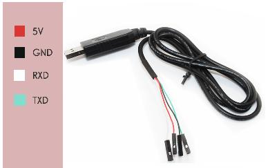

Martin as I was typing this message and I'm a 2 finger typer the cable has arrived.
ODD there is no manual with it ???
Color wires are ( White ) (Red) ( Green ) ( Black )
John
I was sure there must be a better way to address the Timing. Excellent knowledge.
Yes you might find the RA settings in some of the other and they were just to give me a glimmer in how this mystery PIC works or in my case not work.
I really appreciate your time and energy.
John

Re: URGENT help on PIC16F1827
I think I found the wire label.
Do you think this is correct
RED = 5 Volts
Black = GRD
White = RXD
Grenn - TXD
Now in our case we will be using
RED - connect to 5 Volts
Black - connect to GRD
Green - for TXD to the USB connected to the Laptop
John
RED = 5 Volts
Black = GRD
White = RXD
Grenn - TXD
John

Your welcome John.
Not using any other colours.
White is because Host TTL to USB adaptor is plugged into is Receiving RS233 (not transmitting)
Did you receive a drivers disk as well for TTL to usb adaptor?

You will be using Black for GND and White RA1JLeith wrote:Color wires are ( White ) (Red) ( Green ) ( Black )

kersing
- Posts: 2045
- Location: Netherlands
- Has thanked: 553 times
- Been thanked: 1081 times
John,
I would not connect the 5V to your circuit. It is usually an output from the PC (the USB bus carries 5V to power devices) and you project has its own power. If you have a multi meter available you check it there is a voltage if you just connect the USB plug to you computer and nothing (besides the multi meter) to the wires.
Jac
Jac

No driver disk. I will check with the supplier maybe it is a stand alone download.Did you receive a drivers disk as well for TTL to usb adaptor?

Drivers need to create a VCP (Virtual Com Port)
I have two TTL to USB converters here.
One shows this: The other TTL to USB shows this: Is sounds to me like either correct drivers for your device are not installed or the VCP part is not installed?
- Posts: 9521
- Has thanked: 2585 times
- Been thanked: 3815 times
I just think you have been sent the wrong drivers?
I will have a search.
- Posts: 9521
Thats Great!
So the web site I pm'd to you that contained drivers was correct
You need to follow what I posted about setting up hyperterminal with Connect using: set at Com4
Next you need to load attached hex file into your programmer and program 16F1827
Connect Black lead to GND and RXD (White) to Port A1
If all is working, you should see text and values within hyperterminal window,
