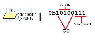

Here is what I have
I tried the 10K and played with the Wpub with all ( 1 ) and ( 0 ). Still can't get the Breadboard to work as the Flowcode so smooth on the Flowcode.
On the Breadboard all Port D display can't get only ( 1 ) Port D to display like the Flowcode action
John

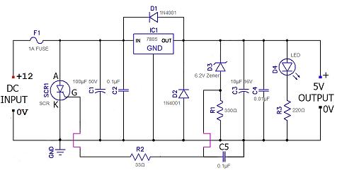

I have to match the power systems.
The main control panel runs on 12 volts when it sends out the Port B ( Ground ) and the Port C 0 ( +12 converted down to 4.2v )
Martin have you ever used this design
I would get the + 12 from the Main control board and this would then match the Ground returns.
Let me know if this is a good design to get the + 12 down so I can use it on the PIC16F1937. Then I will go and get the LM7805
John

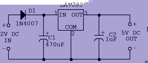

More research and I found one that has a stable output and protection
Your thoughts
7805 1AMP.jpg (17.74 KiB) Viewed 19491 times
John

Re protection:
I personally believe it's a bit over the top, but its your build and you go with your preference.
I have never had an issue when 12V or higher going into a 5V regulator has caused any issue with more than 5V at the regulator output.

JLeith wrote: More research and I found one that has a stable output and protection
Your thoughts
Not been on here for a few days missed your post the first time have you seen these regulators ? bit more expensive more efficient and less of a risk of overvoltage on a failure also has output protection and filter caps internal to the device
Not a lover of "crowbar circuits"
Steve

Well I figured out what was causing the Port B issue. I was picking off the input on the back side of a LED Bar that I was using for confirming the A - G leads. I guess the ground was not not going low enough to read it.
On my very first go I was using a push button to trigger the port B and didn't drive it from the display.

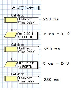

Now I have all the Port B active I'm only seeing 1 Port D active. I'm using a LED bar to read Port D.
Example on Port B it will receive a display every 250 MS
Display 1.jpg (22.93 KiB) Viewed 19409 times
When I send in this case ( Ball 1 )
Steps
1. C0 active send B2
2. C0 active send B3
I only see D3 active
I think we need to look at the timing loop for Version 6C
It looks like it is seeing the step 2 but not activating to step 1

I took the Loop for C detection to 1 from 66
And in the return Main I took out the 500 ms on ( Status = 1)
I can get the D2 + D3 on the first power up.
Martin do we need to change the flow to read C then read B where in fact both will be present if it is for this display.
Opps -- Port B is the trigger
I guess we need a faster determination if a C0 has arrived and after say 100ms C has to be their because if it is for that display the C came in with the B interrupt.
The loop has to be ready for the next servo action in the 250ms that the control board will be sending it.
Martin a few weeks back I sent you the Control board flowcode so you could you the digital scope to read the C and B timing ?
Maybe the control board needs to be a longer delay before sending out the next servo to be activated or deactivated.
Not sure how fast the 7 segment is being sent
Segment breakdown.jpg (7.57 KiB) Viewed 19409 times
Martin we will need your digital scope to help determine how fast the 8 bits are sent so we can detect it for the servo PIC
