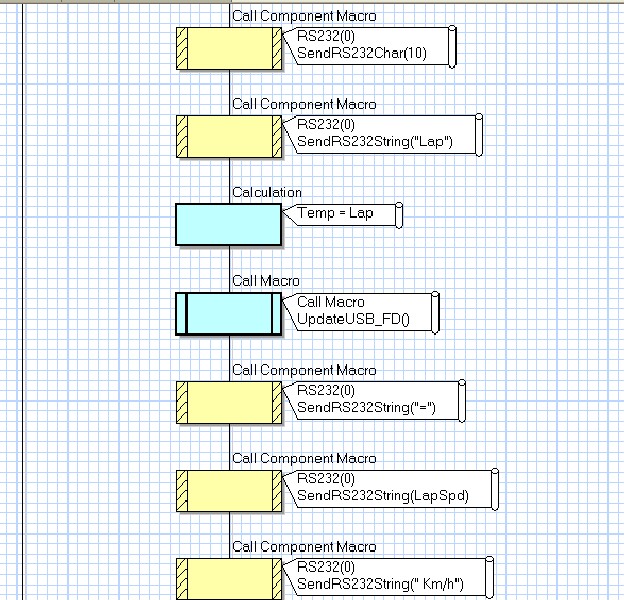

Re: Help needed!
Hi Martin,
I finally got the second Vdrive2 for my second Time keeper unit. It helped me a lot when you adviced me by the FB how to implement the Vdrive.
I made this very first file with USB stick with decimal place and I got this:
Lap=533.3 Km/h
Lap=278.6 Km/h
Lap=327.8 Km/h
Lap=323.1 Km/h
Lap=310.0 Km/h
Lap=276.9 Km/h
Lap=246.7 Km/h
Lap=268.0 Km/h
Lap=262.7 Km/h
Lap=272.5 Km/h
AveSpeed 310.0 Km/h
Lap numbers are missing so how to get them visible?
In the simulation mode everything seems to be OK but in a real world I can’t get Lap numbers visible.
I tried to put these blocks which were in a earlier version. I did get lap number but couldn’t get average speed visible correct.
jjw

Re: Help needed!
Hi jjw,
There are three Mods you need to do(in Blue).
1) 2) 3) After doing those mods, can you let me know it it works please?

Hi jjw,
Can you edit the calculation box just above the Call macro Voltmeter from
to
Then let be know if working better.
I suspect during tests the timeout function is kicking in which is causing the issue.
That means detection has not been triggered.
The is there becuse time out occours if speed is greater 7200.
This is checked within the timer interrupt which is running all the time.
After a timeout, the speed is still greater then 7200 since only Timeout is reset.
So when the button is pressed, there is an instant timeout again!
Hence you don't think the button is starting it running again.
Can you see how it goes after adding extra line of code.
It maybe a good idea to add a time out LED or display indication so you know when triggering was an issue.
Can you give that a go as it should be straight forward.
I believe I know what going on.jjw wrote:Sometimes it takes some three pushes until it goes into the measuring mode.
