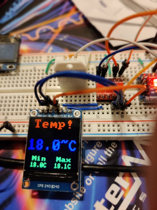

Something odd that it's not starting reliably for you.. Seems rock solid on a Nano... I did a quick thermometer with a DHT22 - but missed on the 'degrees' symbol.
st7789.fcfx
(98.74 KiB) Downloaded 508 times
Just with temp added (DHT22 on d2) - still displays rainbow, lines and text before swapping to this display...

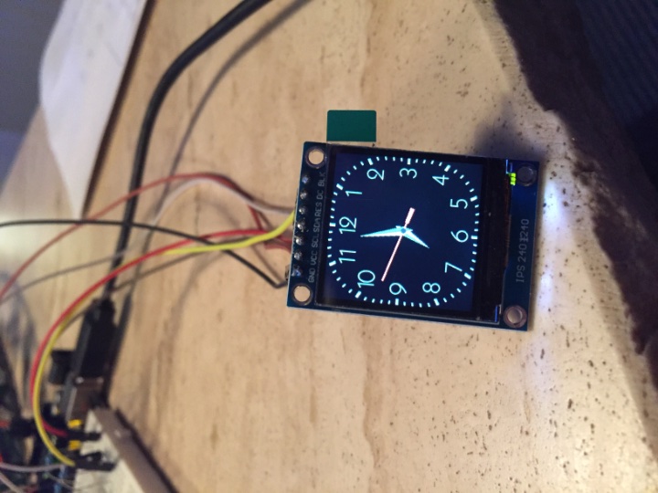

No unfortunately no progress here. I have tried several times with the same configuration and pin connections. I have checked these several times. I have not been able to watch ABCDEFGH again. But I can see sometimes I upload it is like I still see some of the previous text from the test with the thermometer. from IDE. Could there be something with the initialization.
Here is another funny project with a clock and rtc. Arduino IDE, it works without problems every time. Hope you can find out something, would rather use FC8 and create my own project :wink:
