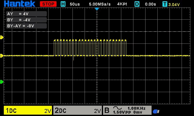

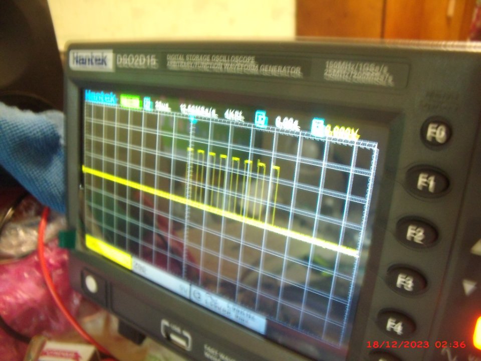

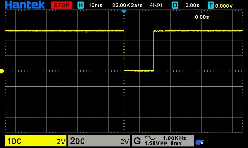

The screen from the oscilloscope screen did not fit. I had to take pictures, for some reason the screen is saved on a flash drive.

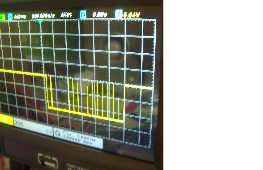

Good evening! He is especially kind today! It turned out to send the number "13" over the spi bus. The graphs turned out to be so-so-I had to catch them with a camera, for some reason the waveform drawings are not saved on the flash drive. It turned out that there is a menu in the settings of the spi module where you need to select "soft". And then it turned out to send. Now I will work on getting the data.

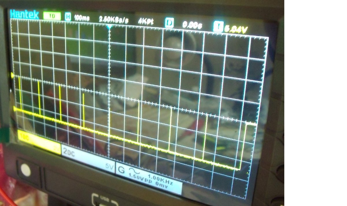

An addition to the previous message. When sending data over the spi bus via an interrupt, the "clk" and "mosi" signals match the signals from the previous messages, and the signal from the ss output is different.

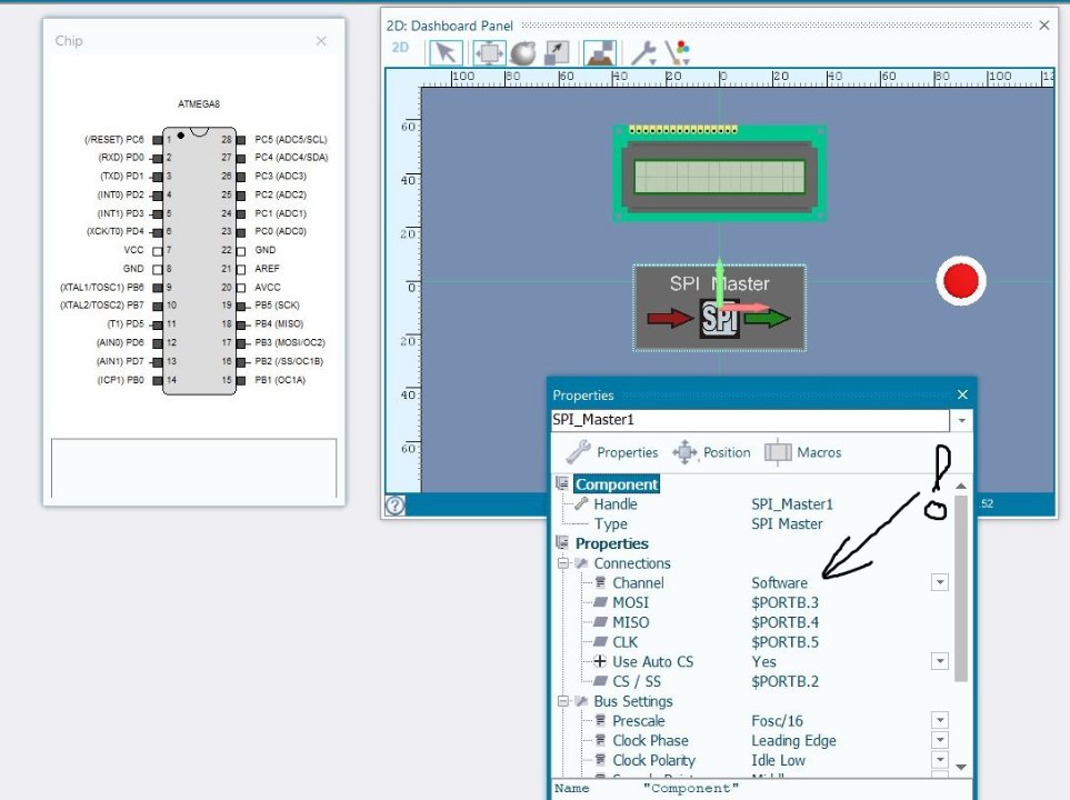

Good afternoon! I have now tried the option of receiving data over the spi bus without interruption. Unfortunately, there are no changes yet on the lcd1602 indicator of the receiving controller. It turned out to take better pictures of signal voltages, only the signal from MOSI was poorly caught and turned out to be a little different. I will continue further.
CS or SS.jpg (54.43 KiB) Viewed 3577187 times
Spi_GetByte.fcfx
(11.22 KiB) Downloaded 63369 times
test_send_spi_push_momentary_8MGr_soft.fcfx
(12.31 KiB) Downloaded 63408 times

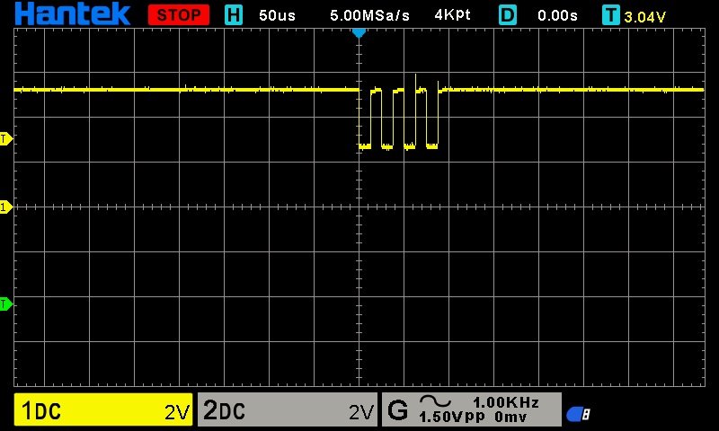

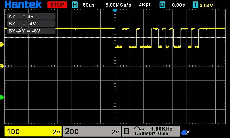

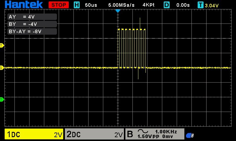

Screenshots of CLK and MOSI signals.
Posts: 786
Joined: Fri Jun 06, 2014 3:53 pm
Has thanked: 187 times
Been thanked: 205 times
Re: some problems with spi data transmission
Post by chipfryer27 »
Your two traces look as expected.
However without any form of interrupt it will be practically impossible to capture any received byte as without such you are relying on nothing more than pure chance that something will be present when you look (including clock). If you do manage, can you please pick me some numbers for next week's lottery too ? :lol:
Remember that data is clocked in and out and some devices also require CS/SS to go high before "actioning".

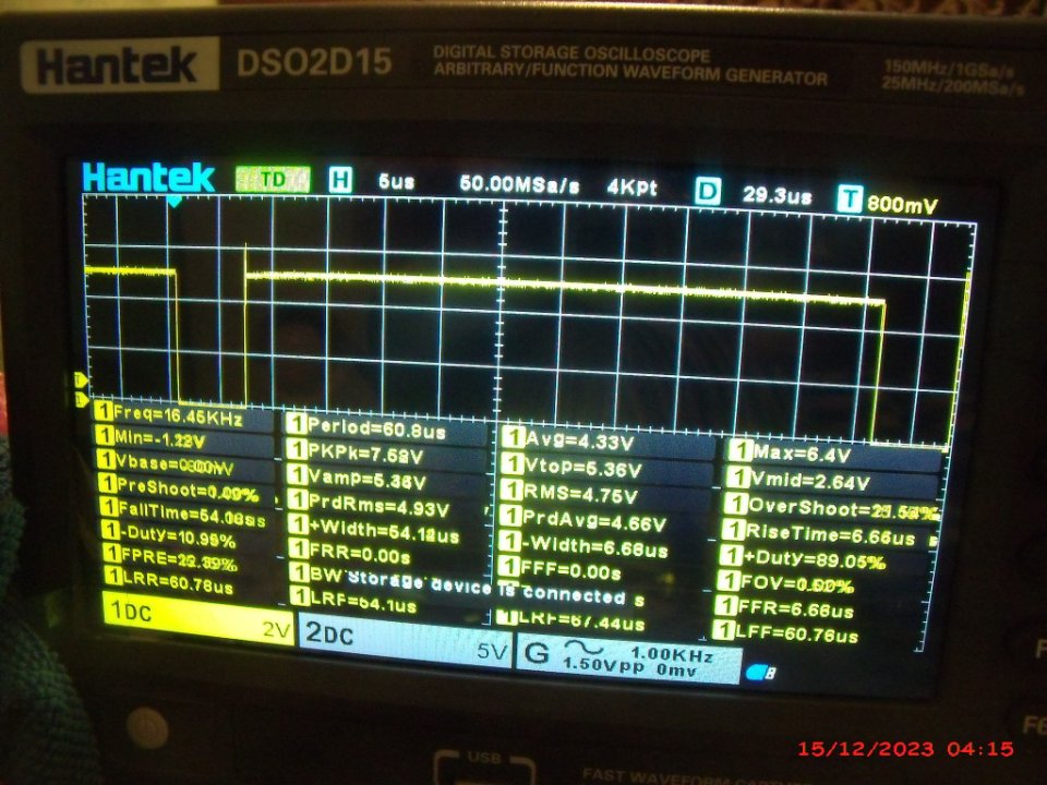

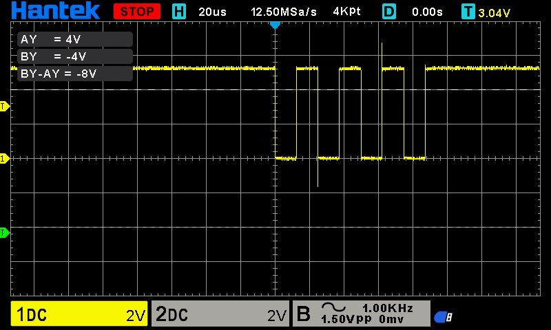

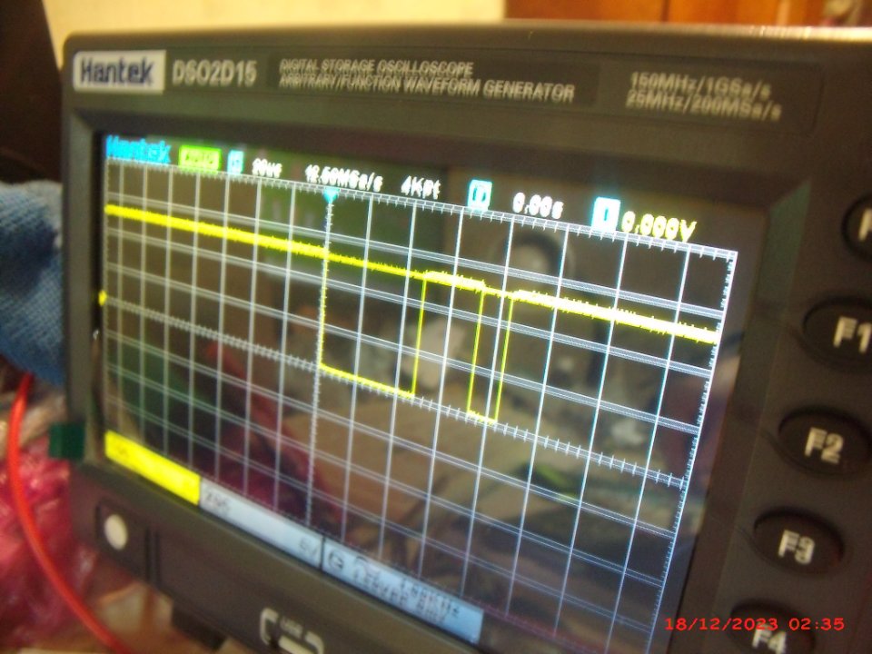

Good evening! I tried to receive data using a program where there is an interrupt and it starts with a falling edge. Unfortunately, there are no positive results. No numbers appeared on the indicator connected to the receiving controller. I have identified a feature when two wizards are used-they both send data from the MISO pins and there are synchronization signals on both controllers. When the controllers are connected to each other, the signals "stack up". View the attached files. To clarify, 1 controller is transmitting, 2 is receiving. File signature.

Continuation of the screenshot from the screen.
MISO-2 atmega8.jpg (59.88 KiB) Viewed 3576463 times
clk 2 atmega8.jpg (59.99 KiB) Viewed 3576463 times

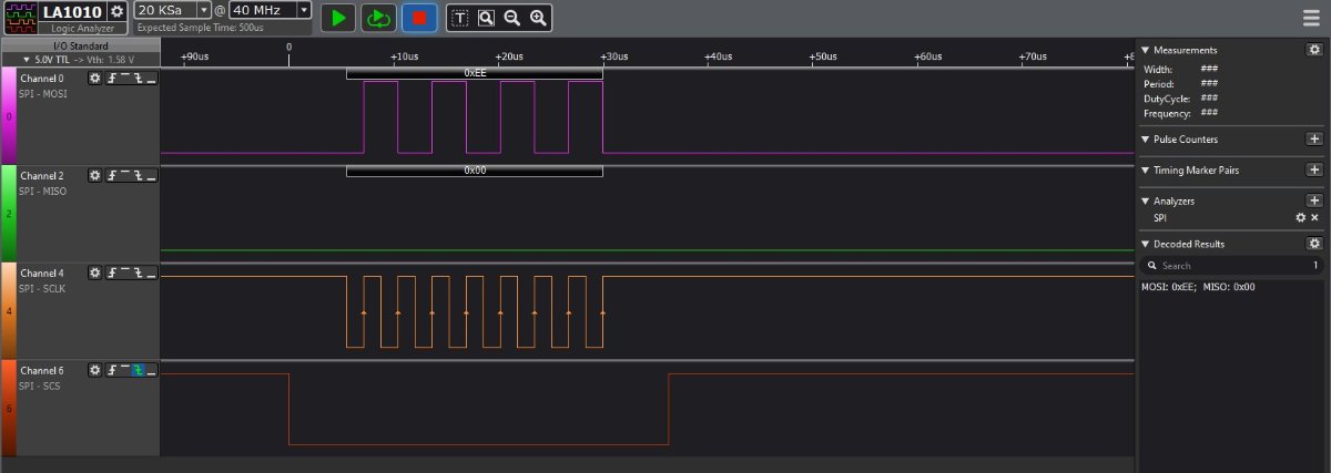

I created a simple chart to send a single value out on the SPI.
Chart uses SPI Master component and has
C5 = MOSI
C4 = MISO
C3 = Clock
C2 = CS/SS
Clock idles high and CS/SS is active low.
The below shows the traces captured on a logic analyser set to trigger on CS falling edge.
I'll create a chart for MISO when I get a chance.
PS
Forgot to show in above, the time from CS/SS going Low to MOSI starting is approximately 7.5uS (chip is running at 19.xxxMHz with SPI Prescaler set to Fosc / 64).
