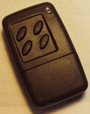

The Remote came with a remote control kit from a manufacturer called Analog Metric. They have a website (http://www.analogmetric.com) and if you type "ir remote" in the search bar it will show 3 different kits that can be purchased. The 3 are essentially the same with different options but the main PCB in both kits are exactly the same. The instruction manual does say that the remote uses RC-5 commands. I have also noticed that the address numbers change every time I go to initialize remote setup and not press any button on my remote handset, the display will usually show address 125, 65 or 61 when I go to the set up menu. I have tried using another IR receiver for the preamp just in case I have bought a faulty receiver but I end up with the same problem
I will try and find a different remote, I'm sure I have one of those "One For All" remotes some where in the house :) so I might try it and use the codes in the instructions for philips devices

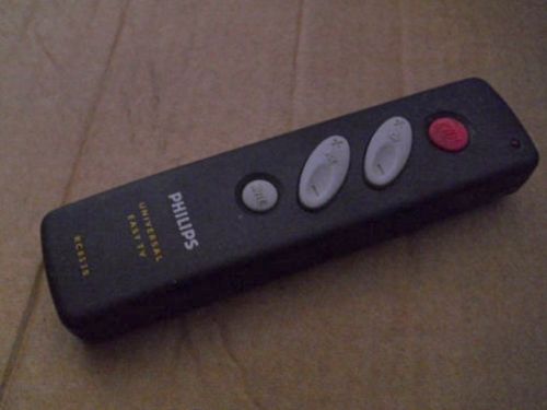

The upgraded fcf file that i posted is obtained with FC v4. Not with FC v5! Why you don't try with the current version of FlowCode that you own? It took me one day to write again the fcf in v4 because "Stanga" asked me it and i knew that you have only the FCv4 full working. Oh Phil! Please make your life easy :)
How is going with the remote control that you own? I have seen the kits in the web link you posted. Made in Hong Kong. You should believe just the half of those they refer :wink:
BTW, i have tried 3 universal remote controls with success. One of them i built by alone, using the Philips SAA3010 to transmit in address "16". The other is a Philips RC8530 and the third is a cheap that i bought from a kiosk for 3 Euros but works! Though not so good like the other two. I attach pictures.
Philips RC8530.jpg (17.99 KiB) Viewed 22110 times

I hope you will solve the problem of your Laptop ASAP. Regarding remote control issues and according to the message you receive "NO SIGNAL" i can think just two cases:
1) No one of your remote controls transmit in RC-5. By any way, when no signal received the program stores in the EEPROM of micro the address "0" which is the most common. Is the TV address code.
2) Perhaps you do something wrong during set-up. I repeat the correct way: Turn on the power and immediately press the MUTE button on micro PCB. When "INITIALISE REMOTE CONTROL" appears on display, press FIRMLY the MUTE button on remote control handset until you will see "ADDRESS = XX" on display. Only after this message you can release the button pressed.

I think it's safe to say that the remote handsets I'm using aren't transmitting RC-5 comands. Are you familiar with those "One For All" handsets? You can control many devices from one remote - if you want to use it for controlling a tv you have to press the TV button and then press "Magic" type in a code which is in the instructions. Once typed in it stores the code in it's memory. If I were to type in a code so that it works with a philips device, do you think that it will transmit RC-5 commands?
Phil

I don't know for the "Magic", i have to study in detail. Instead those, i have to propose you this one for which I know that can do the job:
http://www.ebay.co.uk/itm/Philips-SRU30 ... 2eaee37f90
Buy it! Is Philips, is cheap and the seller is UK based, so you have to pay just 1.95 Pounds for P&PP.

Thanks for finding that philips remote on ebay. I will be buying that as it's a philips device and so should work with this project. I will also be trying a "One For All" remote because I've found my one earlier this evening. I need to find the instructions for it although I could most probably find it on the internet. I will let you know if it works or not.
BTW I've also discovered this evening on the internet that a SKY+ remote can be set up to send RC-5 commands :)

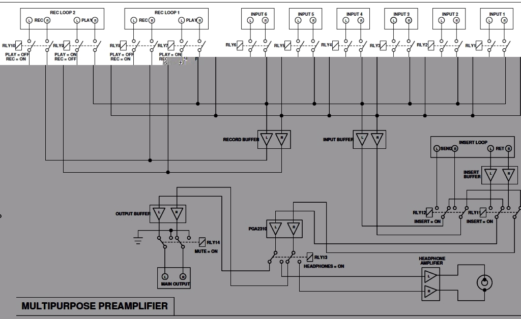

Phil here's one - in my opinion - good block diagram on which we will work. Includes everything you wanted plus a headphone amplifier. It is based on my long experience with professional mixing desks.
14 relays and 4 dual operational amplifiers needed. If you like to add or move something, please tell me your opinion. Any advice from other people will be also welcomed.

Hi Fotis,
The layout of your block diagram is exactly what I'm looking for. I like the Idea of having a relay to send the audio signal to the headphone amplifier. Will this relay be controlled via the MCU? if so it could be possible to have the display print "Headphones" on the bottom left corner when they are plugged in. I might be able to do that bit myself with the help of FC4 or FC5. I had thought about building a headphone amplifier into this preamp project as I have a nice circuit that I built some time ago and sounded excellent. I was also going to add a small circuit into the preamp that will switch off my power amplifier when a pair of headphones are connected into the headphone socket. As far as the REC OUT relays and INSERT LOOP relays are concerned, they don't need to be operated via the remote handset, it would be nice if they were but not essential.
I don't think i would need to add anything extra to your block diagram as it has covered exactly what I wanted :) nice work :D but I would move the MUTE relay so that it can work with either the headphones or the preamp output, at the moment the MUTE relay only works on the preamp output (if you see what I mean) and also move the output buffer amp so that its connected after the PGA2310. So in other words - PGA2310 output goes to the output buffer amp, from there it goes to the MUTE relay and from the MUTE relay to the HEADPHONES ON relay. If you see a potential problem with my change then let me know. I would like to ask, will connecting a graphic eq into the INSERT LOOP overload the PGA2310 input? My graphic does have level adjustments on it
I have also found a nice 24bit/192Khz DAC to install inside this project once it has been finished. It has 3 inputs - USB, Optical and Coaxial. I was thinking of making my own but I've seen plenty of kits available that will probably do the job quite nicely.
