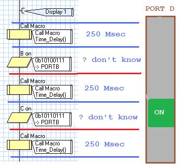

I'm getting lost on the timing without knowing how fast the Port B interrupt and the Port C detect needs. I do know it has 250 msec to detect Port B and check Port C and be ready do do it again.
If a digit display of ( 8 ) there could be eight port B triggers.
Here is how I tested the Control Unit to ensure the sequence was correct. I did find a few missing segments
I had to use 3 breadboards and a 16 relays and now with you kind help moving the actions of the SCR and relays into PIC16F1937 Here is what I see in the Port B for Digit 1
I hoe this helps I will stop playing around with the timing until I hear back from your thoughts

Thank you for you time
I did some searching in Flowcode for conversations on Servo control and I was reading something I believe you posted in 2011 a PDF

- Timing for Port D.jpg (30.71 KiB) Viewed 19377 times

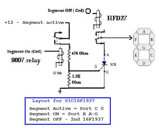

Looking at your hardware circuit, you wont need an SCR if you use a double pole relay
You can use the other pole to latch relay.

For the SCR circuit it is on the dust shelf it was a theory test to confirm if my design for the Control board really did work because I never did get 100% satisfaction on the Elector- Mechanical flip digits. I did find some missing segments in the Inning display when It reached 9 innings and pressed inning again it when to Inning 2.
It was a real mess with 40 breadboard jumpers and my main task was keeping everything straight.

I hope the weather is good for you son's visit. The rain and wind is starting up for our November weather of rain and more rain.
Rain today means I can do more computer work.
I very happy going down the PIC road it will save a lot of relay's

Here is a picture
I hope I have this correct. I lost all my drawings on the PC crash
In the info I think it would read.
RB0 high to low and A4 Low to High then the servo 0 - 90 deg. ( ON State )
2 pic RB0 high to low and A4 Low to High then the servo 90 - 0 deg ( Off State )
The Port D connection to the servo will only receive a ON state and then in the sequence for digits it will receive a Off State.
At no time will a port d be sending out a ON and OFF at the same time.
The A4 is common for PIC 1 & Pic 2
RB 0 - 7 is separate for PIC 1 & Pic 2. Each Port B is either a ON Action or OFF action.
The state for Port A and Port B is from a open state to either a GRD for Port B and Port A4 is open to + 5
Might I need a reference state at the Port B to as resistor with + 5 to detect the Ground state ? and the Same for A4 to be a gound state so it can detect the + 5.
I guess I can send a + 5 on the Port B if this would make it easier to work.
Before in the old mechanical state the Ground on Port B related to the + 5 on A4 to operate. Now they are separate detection states on the PIC.
John
When you build the hex there will be PIC 1 as a ON state and PIC 2 hex will be off state.
I hope I have the info correct for you.
Here is a picture

I have added a timing diagram for the servo action I hope helps.
Drawing 1 is the action for digit 1
Drawing 2 is the action from 1 to digit 2
John
John
- Digit 1
- Digit Time Line 1.jpg (74.32 KiB) Viewed 19196 times
- Digit 2
- Digit Time Digit 2.jpg (125.84 KiB) Viewed 19196 times

This would not be easy to do even with a diode connected to each output.JLeith wrote:RB0 high to low and A4 Low to High then the servo 0 - 90 deg. ( ON State )
Reason is you have two separate low resistance pins connected together and if one changes, its forcing the other to change.
This will probably cause damage to microcontroller.
If you used a diode to separate o/p's then if both chips decide to send a servo signal at the same time, then the pulse width going into the servo would be wrong.
I think you will need to revisit the hardware design before we can continue with software.

I never thought it would be a issue on the Servo side
There would be only 1 signal at a given time either a ON state 0-90 or a OFF state 90-0.
If RA4) is active on both PIC but there is only PORT B active on only 1 PIC then only the PIC with Active state Port B will be sending the 0-90 or 90-0.
Both PIC will see a RA4 but only 1 PIC will have the Low State on the Port B to relate to which Port D servo flips.
So is the issue that the signal PWM signal send out on say PIC 1 will cause a issue with the PORTD on the 2nd PIC ?
I don't believe we have had a clean state test when a RA4 is set High and the PORTB is set LOW that we get a STATE out of PORTD related to the PORT B state. ?
It works in Flowcode but has not worked on the work bench.
If you can set up a single action for 1 pic to send the 0-90 state. I can wire to servo to simulate digit 1 where PORT B 2 & 3 would relate to Port D PWM 2 & 3.
If you can send me a Hex file for sending the 0 -90 to display digit 1.
John
