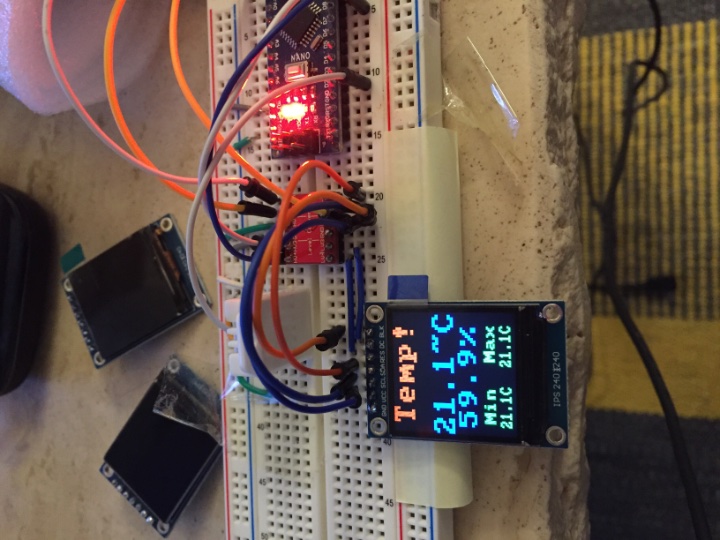

Phew - it still works :D
I was beginning to think I'd dreamed it.... It would be very interesting to know if any of the other displays work or not - it could just be my soldering technique really sucks and the board is getting a bit 'warm'.
I'd really like to test it with the ATTiny85 and my SPI (1.67MHz) - as the board should cope okay. Just don't have one that works at present :(
I've not had time (work pressures) - but I'd like to implement scrolling.
The code is as posted (just added a humidity printout) - and there are one or two problems - so testing would be good. Try all the functions and find what works and what doesn't. If we can work out why some boards (and the MM component) don't work then it's cracked. Simulation would be good too - and I'd need a lot of help with that.

Perhaps you could send me a working display. I can make another driver board.
Not sure why none of my other boards work - perhaps a bad batch?

The displays were from Banggood "1.3 Inch IPS TFT LCD Display 240*240 Color HD LCD Screen 3.3V ST7789 Driver Module", bought 11/2021.
From your pictures and description, I guess they are the same modules you have.
It is a pity that a half of them do not (yet) work... the rest are very nice and fast. 62.5 MHz SPI without a problem (the fastest SPI I have ever witnessed).

Yes - I got a couple of batches at about that time and some worked and some not - hence the above thread...
As a test - try running them using the Adafruit libraries and the Arduino IDE - if they work it's an initialisation problem (and I'd guess you'd be very unlucky to get 50 duff displays...)
If I remember - there were several variants described as Red, Black and Green tab?
