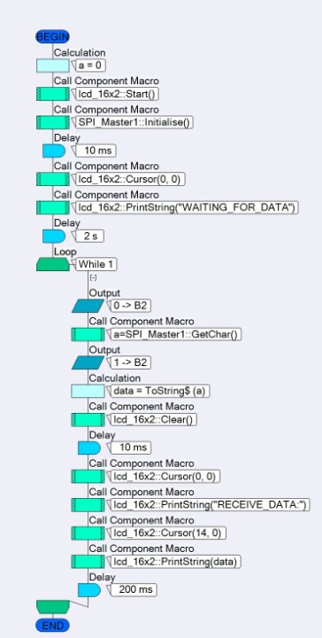

I was in my Evil Lab today and created a circuit in hardware with one uC acting as a Master and another uC acting as a Slave, based on the WiKi examples.
My charts however use PIC16F1939 as the uC, simply because they are already in my programmer boards.
The Master simply counts up and transmits the byte over SPI.
The Slave receives this byte and displays it on a LCD. It also transmits a character back to the Master.
I put my logic analyser on the wires and it clearly captures all activity.
I had to leave before finishing, so as I should be back in tomorrow I'll forward my charts and traces then.

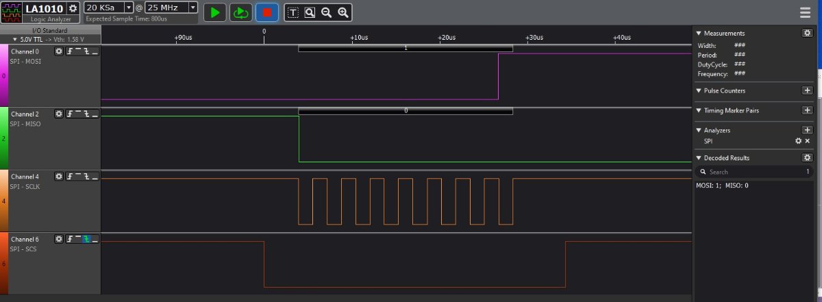

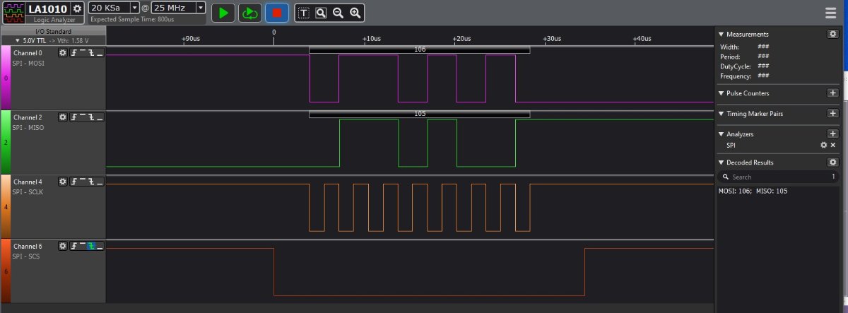

Based on the WiKi examples, but chips changed to PIC16F1939.
Created a Master chart which simply counts from 0-255 sending out the value on the SPI. At the Slave end it receives the value, displays it on the LCD and "echoes" the value back out on the SPI.
Logic analyser captures the traces.
You will see that although I'm echoing the received value back out, the value on the MISO line is one value below that received. This is because although the SPI is duplex, data is only clocked in/out under Master control. When the Slave receives a byte (e.g. 1) this is then passed to the buffer ready to be sent back to the Master. However transmission only takes places as the Master "clocks". The Master clocks data in and out so in the examples, the Master will receive the "echo" only when it clocks out the next value.
In the above examples the Slave has an interrupt set to trigger on SSP1, but not every chp has this feature (your intended targets do not).
In the next chart, we don't use the SSP interrupt, instead we interrupt on INT0 (falling edge) and this should also work on any interrupt pin. If you send this to hardware you will see that if you disconnect the SS/CS pin then the Slave count is suspended until reconnected.
As mentioned, the above have been tested on hardware so if they don't work on your Proteus then the problem may lie there.

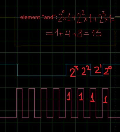

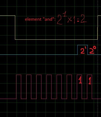

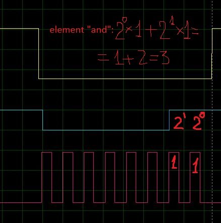

Good evening! Last night I dreamed about how to simplify the procedure for receiving byte numbers over the spi bus and end the hegemony of the flowcode program for receiving data .
The solution looks very simple, but to tell the truth, I haven't tried it yet. In general terms, the slave spi element looks like a logical "and" element. You remember that 1*0=0 and 1*1=1. Synchronization signals come to one input of this element -this is always a logical 1. Pulses come to the other input, the duration and shape of which correspond to ( 2^0 -means 2 to 0 degrees, 2^3-means 2 to 3 degrees = 8 and so on).
Next, we multiply these numbers in the controller and add them up - we get a byte number. It remains a small matter... how to do it? But this can already be done in any version of flowcode, there is arithmetic here. It will probably be more understandable from the drawings of the signals that appear when transmitting byte numbers over the spi bus.
- send 3.JPG (32.58 KiB) Viewed 2566223 times
- send 2.JPG (31.43 KiB) Viewed 2566223 times
- send 1.JPG (29.04 KiB) Viewed 2566223 times

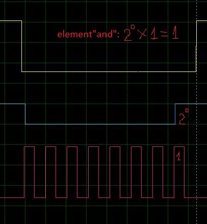

Continuation . It will probably be more understandable from the drawings of the signals that appear when transmitting byte numbers over the spi bus.

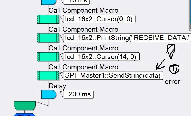

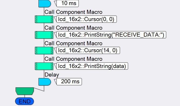

Re: some problems with spi data transmission

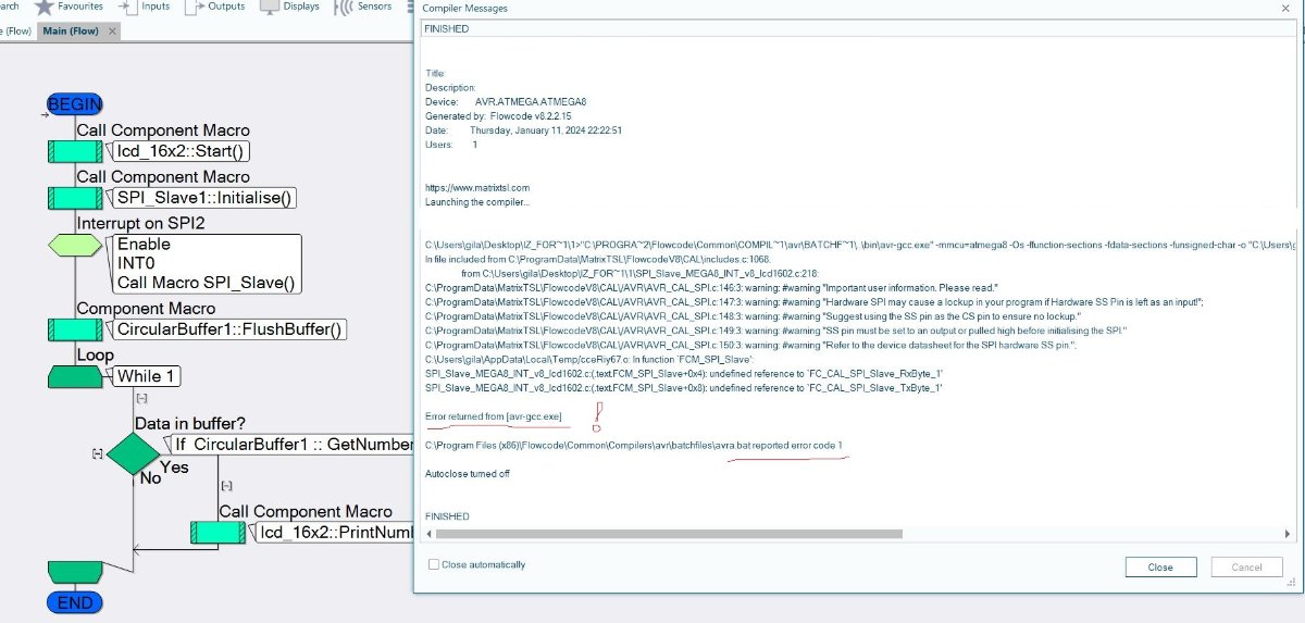

Good evening! I have some positive news. I found an error in the program that caused the receiving controller to send pulses. View in the attached file.
The second news. The receiving controller started showing the receiving number. Just not the right thing. I sent the number 6, and he writes that he accepts 0, 25, less often 85, and a couple of times the numbers 1 and 95. Moreover, it receives constantly, but I do not press the button to send data. On the schematic diagram, I tried two options-the terminals of the "CS" controllers are connected to each other and the output of the "CS" of the receiving controller is connected to the minus, and nothing comes from the output of the "CS" of the sending controller. The results of receiving the data have not changed.
- 1.jpg (38.26 KiB) Viewed 2564595 times
- Is that all right.JPG (53.25 KiB) Viewed 2564595 times
- error!.JPG (54.6 KiB) Viewed 2564595 times

I'm not sure why you seem to be trying to "reinvent the wheel".
In the above posts I provided an example of a Master sending out data, and two examples of Slaves receiving. One Slave used SSP (a feature not all chips have) and the other used an Interrupt. The interrupt example should work on any chip providing the pins are modified to suit. Your chip has inbuilt SPI capabilities so there really is no need to try and write your own.
Although written in v10 if it helps I can modify for v8?
SPI connections were as expected between the two chips in my examples, with the inclusion of an additional wire connecting the chip grounds.
Did you try the examples?

Good afternoon! I received and tried your examples, but they did not display very correctly on the 2d panel in the program. And there was also an element that I've never used and I don't know what it's "circularbuffer" for? and where do you get it in the flowcode program. Yes, you're right about "reinvent the wheel" and I've already started doing it. Remember in the last letter I wrote that the numbers 0.25.85 (mostly) began to appear on the screen of the receiving controller. I tried it today-I removed the transmitting controller and these numbers were also displayed. So this is a problem in the program of the receiving controller.
Now I'm going to try the atmega8 program that you sent on the forum.

gilanetugila
- Posts: 268
- Joined: Thu Jul 30, 2020 2:01 pm
- Has thanked: 7 times
- Been thanked: 1 time
Good evening! Yes, you are right to guess which pulse will be read, and which one cannot be missed, especially since it is assumed that the data will be displayed on the indicator, and there a delay of 100-200 ms is needed so that the inscription does not blink. I tried the program, installed my lcd 1602, but the program does not compile with the "slave spi" module, I send a screenshot from the screen. I've had this before when I tried to use this module.
- error.JPG (111 KiB) Viewed 2516489 times

I compiled to Hex and got different results. For me
SPI_Slave_MEGA8_INT_v8.c:(.text.FCM_SPI_Slave+0x2): undefined reference to `FC_CAL_SPI_Slave_RxByte_1'
SPI_Slave_MEGA8_INT_v8.c:(.text.FCM_SPI_Slave+0xc): undefined reference to `FC_CAL_SPI_Slave_TxByte_1'
seem to be the problem.
Not sure why though. I'll redo. My database is fully up to date is yours?

I started to create a chart from scratch, testing as I went (saving to Hex).
All went well until I used the SPI_GetChar component macro. This then failed to compile with
C:\Users\user\AppData\Local\Temp/ccftAoPc.o: In function `__vector_1':
v8_SPI.c:(.text.__vector_1+0x22): undefined reference to `FC_CAL_SPI_Slave_RxByte_1'

In the pervious chart I posted, the one using interrupt INT0 on the PIC1939, I changed the target to a Mega8, moved display to PortC and successfully compiled to Hex.
This suggests a possible issue with the v8 Slave Component. Unfortunately as v8 is a bit old now it may no longer be officially supported.
Have you thought on upgrading to v10? All components are free as are many chips.
