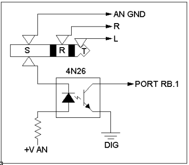

After a fast search on the web, i find that there are Jack sockets with 4 non switching contacts. If we insert a stereo jack, then the 3rd and 4th contacts are shorted to analog GND. We can use a 4N26 opto-transistor (or opto-isolator) to trigger a port of MCU when the jack plug inserted. See in schematic: The 4th contact is shorted to GND and the LED of opto is turned ON and the transistor is forward biased (is activated) so its collector drops to about 0V and triggers the port RB.1 as its internal weak pull-up is enabled (HI state). Thus the proccess of activating relays is executed by MCU. At the same time, analog and digital supply rails remain isolated thanks to the use of opto-transistor. I don't think that the LED of opto can load with noise the headphones output, LEDs in general are quite devices.
- HEADPHONE INSERT small.jpg (30.4 KiB) Viewed 22862 times
Best Regards FOTIS ANAGNOSTOU

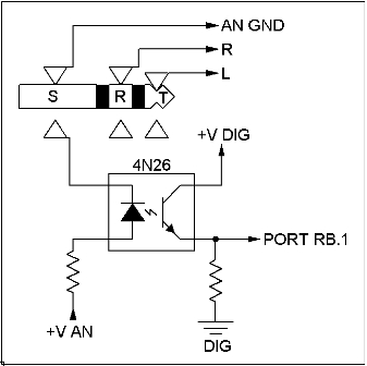

Phil, unfortunatelly the only 6.35mm sockets that i could find offer up to 3 contacts. So the plan should be modified. See in the new schematic: the Jack socket is from those with 3 switched contacts. When the plug inserted, disconnects all contacts. As long as the LED is ON and the transistor active, the voltage drop accross the resistor connected between its emitter and GND keeps the Port RB.1 in HI state. When a plug inserted the first contact that disconnected is this of LED to GND by turning it OFF. So the transistor is also turned OFF. Now the emitter voltage drops to zero and consequently triggers the Port RB.1
- HEADPHONE INSERT.jpg (32.75 KiB) Viewed 22862 times

I see what you've done by using an opto isolator, that's a neat idea that you have thought up. That should deffinetly isolate the analog and digital supplies so that there is no noise or interferance.
Phil
Phil

Yes Phil. That is exactly what bothers me, the isolation of digital and analog supply GND rails. Here is the type of socket that suits in this circuitry.philip davies wrote:Hi Fotis,
Phil

That's the exact type of socket I was thinking of. What would happen if we were to use an opto-isolator to drive a small circuit that will in turn switch on a relay. This circuit will be running off the analog power supply. We could use another transistor to adjust the voltage to suit the voltage rating of the relay coil. If the analog supply is +15 0 -15 then this relay and the extra circuit would probably need to be connected across the +15 -15 volt rails because if it were connected to the +15 and 0v rails then there might be small clicks audible in the headphones or speakers when the relay discharges through the GND/0v rail. The relay contacts could then be connected to the MCU.
I don't know if this idea will work but i thought I would share it with you. Let me know what you think.
Phil

Sorry Phil but i think my approach is better than yoursphilip davies wrote:Hi Fotis,
Phil
Whoa, okay, that's enough! Let's take a look at the BOM. I wait to receive 20 OMRON simple (Non Latching) relays, to be competible with you. Their coils are of 5Vdc. I need a power relay with 5Vdc coil and a good encapsulated PCB mounted transformer with 9 to 12Vac secondary at 0.8 - 1A or 10VA. Don't forget how many relays, LEDs, could be active simultaneously. We will also build our own remote control handset with 8 to 10 buttons. We need a comfortable plastic case. I found some in Farnell and some in Mouser. I will show you. I think is better to make some buys together, how much P&P charges Farnell inside UK?
Mouser from US for orders from 75 Euro and above, does not charges P&P. Make an experiment by placing some goods on basket, the P&P is shown automatically on the sum. Here is a link of nice boxes for remote control use. I like them very much: http://gr.mouser.com/Search/ProductDeta ... 46-1553AGY
