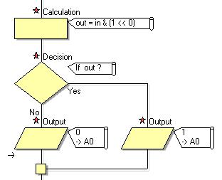

Re: Received UART characters to strings
Hi Chris,
Here are two examples using an input icon in single pin mode and a switch component.
And then recombining at the receiver
