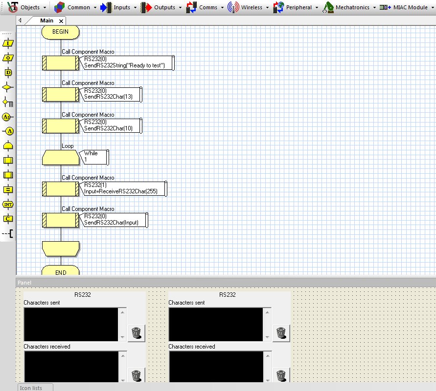

My code requires that I use two RS232 communication ports, I had written an extensive flowcode chart but when attempting to compile I received errors relating to the use of both ports, I then created a simple flowcode chart to test the use of using two communications ports together, I would like to add that my project will require one RS232 port to run at 19200 baud and the other RS232 port to run at 9600 baud.
The simple test flowcode chart:
(216.29 KiB) Downloaded 1587 times

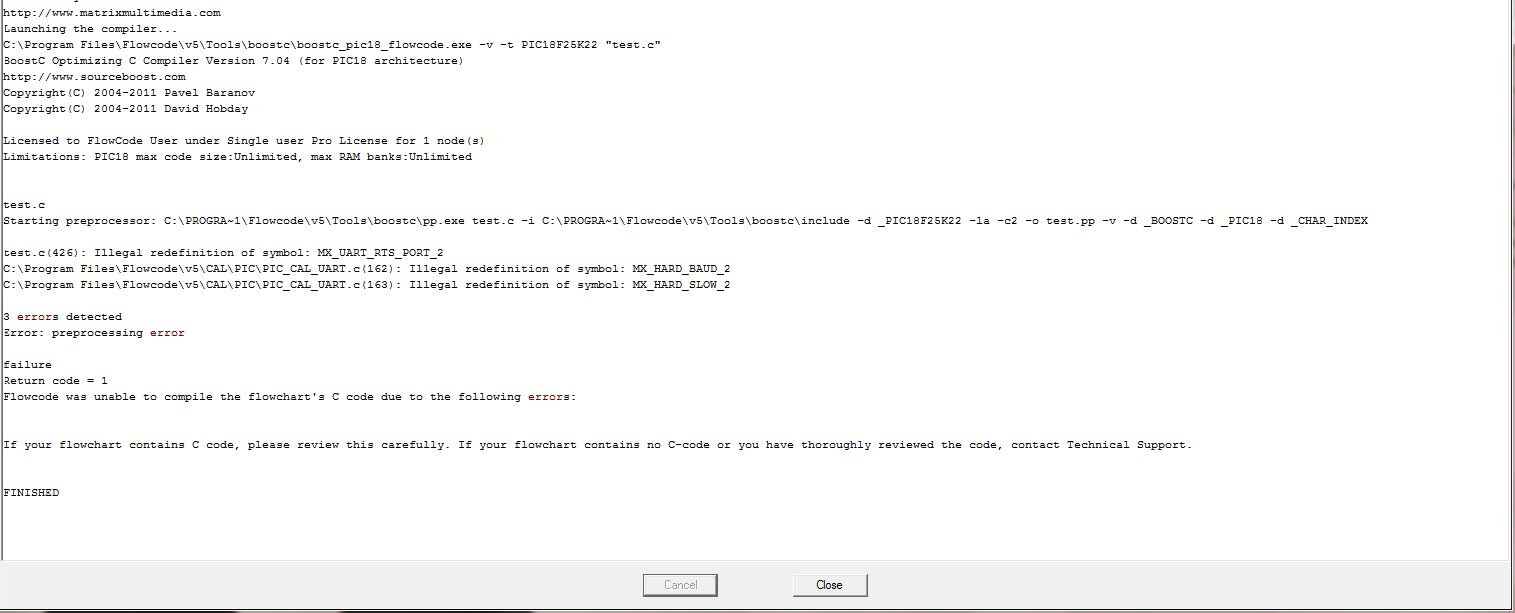

However in my tests I have compiled with both ports at 19200 Baud on test one and get 1 error reported on the compile which is:
test.c(426): Illegal redefinition of symbol: MX_UART_RTS_PORT_2

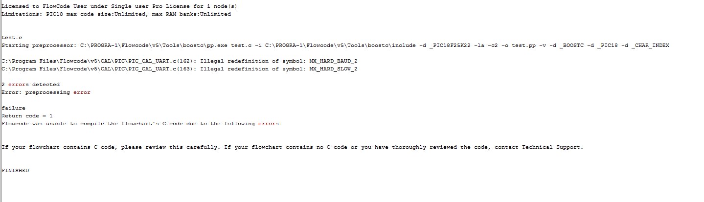

But if I change to 19200 Baud on port 1 and 9600 Baud on port 2 I then get the following errors reported on the compile which are as follows:
C:\Program Files\Flowcode\v5\CAL\PIC\PIC_CAL_UART.c(162): Illegal redefinition of symbol: MX_HARD_BAUD_2
C:\Program Files\Flowcode\v5\CAL\PIC\PIC_CAL_UART.c(163): Illegal redefinition of symbol: MX_HARD_SLOW_2
(82.11 KiB) Downloaded 1587 times

Hello. We are putting together an updated patch at this point (v5.1) which fixes several UART issues. We hope to include this fix in here.
In the meantime, looking at your issue, I think this patch might help.
PIC_CAL_UART.c
Patched UART file
(20.13 KiB) Downloaded 370 times
Please let us know if this fixes your problem as although we can test these things in the lab we can not replicate your setup exactly.

dazz wrote:Hi
does this thread help http://www.matrixmultimedia.com/mmforum ... 47&t=10122
Many thanks - I somehow missed this update and it fixed the one problem but I'm still left with the two errors...
(50.08 KiB) Downloaded 1575 times

Hi Jonny,
Yes many thanks, this has now fixed the other two errors, I have compiled and it looks good now, and will test soon...
I hope this is ok with the above patch installed - its looks good...
Thanks again Guys for such a great responce, Looks like I can now move forward again with the project.
Kind regards
Aj
