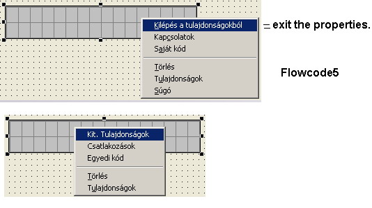

Re: Patch upgrade from v5.0 to 5.1
Thank you for your help, it works!
Small translation problem, attached image.
