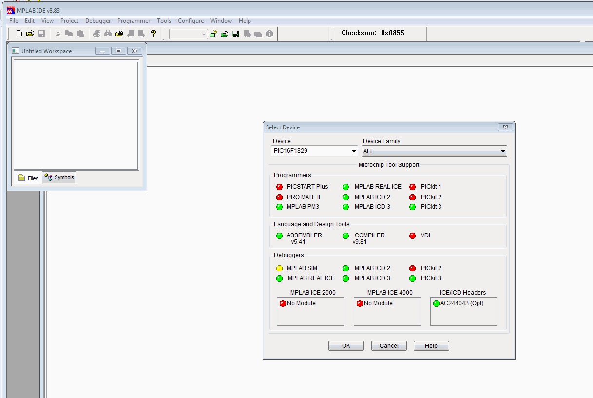

thanks jonny for the promp responce on that, i think your on to something, when i opened mplad to check support on this device it had all yellow and red icons, on all the other chips i had green and red, looks like i would have to update mplab or pickit2, im probably not gonna deal with that chip, the last time i tried to update mplab it messed with fc5 for some reason... yellow means beta only, i'll reduce the size on my original fc file to fit on the 16f690

Hello brandonb
The MPLAB say`s if i want use these chip........no support
Pickcit3 , I self work with these from China(less in the price)
http://www.ebay.de/sch/i.html?_from=R40 ... Categories
Regards Wolfgang
- (35.54 KiB) Downloaded 1822 times

thanks, curious, what would i have to do to get a pickit3 working with flowcode? does flowcode access the setting in mplab or in the pickit directly for programming, i would rather be limited to chips that i use rather than having to change flowcode settings everytime i program, i'll probably just stick with in the 20 pin range to using the 16f690 instead of the 16f1829 all though the features are better
Re: 16f1829 dont work
Hello Brandon,
You can integrate the PICkit 3 into Flowcode the same as you can with the PICkit 2.
http://www.matrixmultimedia.com/support ... f=22&t=565
