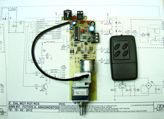

Of course, there are lot of similar projects offered on the market either as pre assembled units or as kits. Here we have our own that obtained with the use of Flow Code v5.
The unit is remotely controllable thru the use of RC-5 protocol. A ready RC-5 component is offered by the new versions of Flow Code, so there is no need to build a MACRO for it. Just drag and drop the Flow Code RC-5 compo on control panel and configure it thru its properties window. It is so simple! A brief description of unit: It offers the VOL+ and VOL- functions plus STBY and MUTE.
The micro is programmed to communicate with any RC5 compatible remote control handset. Each handset transmits a unique address code, e.g. TV address = 0 and Preamplifier address = 16. To initialize the micro for communication with a remote handset, turn off power supply then turn it on again. The red LED mounted on PCB immediately starts to blink fast for 10 times. Within this time, press firmly the button mounted on PCB until LED stops to blink and remains constantly glowing. Release the button. Now, within 3 seconds, press firmly a button (MUTE is preferred) on remote control handset. If its address code has been stored successfully into micro, the LED blinks slowly 6 times. If we don’t press any button on remote control handset then the TV address code = 0 is automatically stored into micro and the LED does not lit. If the remote control is incompatible with RC-5, the LED starts to blink fast for 10 times and the TV address = 0 is automaticaly stored into micro. That is all. The internal EEPROM of micro retains constantly the address code.
Some details about the microcontroller and program code: I did use of everything I had in my stock and so a PIC16F88. This micro includes an internal oscillator module that is very accurate for the given project so there is no need of use an external XTAL. In higher level PICs - like P16F88X - if we don’t configure their internal oscillator it is automatically placed at 4MHz. In P16F88 the INTOSC module should be configured thru OSCCON register or else will not work. That is the reason of the C-code command “osccon = 0x6C;” (INTOSC = 4MHz) in the beginning of Flow chart. The other command “osctune = 0x00;” maybe is redundant, but in P16F88 datasheet is referred that it places the oscillator in its center frequency. The 2nd C-code command “option_reg.NOT_RBPU = 0;” enables the internal weak pull-ups connected at pins RB.0-RB.7 of Port B. This eliminates the need of use external pull-up resistors.
In configuration screen you can see that I have disabled the BOR reset. I did it for two reasons: 1) PIC16F88 offers just one level for BOR, 4Vdc. 2) The motor of ALPS potentiometer consumes enough current (100 to 150mA) during its rotation and so it can cause a sufficient voltage drop to trigger without reason the BOR reset of micro. Higher level PICs offer two - selectable - BOR levels, 4V and 2.1V. It should be noted that, according to Microchip, when both POR and BOR are enabled the MCLR is usually redundant. In the current project, an external MCLR (reset) circuit is used. You can play with different RESET configurations; for me that was a luxury because i had to send the project for test.
In the picture you can see that I have connected the IR receiver with a screened cable of 20cm to the PCB. That offers flexibility in the mounting of IR receiver. I haven't noticed any interference or signal loss issue.

Here some additional information regarding “Power On / Stand By” and “MUTE” functions.
Inside the program code their operation is predicted either remotely or manually thru two push switches mounted on the PCB. Everything that is needed to upgrade your old preamplifier from manually in remotely controlled is included in program code and in hardware. There are ready outputs from PCB to connect one Power relay for activating the power transformer of analog supply, and one Signal relay for mute the outputs. When mains power is applied to preamplifier, instantly the MUTE relay is activated and mutes the main outputs. Power relay remains OFF and waits for a signal. When Power switch is pressed, the Power relay is activated and the analog section transformer is powered. After few seconds the MUTE relay is deactivated and the device is ready to play music. When “Power On / Stand By” switch pressed to put the device in Stand By mode, firstly the MUTE relay is activated and then the Power relay deactivated. In this way, thumbs and pop noises caused during analog power supply stabilization are not audible.
Attached is the PCB drawing in pdf and in 1:1 scale ready for printing in artwork film for people able to make PCBs at home. The silkscreen is also attached. The PCB is a very simple single sided and its size is 143 X 44 mm. It can be splitted in two parts, one for mounting the motorized potentiometer and one for the control circuit.
PCBs offerd under request. Please contact with me using my direct e-mail address for informations.

Hi guys
Thank you so much for the assistance and sorry for the delayed reply. I am busy with a... single ended monoblock tube amplifier that i build for a friend - customer. What an experience! Gold, silver, oxygen free copper, tantalum resistors, mylar in oil foil capacitors, teflon... Wow!
Regarding remotely controlled mot pot:
1) Indeed LK are simple wire links, you can use spare leads from e.g. resistors. I use "0R resistors" just... for beauty!
2) Tactile switch is this exactly: http://export.farnell.com/te-connectivi ... tt=1555983
It is the most commonly used, you can use any alternative.
3) You can use any micro with 18pin lead count so that can fit in the 18pin IC DIL socket. The micro also must have internal oscillator module. In the initial project i used P16F88 because i had in stock, now i use a P16F819 that is less expensive, the program is the same simply the configuration settings are changed. I have stored the code for the 16F819 somewhere in my HDD, i have to search for it to upload the HEX code.

Sorry if I may sound picky, but I found virtually all the components to finish the project and now I just realized that I miss an information about capacitor types: so I'm here again for your appreciated suggestions...
There are only 7 capacitors in the project:
clearly C3 (1000µF 16V) and C5 (100µF 16V) are electrolytic ones.
C1, C4, C6 have the same value in schematics (100nF), but in the uploaded pic I can see that they do not seem identical and then I'm a bit confused.
Is C1 only a different type (please, which type?), but with the same capacitance, compared to C4 and C6?
Also, which is the type of the 4 red capacitors in the pic (polypropylene, or ceramic, or...)?
Every pointing will be most appreciated.
Thank you very much in advance: I'm learning a lot here, not only about PIC programming!

- C1, C4, C6
- capacitors.jpg (29.26 KiB) Viewed 55308 times

Hi logon
C1 is the commonly used 100nF multilayer ceramic capacitor for decoupling accross the supply rails of each logic IC.
All rest caps are common MKT (polyester foil) rated at 50V-100V. These used in my project are Philips (those i had in my stock) you can use any brand e.g. ARCOTRONICS (made in Italy).
All capacitors are inexpensive, please don't spend money for polypropylene caps.

Here a WIMA Polyester (PET) 100nF: http://it.farnell.com/wima/mks2c031001a ... tt=1890134
Here a WIMA Polyester (PET) 220nF: http://it.farnell.com/wima/mks2c032201b ... tt=1890135
Here a multilayer ceramic capacitor for C1: http://it.farnell.com/multicomp/mcrr501 ... tt=1216445
Best Regards FOTIS ANAGNOSTOU
